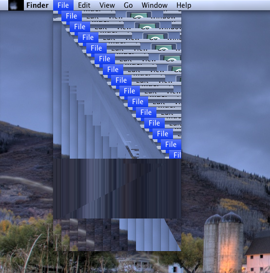

christypop Posted February 9, 2008 Author Share Posted February 9, 2008 As suggested by a coworker, I used the Punk92 NVidia installer. I added my device ID to the NVinject.kext. Didn't work, but it broke my GMA950 graphics though. It makes contextual menus go crazy, and turned previously working screen savers into blocks. Check this out. Link to comment https://www.insanelymac.com/forum/topic/86459-help-kernel-panic-on-boot-with-pny-7300gt-256-nvinject-and-natit/#findComment-615595 Share on other sites More sharing options...

christypop Posted February 10, 2008 Author Share Posted February 10, 2008 As suggested by a coworker, I used the Punk92 NVidia installer. I added my device ID to the NVinject.kext. Didn't work, but it broke my GMA950 graphics though. It makes contextual menus go crazy, and turned previously working screen savers into blocks. Check this out. I was able to fix this by using Pacifist to replace the original OpenGL framework in /System/Library/Frameworks with the original iAtkos disk version. This was really difficult without being able to see any menus. I highly recommend caution before using the Punk92 installers as it requires replacing your current OpenGL framework. So back to square one. At least I can use my GMA950 right now. Link to comment https://www.insanelymac.com/forum/topic/86459-help-kernel-panic-on-boot-with-pny-7300gt-256-nvinject-and-natit/#findComment-615947 Share on other sites More sharing options...
