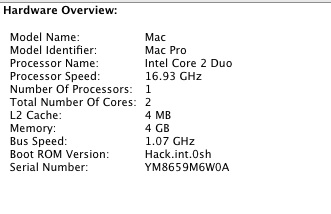

mdg Posted December 25, 2007 Share Posted December 25, 2007 I have and Asus P5K Wifi Deluxe with an Intel Core 2 Duo E6420 (stock speed of 2.13) I have it OC'd to 3.2 Ghz (400x8). Works like a champ at 1.3625 volts and 4-4-4-12 ram timings. I get this strange info, however...any help/thoughts (see attached)? Thanks, /mdg. Link to comment Share on other sites More sharing options...

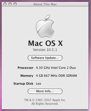

Shadowline Posted December 25, 2007 Share Posted December 25, 2007 I like the first one better. 16.93 ghz? wish i could overclock that well! This is quite strange though. as I can't get anything to show up for my cpu other than that it is running all 4 cores... Link to comment Share on other sites More sharing options...
subzero1266 Posted December 28, 2007 Share Posted December 28, 2007 at darwin boot options, boot with fsb=(actual cpu fsb)/4 eg: fsb=333 when ur cpu fsb is 1333Mhz if ur computer reports correct speed after u boot, then change it permanently in boot.plist under kernel flags. Link to comment Share on other sites More sharing options...
mdg Posted December 28, 2007 Author Share Posted December 28, 2007 at darwin boot options, boot with fsb=(actual cpu fsb)/4 eg: fsb=333 when ur cpu fsb is 1333Mhz if ur computer reports correct speed after u boot, then change it permanently in boot.plist under kernel flags. I tried fsb=266 but the results were the same (still above info). I am OC'ing, but I've never had problems getting the right information while OC'ing other motherboards.... /mdg. Link to comment Share on other sites More sharing options...

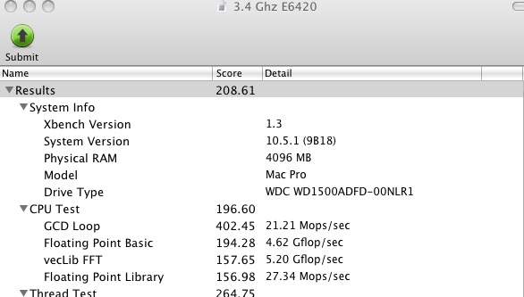

mdg Posted December 28, 2007 Author Share Posted December 28, 2007 Is it really such a big thing to see this false info here? Is it worth the work to patsch plists and kexts just for having the correct info in the "about" dialog? If its is running with the correct speed (and you can check that with some benchmarks if you feel it is running not as supposed) its relly irrelevant what is displayed.Just my two cents... No big deal at all, to your point, just interesting and I wonder why? I just tried bumping up the OC to 3.4 Ghz, and the info showed is still exactly the same...no changes. The machine is running well on the E6420 @ 3.4 Ghz...I get an Xbench of (see below): EDIT: I've been running stable at 3.33 @ 1.35V with no difference in performance from 3.4 but at less power, so I now have it running at 3.33 Mghz...About this mac and System Profiler still say the same thing, however... Link to comment Share on other sites More sharing options...

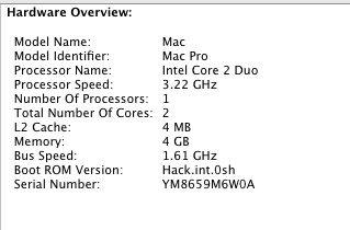

mdg Posted January 14, 2008 Author Share Posted January 14, 2008 be happy, we dont have cpus running that fast UPDATE: Got it fixed by updating the BIOS. Now how do I fix the rest...has anyone been able to get the "Processor Features" to come up under Kalyway 10.5.1. We had these in 10.4.x Thanks, /mdg. Link to comment Share on other sites More sharing options...
wlfdgcrkz Posted February 4, 2008 Share Posted February 4, 2008 Similar board same issue. p5k-e wifi E6750 overclocked to 3.37GHz according to bios system profiles claims 16.93GHz (wow) Machine Name: Mac Machine Model: Mac Pro Processor Name: Intel® Core2 Duo CPU E6750 @ Processor Speed: 16.93 GHz Total Number Of Cores: 2 L2 Cache (per processor): 4 MB Processor Features: FPU VME DE PSE TSC MSR PAE MCE CX8 APIC SEP MTRR PGE MCA CMOV PAT PSE36 CLFSH DS ACPI MMX FXSR SSE SSE2 SS HTT TM SSE3 MON DSCPL VMX SMX EST TM2 SSSE3 CX16 TPR PDCM Memory: 4 GB Bus Speed: 1.33 GHz Boot ROM Version: Hack.88Z.int.0sh.061193037 (American Megatrends Inc.) What in bios did you do? Link to comment Share on other sites More sharing options...
