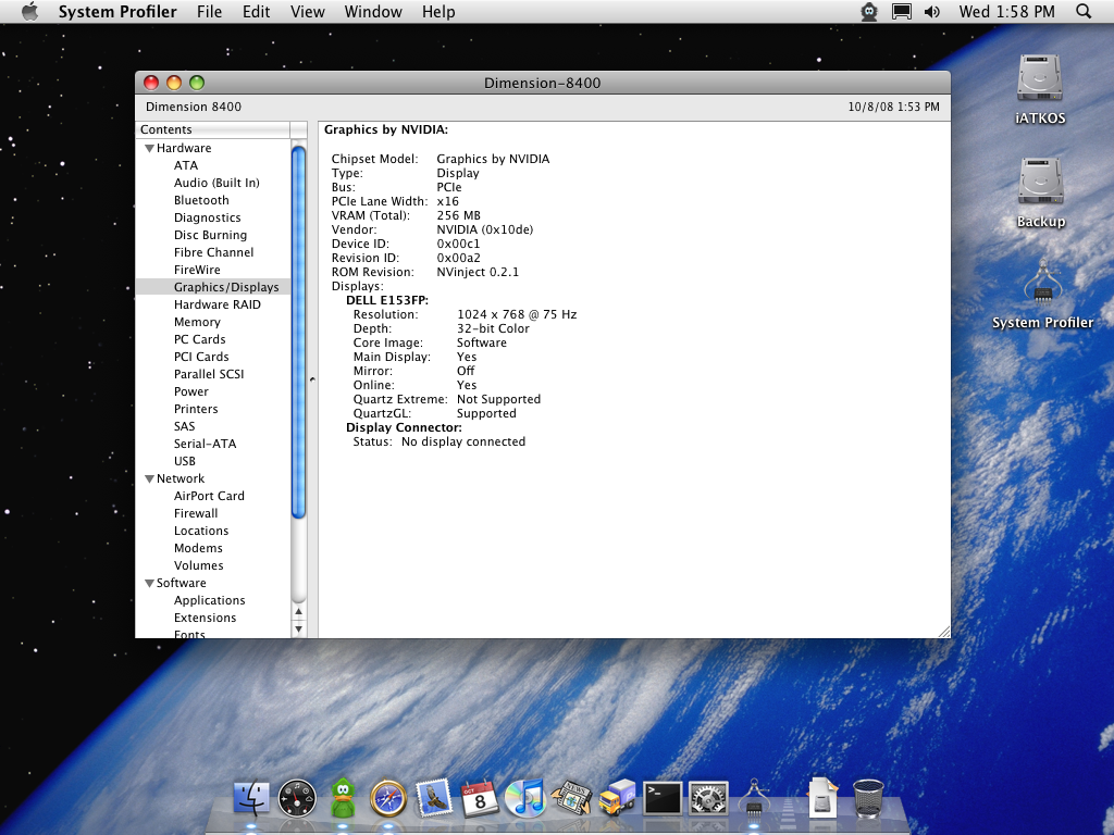

JustForKix Posted December 7, 2007 Share Posted December 7, 2007 I successfully installed Leopard on the following system using the ToH DVD. Dell Dimension 8400: P4 3.2Ghz, 1GB RAM, 120GB hard drive, Nvidia 6800 (the dell version) After installing I had the screen stuck at 1024x768 and could not change resolution and had no QE/CI support. Here are the steps I followed and now I have a fully supported system with QE/CI. (1) Get your device and vendor ID from the System profiler My device ID is 00c1 and vendor ID is 10de Note this down as 0x00c110de : 0xdeviceIDvendorID (2) Edit the following files located in System/Library/Extensions and make the changes as needed. GeForce.kext sudo nano /System/Library/Extensions/GeForce.kext/Contents/Info.plist In this file locate the following text <key>IOPCIMatch</key> <string>0x000010de&0x0000ffff</string> Replace the <string>0x000010de&0x0000ffff</string> with <string>0xdeviceIDvendorID<string> Do the same thing for the NVDANV40Hal.kext and NVDAResman.kext files. (3) Download NVinject from here http://nvinject.free.fr/downloads.php Follow these steps to get NVinject installed (obtained from the Nvinject forums) Here is how you need to proceed to install NVinject (it also applies to any other extension .kext file) : 1- Copy NVinject.kext in a folder you can access easily 2- Open Terminal.app (in /Applications/Utilities/Terminal.app) 3- type : sudo su which will ask for your Admin password to open a Super User Terminal session. 4- CD to the directory where you place NVinject.kext, here we placed it in "install" folder on Desktop for user gotoh : cd /users/gotoh/desktop/install/ 5- set correct ownership for file recursively (extensions are file containers) : chown -R 0:0 NVinject.kext This sets file ownership to "root" user, "wheel" group 6- set correct permissions to file recursively : chmod -R 755 NVinject.kext 7- now move the file to extensions directory : mv NVinject.kext /System/Library/Extensions/NVinject.kext 8- you should now remove extensions and kernel caches before rebooting : rm -rf /System/Library/Extensions.mkext rm -rf /System/Library/Extensions/Caches/ rm -rf /System/Library/Caches/ 9- you can now leave the Super User Terminal session : exit Reboot and enjoy Leopard in its full glory! Link to comment https://www.insanelymac.com/forum/topic/75246-how-to-get-your-nvidia-card-working-in-leopard/ Share on other sites More sharing options...

ThinKing Posted May 31, 2008 Share Posted May 31, 2008 I successfully installed Leopard on the following system using the ToH DVD. Dell Dimension 8400: P4 3.2Ghz, 1GB RAM, 120GB hard drive, Nvidia 6800 (the dell version) After installing I had the screen stuck at 1024x768 and could not change resolution and had no QE/CI support. Here are the steps I followed and now I have a fully supported system with QE/CI. (1) Get your device and vendor ID from the System profiler My device ID is 00c1 and vendor ID is 10de Note this down as 0x00c110de : 0xdeviceIDvendorID (2) Edit the following files located in System/Library/Extensions and make the changes as needed. GeForce.kext sudo nano /System/Library/Extensions/GeForce.kext/Contents/Info.plist In this file locate the following text <key>IOPCIMatch</key> <string>0x000010de&0x0000ffff</string> Replace the <string>0x000010de&0x0000ffff</string> with <string>0xdeviceIDvendorID<string> Do the same thing for the NVDANV40Hal.kext and NVDAResman.kext files. (3) Download NVinject from here http://nvinject.free.fr/downloads.php Follow these steps to get NVinject installed (obtained from the Nvinject forums) Here is how you need to proceed to install NVinject (it also applies to any other extension .kext file) : 1- Copy NVinject.kext in a folder you can access easily 2- Open Terminal.app (in /Applications/Utilities/Terminal.app) 3- type : sudo su which will ask for your Admin password to open a Super User Terminal session. 4- CD to the directory where you place NVinject.kext, here we placed it in "install" folder on Desktop for user gotoh : cd /users/gotoh/desktop/install/ 5- set correct ownership for file recursively (extensions are file containers) : chown -R 0:0 NVinject.kext This sets file ownership to "root" user, "wheel" group 6- set correct permissions to file recursively : chmod -R 755 NVinject.kext 7- now move the file to extensions directory : mv NVinject.kext /System/Library/Extensions/NVinject.kext 8- you should now remove extensions and kernel caches before rebooting : rm -rf /System/Library/Extensions.mkext rm -rf /System/Library/Extensions/Caches/ rm -rf /System/Library/Caches/ 9- you can now leave the Super User Terminal session : exit Reboot and enjoy Leopard in its full glory! I have the same video card with the same device ID and vendor ID, Nvidia GeForce 6800. I have done exactly as JustForKix said and now my OS is unusable. It tells me in several languages to press the power button. I tried to fix it because I had a very low resolution, and I have a 24'' LCD monitor with 1920x1200 native resolution. It would be great if someone would help me set a resolution like that. My Mac OS is installed from Kalyway_10.5.2_DVD_Intel_Amd.iso. Link to comment https://www.insanelymac.com/forum/topic/75246-how-to-get-your-nvidia-card-working-in-leopard/#findComment-765081 Share on other sites More sharing options...

Rui Lima Posted September 27, 2008 Share Posted September 27, 2008 I can't find <key>IOPCIMatch</key> string in /System/Library/Extensions/NVDANV40Hal.kext/Contents/Info.plist. Should I add it? My card is a PCI GeForce 6800 GS. Link to comment https://www.insanelymac.com/forum/topic/75246-how-to-get-your-nvidia-card-working-in-leopard/#findComment-908306 Share on other sites More sharing options...
qwertyuiop Posted October 8, 2008 Share Posted October 8, 2008 I have almost the same exact specs, and i followed the guide exactly. But when i reboot i can change the resolution but QE/CI isn't enabled. (btw I'm using NVinject 0.2.1). Link to comment https://www.insanelymac.com/forum/topic/75246-how-to-get-your-nvidia-card-working-in-leopard/#findComment-922677 Share on other sites More sharing options...
qwertyuiop Posted October 10, 2008 Share Posted October 10, 2008 nevermind, i got it to work by setting the ioprobescore to 0 in the nvinject kext. Link to comment https://www.insanelymac.com/forum/topic/75246-how-to-get-your-nvidia-card-working-in-leopard/#findComment-925000 Share on other sites More sharing options...
