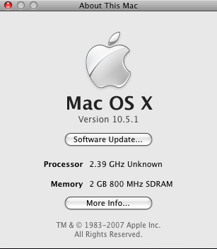

weaksauce12 Posted December 9, 2007 Author Share Posted December 9, 2007 ... amazing. I'm more than jealous... I'm in the process of making a frankintosh, but nothing compared to this beast.I had a Santa Rosa-based MacBook Pro as well as an older Mini. Since I don't require portability anymore, I sold the MBP for a decent price and decided to build this. Originally I wanted to upgrade my Mini (I'm big into upgrading Minis), but the 2.33ghz T7600 processor is still almost $700 everywhere, so I looked at Mac Pros. Too bad the Mac Pros start at $2,500 standard; even if you cut down the config it only goes to $2,200. Enter the Hackintosh - $1300 and it's even better than the $5,000 configuration! Haha. I got a good price on an 8800 GTS used, so I'm going to recycle the 7300 & 7900 into a couple other Hackintosh projects (7300 in a Gigabyte/C2D build I'm doing this week). This stuff is so great...my machine is absolutely flawless. Zero problems. Nothing. Nada. Zilch. I couldn't be happier! I just tested OS X's Software RAID using two WD 500gb 7200rpm SATA drives. Mirroring seems very slow...I copied over my XP VM and launched it, the first time it froze up my entire system and the second time it just went dog slow and hardly responded to my mouse clicks. Although it was fine copying stuff over. I just set them up in a Striped and it's much faster. I would say 99% as fast as the primary boot disks...it seems just a tiny tad itty bit slow when running the VM, hardly noticeable, and it seems to go full speed once you get into it. I'd say if you want to use Mirroring, just use it for file storage/backup/Time Machine rather than actually running stuff off of like a VMware virtual machine. Just from my quickie test. It seems like the only thing that doesn't work with Hackintosh is Boot Camp. However, since you're on an actual PC you can just dual boot or install XP/Vista on a separate drive and boot from there by choosing the drive in the BIOS. I'm not sure if you could read a "real" partition using a VM app like Fusion or Parallels though, which may be an issue if you want to do virtual plus dual boot. There are some NTFS readers like MacFuse or Paragon's software. I'm also trying to figure out the best way to clone the internal boot drive. I like the concept of Time Machine, but if my boot drive bites the dust I don't want to have to sit there and install Leopard/Brazil for like 2 hours again, then restore the Time Machine backup. I wonder if CarbonCopyCloner could restore a file clone using Kalyway or something... Link to comment https://www.insanelymac.com/forum/topic/73542-help-me-build-a-quad-core-hackintosh/page/2/#findComment-533541 Share on other sites More sharing options...

msantoso Posted January 3, 2008 Share Posted January 3, 2008 how to make Quad Core Q6600 recognised in leopard? i saw the screenshot from BJMoose recognised as Intel Core TM 2 Quad but it's 2.66GHz and saw a few others also recognised thanks Link to comment https://www.insanelymac.com/forum/topic/73542-help-me-build-a-quad-core-hackintosh/page/2/#findComment-563684 Share on other sites More sharing options...
karaakeha1 Posted January 3, 2008 Share Posted January 3, 2008 how to make Quad Core Q6600 recognised in leopard? i saw the screenshot from BJMoose recognised as Intel Core TM 2 Quad but it's 2.66GHz and saw a few others also recognised thanks Its not recognized by defaut in about this mac , he edited some file you can see in his post But iATKOS install this is recognized in System profiler Link to comment https://www.insanelymac.com/forum/topic/73542-help-me-build-a-quad-core-hackintosh/page/2/#findComment-563713 Share on other sites More sharing options...
