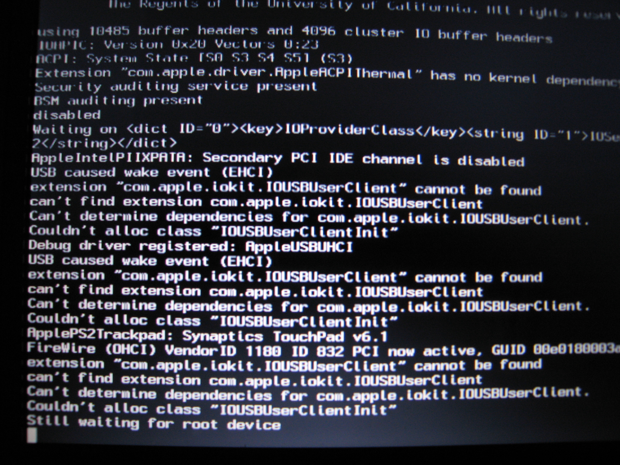

antaholics Posted November 25, 2007 Author Share Posted November 25, 2007 When the system is booting up from the DVD it says something about dsmos.kext being not authentic I realized that when I tried to use ./startupfiletool again it says something about resource busy.... so I'm not really sure if the efi was installed correctly or not. my dsmos.kext is in the right folder... /System/Library/Extensions/.HIDDEN/dsmos.kext I'm not really sure what went wrong actually... but all I really know is that now when I boot up from HD, it says "Loading MKext Cache from /Systems/Library/Extensions.mkext ..."then it reboots. It never actually loads the kexts... *confused* I did ./startupfiletool again... and it helped to be more awake when I was doing it Now when I boot up I get stuck at "using 10485..." I'm going to boot up the GUI from the DVD to try and redo the com.apple.boot.plist and replace kexts again hope it works this time Ant Edit: I checked com.apple.boot.plist and nothing was wrong... so I started up with the DVD and replaced AppleACPIPlatform.kext and AppleAPIC.kext, did makemkext and reboot. dsmos.kext doesn't load (not authentic) and now I am stuck at the same place that everyone else is stuck on... bad system call.. etc. It keeps retrying until reboot. Link to comment https://www.insanelymac.com/forum/topic/70928-the-official-asus-f3-series-notebook-thread/page/4/#findComment-518047 Share on other sites More sharing options...
Alguno Posted November 25, 2007 Share Posted November 25, 2007 launchd: /System/Library/CoreServices/loginwindow.app/Contents/MacOS/loginwindow port /dev/console exited abnormally: Bad system call and some lines up i can read.. launchd: Server 0 in bootstrap 1103 uid 0: "usr/sbin/coreaudiod"[175]: exited with status: 69 After installing the 10.4.11 update and PC EFI (including the dsmos.kext) I also receive this error when the dsmos.kext isn't loaded. But the problem is that as soon as I try to load the dsmos.kext I receive a kernel panic (Unresolved kernel trap). I'm using the grub-version of PC EFI 6.0. With PC EFI 6.0 the dsmos.kext isn't bundled, so I installed the one which is bundled with PC EFI 5.0 but as already said, I receive a kernel panic with that one. Link to comment https://www.insanelymac.com/forum/topic/70928-the-official-asus-f3-series-notebook-thread/page/4/#findComment-518238 Share on other sites More sharing options...

antaholics Posted November 26, 2007 Author Share Posted November 26, 2007 Update: I read somewhere that you have to repair permissions on dsmos.kext so it will load... so I got on single user mode (-s) and typed: chown -R root:wheel /System/Library/Extensions/.HIDDEN/dsmos.kext chmod -R 755 /System/Library/Extensions/.HIDDEN/dsmos.kext and now dsmos.kext loads! However, I got a kernel panic I would love to show a screenshot but Vista is uncooperative and refuses to read my SD cards... :@ Link to comment https://www.insanelymac.com/forum/topic/70928-the-official-asus-f3-series-notebook-thread/page/4/#findComment-518719 Share on other sites More sharing options...
AlexIT Posted November 26, 2007 Share Posted November 26, 2007 However, I got a kernel panic Use my last makemkext to make the Extensions.mkext cache. Did you add the row in /etc/rc about "kextload dsmos.kext" ? Don't use dsmos.kext for LEOPARD ... but the old one for tiger (see attachment). I advice you to use PCefi5 , i'm having some problems with PCefi6, and if you wanna try to inject some values into EFI (nvram , layout-id), use ALCinject/NVinject instead: v6 do the very-same job but with fixed values. Link to comment https://www.insanelymac.com/forum/topic/70928-the-official-asus-f3-series-notebook-thread/page/4/#findComment-518867 Share on other sites More sharing options...

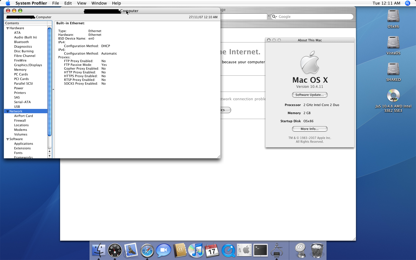

AlexIT Posted November 26, 2007 Share Posted November 26, 2007 Ah, I guess that was the problem. This dsmos.kext which you attached to your post works great! I can now boot back into the graphical environment using EFI + 10.4.11. Too bad the wireless NIC and the onboard NIC don't work yet... Nice, now wait for Ant and Ciufs to get it! Some hacks can be done for battery-meter and audio-out. No drivers for internal cardreader. No drivers fot LAN , yet. No drivers fot WLAN , yet. No way to set VGA acceleration, yet. Link to comment https://www.insanelymac.com/forum/topic/70928-the-official-asus-f3-series-notebook-thread/page/4/#findComment-519241 Share on other sites More sharing options...
antaholics Posted November 27, 2007 Author Share Posted November 27, 2007 Yay it works now!!! The only thing was when I replaced dsmos.kext and did makemkext and reboooted, it got stuck at "using 10485 buffer headers..." and I had to replace AppleACPIPlatform.kext and AppleAPIC.kext AGAIN But now it boots up fine and I'm happy The only things are: 1. Sound still doesn't work (is there any way to get audio out jack working? I want to connect speakers that I'm getting for Christmas) 2. HD still detected as IDE (doesn't bother me but if there's a fix I'll go for it) 3. Is the wireless coming close to being fixed? let me know before I shell out $40 for a USB wireless adapter 4. System Profiler detects Ethernet... I'll post a screenshot later 5. no battery meter 6. I think I might buy a USB to Ethernet adapter... but first I need to figure out what works with OSX I am going to put up a new post with a guide (and add it to the first post of this topic) for people who just started reading for Installing OSX 10.4.8 and getting it to work... and also one for updating to 10.4.11 When I do get around to it, AlexIT if you could please read over it to see I didn't make any mistakes Thanks everyone!! Hope Ethernet and wireless works some time soon... Link to comment https://www.insanelymac.com/forum/topic/70928-the-official-asus-f3-series-notebook-thread/page/4/#findComment-519841 Share on other sites More sharing options...

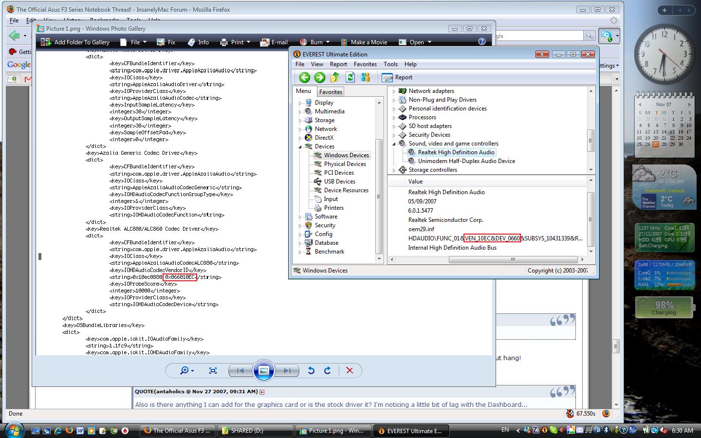

antaholics Posted November 27, 2007 Author Share Posted November 27, 2007 1.For sound there is a work in progress for AppleHDA (not stil working). Meanwhile you can use AppleAzallia.kext (also by JAS dvd, i think). Just edit the info.plist to change 2. I'm almost sure that it's a bios problem (or wrong settings) 3. I'm using an USR805423, you can buy for about 20euro a ZD1211b based usb-dongle. Here a list http://linuxwireless.org/en/users/Drivers/zd1211rw/devices 4. Have you seen an Ethernet card in SystemProfiles for the Lan (Attansic-L1) ? Impossible! 5. See here http://forum.insanelymac.com/index.php?sho...4912&st=280 6. I use only wireless, I'm waiting for DeamonEs to have time to finish the linux-driver porting Thanks again AlexIT! I'm going to play around with the sound... but I'm not entirely sure what to change about the info.plist in the sound card driver... in case I can't figure it out, can you please explain how? With the HD I'm going to assume that it's because BIOS ver. 206 is having problems with that... but since 207 was buggy for me I'll just stick with IDE mode for now In terms of USB to ethernet, I was talking about this: http://www.ncix.com/products/index.php?sku...hnologies%20Inc. http://www.ncix.com/products/index.php?sku...facture=Kinamax because the ethernet driver doesn't look like it will work any time soon. I have NO idea if these will work with OSX or not though.. I have to do some research. I'd rather use the integrated wireless card if I can, because I carry my laptop around a lot and having a wireless thing sticking out the side is rather bulky. I hope the driver is almost done? Btw what's preventing this thing from running dual core? Also is there anything I can add for the graphics card or is the stock driver it? I'm noticing a little bit of lag with the Dashboard... Also my Bluetooth isn't working. It's not a biggy because I never use it anyway but it'd be cool to have it working! I remeber it worked on the 10.4.9 installation but not the 10.4.8 or 10.4.11 Btw (sorry I know this post has a LOT of points to it) there's no way to get the auto-scroll on the trackpad to work is there? I am SO glad the dashboard thing doesn't pop up when I swipe diagonally on the trackpad... my friend's macbook does and it PISSES ME OFF to no end lol Ethernet detected: (I am amazed too.. but it doesn't appear to work) Ant Link to comment https://www.insanelymac.com/forum/topic/70928-the-official-asus-f3-series-notebook-thread/page/4/#findComment-520060 Share on other sites More sharing options...
AlexIT Posted November 27, 2007 Share Posted November 27, 2007 I'm going to play around with the sound ... but I'm not entirely sure what to change about the info.plist in the sound card driver... in case I can't figure it out, can you please explain how? smile.gif If you open the info.plist of th appleazalia.kext you can see a line about iopcimatching (or something like this) and just below a line with some hex values (eg. 0x088010ec). You should add your! You can take from windows, in hardware device tab of system properties, or with the Everest utility. In terms of USB to ethernet, I was talking about this: http://www.ncix.com/products/index.php?sku...hnologies%20Inc. http://www.ncix.com/products/index.php?sku...facture=Kinamax because the ethernet driver doesn't look like it will work any time soon. I have NO idea if these will work with OSX or not though.. I have to do some research. It depends on the chipset inside it. Search for some realtek or (old) atheros one. Btw what's preventing this thing from running dual core? We are using the old APIC/ACPI stuff, the doesn not know our cpus sad.gif. The new ones would use all the cores ... but hang! I hope that new bioses will come and be well-done, so working with new apic/acpi kexts. Also is there anything I can add for the graphics card or is the stock driver it? I'm noticing a little bit of lag with the Dashboard... The G84 G86 gpus should work , but something prevent them to allocate the correct addresses, so if you enable them (with injecting some correct EFI values) they crash the system as soon as they activate displays. I tried all possible values for all possible variable, got them frme macbookpro3,1 and other original EFi system, but it crashes. By now I moved away all NV* and GeF* kext and use the standard internal VESA driver, and it's not so bad. Also in leopard 10.5.1 there is the same problem. Also my Bluetooth isn't working. It's not a biggy because I never use it anyway but it'd be cool to have it working! I remeber it worked on the 10.4.9 installation but not the 10.4.8 or 10.4.11 sad.gif Try to put it on (fn+F2 I think) during boot, at the very beginning of booting process. there's no way to get the auto-scroll on the trackpad to work is there? I am SO glad the dashboard thing doesn't pop up when I swipe diagonally on the trackpad... my friend's macbook does and it PISSES ME OFF to no end lol tongue.gif I hate trackpad-autoscroll! I think you can enable it in system-configure, or some new ApplePS2Track kext. But I'll never do it tongue.gif Ethernet detected: (I am amazed too.. but it doesn't appear to work) It's not relevant, it only reads the systempreferences and could be faulty. You should see in SystemConfig->Network to see if it is detected. But where is CIUF? Hey CIUF did you give-up? Link to comment https://www.insanelymac.com/forum/topic/70928-the-official-asus-f3-series-notebook-thread/page/4/#findComment-520093 Share on other sites More sharing options...
antaholics Posted November 27, 2007 Author Share Posted November 27, 2007 Hi Ant. ok. i got the vista, erased the whole HDD, split into 20/20/140 (160GB in total), intalled vista into the first partition (disk0s1), and the JaS (10.4.8) in the second partition (installed with -x -v cpus=1...is that right?), then erase the partition into Mac(Journal), selecting only the JaS intel patch. When I reboot after installation, I boot the DVD with F8, entering "-x -v cpus=1 rd=/dev/disk0s2"... the result is "still waiting for root service"... something wrong...? thx. Hyper PS: also the vista wont boot after the installation of OSX...does it have anything to do with the bios version...? currrently running 206... Hey hyperloop, Did you install the Intel kexts and the SATA kexts (if your disk has them)? If it still doesn't work try changing your IDE setting in your BIOS to "Compatible" I didn't have this problem with booting from the DVD though... Hope this helps Ant Link to comment https://www.insanelymac.com/forum/topic/70928-the-official-asus-f3-series-notebook-thread/page/4/#findComment-520098 Share on other sites More sharing options...
antaholics Posted November 27, 2007 Author Share Posted November 27, 2007 Where do I get the updated trackpad kext? I tried putting the 0x066010EC (my vendor/device number) in and nothing happened Is the sound card for F3SV different from F3SC? Link to comment https://www.insanelymac.com/forum/topic/70928-the-official-asus-f3-series-notebook-thread/page/4/#findComment-520132 Share on other sites More sharing options...
Alguno Posted November 27, 2007 Share Posted November 27, 2007 Ethernet detected: (I am amazed too.. but it doesn't appear to work)Same here, it is the iwl3945 driver that is loaded, but not fully operational. At my laptop I see 'HW Microcode' error's during the initialisation of the cardI tried putting the 0x066010EC (my vendor/device number) in and nothing happened Is the sound card for F3SV different from F3SC?I've also got a F3SV here and the PCI ID of my audio controller is 8086 284b Link to comment https://www.insanelymac.com/forum/topic/70928-the-official-asus-f3-series-notebook-thread/page/4/#findComment-520144 Share on other sites More sharing options...
AlexIT Posted November 27, 2007 Share Posted November 27, 2007 Where do I get the updated trackpad kext? I tried putting the 0x066010EC (my vendor/device number) in and nothing happened Is the sound card for F3SV different from F3SC? I don't know, it should be the same. @algo: you're right , you have to change also the ICH id , maybe I don't remember and I don't have my HackBookPro here ... but check this: 1. Move away the AppleHDA.kext !!! IMPORTANT !!! 2. Edit AppleAzaliaAudio.kext for matching codec's proper ID: Try putting 0x10EC0660 (instead of 0x066010EC), 3. Edit AppleAzaliaController.kext (a plugin inside the azalia) for matching ICH8 HDA interface proper ID: Try putting 0x284b8086 (or your ICH id if different), 4. makemkext && reboot Link to comment https://www.insanelymac.com/forum/topic/70928-the-official-asus-f3-series-notebook-thread/page/4/#findComment-520175 Share on other sites More sharing options...
antaholics Posted November 27, 2007 Author Share Posted November 27, 2007 I don't know, it should be the same. @algo: you're right , you have to change also the ICH id , maybe I don't remember and I don't have my HackBookPro here ... but check this: 1. Move away the AppleHDA.kext !!! IMPORTANT !!! 2. Edit AppleAzaliaAudio.kext for matching codec's proper ID: Try putting 0x10EC0660 (instead of 0x066010EC), 3. Edit AppleAzaliaController.kext (a plugin inside the azalia) for matching ICH8 HDA interface proper ID: Try putting 0x284b8086 (or your ICH id if different), 4. makemkext && reboot I tried that and nothing happened I also tried 0x8086284b and 0x066010EC and still nothing you sure that's how you got yours to work? Ant Link to comment https://www.insanelymac.com/forum/topic/70928-the-official-asus-f3-series-notebook-thread/page/4/#findComment-520673 Share on other sites More sharing options...
