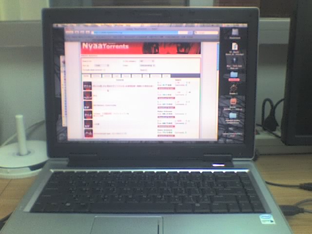

mushr00m Posted October 8, 2008 Share Posted October 8, 2008 Hi righteye, your files didnt work for me. i got full res and qe/ci with some old ATINDRV, patched ATIRadeonX1000 binary and modified Info.plist's. The drawback is, i get only an image on the external monitor. the internal lcd panel is dark. with dark i mean, i can see an application window moving it around but the lcd panel is turned off. this is the problem all people owning a ASUS A8JP had, so i think one cant solve it with the common methods. one thing i noticed is, that the FN+F7 key combination (which turns the panel on and off) is disabled, the other ones work though. so maybe something with power management? ASUS maybe uses a strange integration with motherboard/graphics card/panel. do you have any idea how to solve this problem? greets, mushr00m. Link to comment https://www.insanelymac.com/forum/topic/70843-ati-mobility-radeon-x1700/page/15/#findComment-922651 Share on other sites More sharing options...
mushr00m Posted October 8, 2008 Share Posted October 8, 2008 UPDATE: i got an image on lcd, but its a bit ugly ^^ check: http://img361.imageshack.us/img361/7986/img3326se1.jpg the external monitor is fine: http://img160.imageshack.us/img160/9099/img3325yf8.jpg this is all related to an ASUS A8JP laptop. i did add following values to info.plist which are based on a macbook pro ioreg dump with an ati mobility x1600. <key>@0,display-type</key> <string>LCD</string> <key>@0,display-inverter</key> <integer>2</integer> <key>@0,backlight-PWM-freq</key> <integer>210000</integer> <key>@0,inverter-current</key> <integer>0</integer> <key>@0,display-inverter-default-cycle</key> <integer>255</integer> im going to test different combinations of those, as well as adding other key/value pairs i found inside the ioreg dump. my info.plist and the ioreg dump are both attached to this post. Info.plist.txt ioreg.txt greets, mushr00m Link to comment https://www.insanelymac.com/forum/topic/70843-ati-mobility-radeon-x1700/page/15/#findComment-923087 Share on other sites More sharing options...

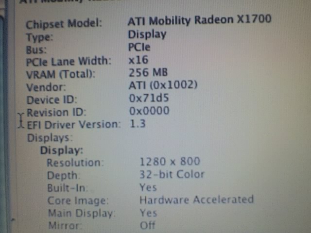

Xess666 Posted October 10, 2008 Share Posted October 10, 2008 Hey guy! now i get my A8Jp LCD bright on. Thank a lot mushr00m for your information. I Just add like mushr00m's post in ATIinject (the huan edition) **Dual Monitor working too** and stable This is my result Link to comment https://www.insanelymac.com/forum/topic/70843-ati-mobility-radeon-x1700/page/15/#findComment-925383 Share on other sites More sharing options...
