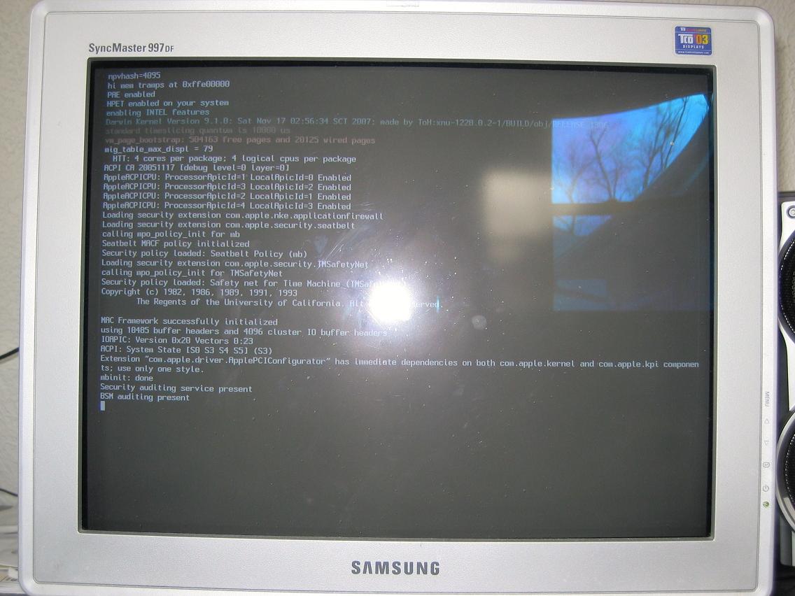

jimmyvau Posted January 6, 2008 Share Posted January 6, 2008 Here is a screen shot of what I get after enabling verbose mode. All the kexts load and then it comes to this screen and just freezes. I have no HD or DVD drive activity. Also, here is a detailed list of specs. Intel Q6700 DG33TL 1 Hitachi 180GB SATA HD 1 250GB Western Digital SATA HD 1 Pioneer IDE DVD-RW 2GB DDR2 800 Link to comment Share on other sites More sharing options...
ronpaul Posted January 6, 2008 Share Posted January 6, 2008 I' m pretty sure all you need is a SATA dvd drive. Will know for sure on tuesday when i get mine. Also I spoke to someone with the`dg33tl who confirmed that restart worked but shutdown didnt. Also SATA ports 1/2 work. SATA 3-6 untested. Anyone have any luck testing multiple hdd's after sucessful install? Link to comment Share on other sites More sharing options...
ronpaul Posted January 11, 2008 Share Posted January 11, 2008 Okay IT DOES WORK ON THE DG33TL!!!!! Heres how! You must have a SATA hdd & dvd-rw hooked up to the top two SATA channels. If you have other drives disconnect them during the install! When formating your drive select MBR not GUID! During the install click customization & check the two kernel files and go to EFI Bootloader & select MBR! Once you get that all installed you will need to install the 9271 sound drivers which are easy to install by searching "Sigmatel 9271" on here. GOOD LUCK & HAPPY OSX86ing! By the way its FAST AS HELL! VOTE RON PAUL 2008! Edit: SLEEP/SHUTDOWN/RESTART work PERFECT! MULTIPLE DRIVES ALSO WORK!!! Link to comment Share on other sites More sharing options...

xexen Posted January 20, 2008 Share Posted January 20, 2008 You need to set your drives to AHCI not raid. Sorry for the confusion, I just reinstalled on a bigger hdd. Could you do everyone a hugh favor and post all the settings in your BIOS. I've tried everything and still get freezing at either BSM auditing present or ACPI: Button driver prevents system sleep, and other times get a Waiting on <dict ID="0"> ... Boot-uuid-media</string></dict>. Settings like SW Single Processor Mode, XD Technology, VT Technology, ACPI Suspend State, UEFI boot. I think if we had the exact working settings. We can move on to figuring out that maybe there is a component issue. Thanks Link to comment Share on other sites More sharing options...

telepete19 Posted January 22, 2008 Share Posted January 22, 2008 hey guys. is there a way around the 'BSM Auditing Present' hang? with my hardware (dg33tl, 1gb ram, q6600) i freeze at the same place every time. i'm trying to keep this simple by using on-board video and sound. iAtkos and Kalyway both do the same thing so i know that the problem is not with the install dvds. As it stands now I can't even get to the Leopard install screen. Link to comment Share on other sites More sharing options...
xexen Posted January 23, 2008 Share Posted January 23, 2008 hey guys. is there a way around the 'BSM Auditing Present' hang? with my hardware (dg33tl, 1gb ram, q6600) i freeze at the same place every time. i'm trying to keep this simple by using on-board video and sound. iAtkos and Kalyway both do the same thing so i know that the problem is not with the install dvds. As it stands now I can't even get to the Leopard install screen. I'm still trying to figure it out. Mine hangs there also using stock onboard video as well as a PCI card. I'm fixing to order a known working PCI Express card. Stay tuned... Link to comment Share on other sites More sharing options...

telepete19 Posted January 23, 2008 Share Posted January 23, 2008 by typing 'cpus=1' at the darwin prompt, the computer goes past 'auditing present' and adds this: From path: "uuid", Waiting for boot volume with UUID F0F8EEC8-E6A8-3F3A-888A-C706B63FB076 Waiting on <dict ID="0"><key>IOProviderClass</key><string ID="1">IOResources</string><key>IOResourceMatch</key><string ID="2">boot-uuid-media</string></dict> where it then freezes again. Anyone know what it means? or am I still just spinning my wheels trying to get osx on this @#$%^&* thing? Link to comment Share on other sites More sharing options...
