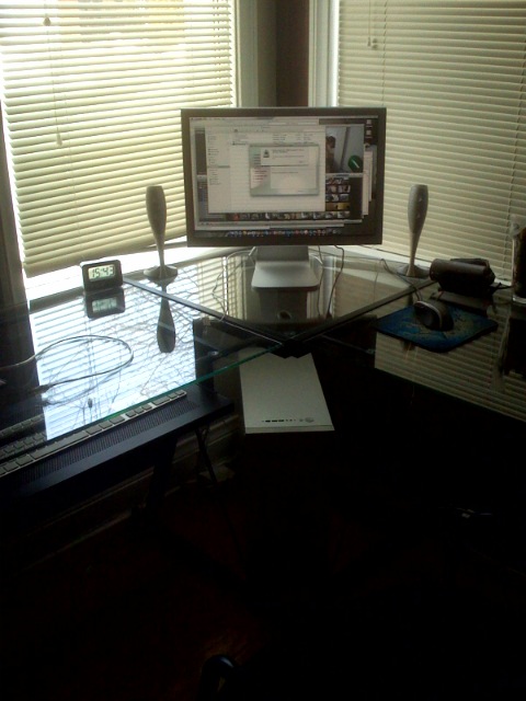

dsballer2000 Posted March 3, 2008 Share Posted March 3, 2008 Just finished my second install of OSX. A little over a year ago I installed OS X Tiger on an Asus P5W and then scrapped the whole osx86 thing because I couldn't get all my apps working and went with a Macbook. Then I bought an Imac and realized that my osx86 was noticeably faster so I sold my imac and now using the intel purchase program. Here is my specs: Intel q6700 Intel DG33TL board 4gb(2x2gb) OCZ Platinum DDR800 BFG 8800GT OC 512mb PCI-E 500gb SATA & 320gb SATA 20" Apple Cinema Display Lian Li a16a Silver Aluminum case Apple slim aluminum keyboard Apple Wireless Mighty mouse(changing to a Logitech MX620) Harmon Kardon 3 piece speaker set Gigabit ethernet PCI card Everything is working and the pc is absolutely beautiful with the 20" display and Lian-li case. I recommend this case to anyone who is looking to build a hack pro because it matches the Aluminum display perfectly and is very ez to setup. I used the Kalyway 10.5.1 dvd, the 10.5.2 comboupdate and teh 10.5.2 vanilla kernel update. Everything is running fast. I did have to use memmax=3325 in my com.apple.boot.plist in order for crashing to stop but now everything runs perfect. xbench so far is at 162 but i believe that's because of the slow disks and no overclocking. I will tweak things as I go. Ilife 08 works without a hitch as well as Final Cut Pro with my HD Sony camcorder. So far I'm loving this setup. Link to comment Share on other sites More sharing options...
