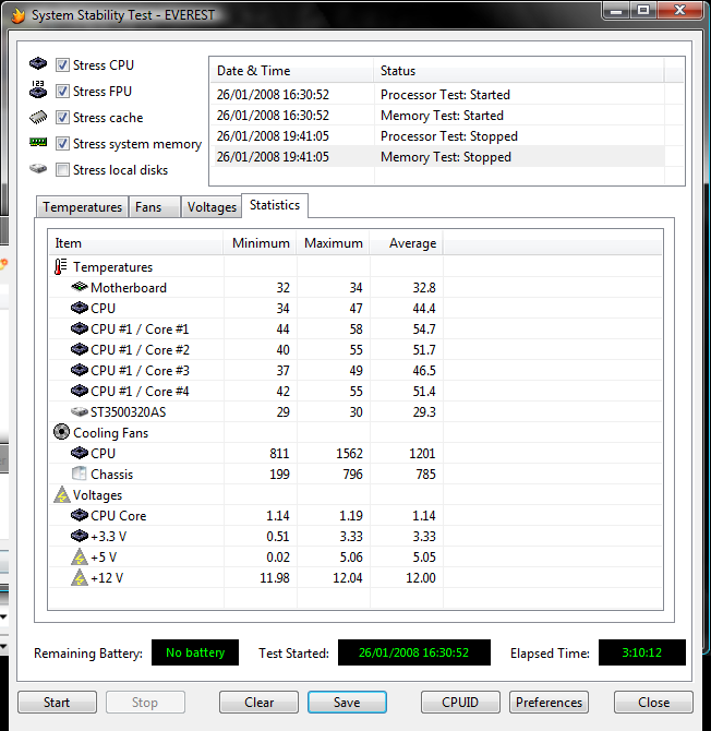

aspirina750 Posted January 26, 2008 Share Posted January 26, 2008 I would say that there´s a 10-15º difference between Leo and Vista. I just finished a 3 hours stress test of my system (See the picture). I inmediately switched to Leo, and Tempereature Monitor was showing the cores at 72º-69º-63º-68º. If you compare it to the stress test, max temperature with the cores working at 100% during 3 hours never reached 60º so there´s some problem with Temperature Monitor. Link to comment https://www.insanelymac.com/forum/topic/64609-how-accurate-is-temperature-monitor/#findComment-595530 Share on other sites More sharing options...
