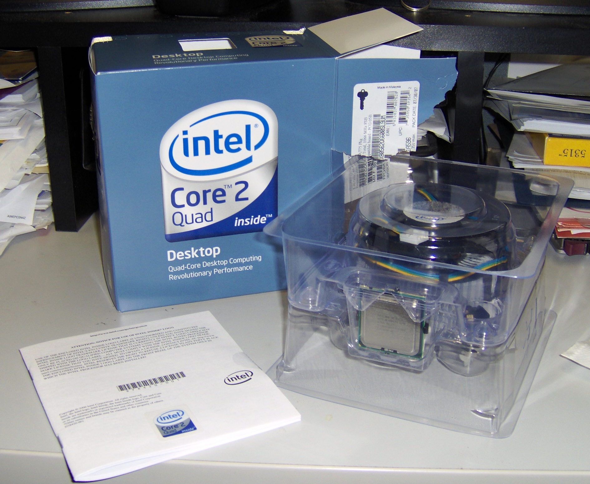

reghost Posted August 20, 2007 Share Posted August 20, 2007 Going to pop this puppy into my BadAxe2 tonight. Anyone tryed OC'n this baby yet? Link to comment https://www.insanelymac.com/forum/topic/60829-just-got-my-q6600-in-the-mail/ Share on other sites More sharing options...
