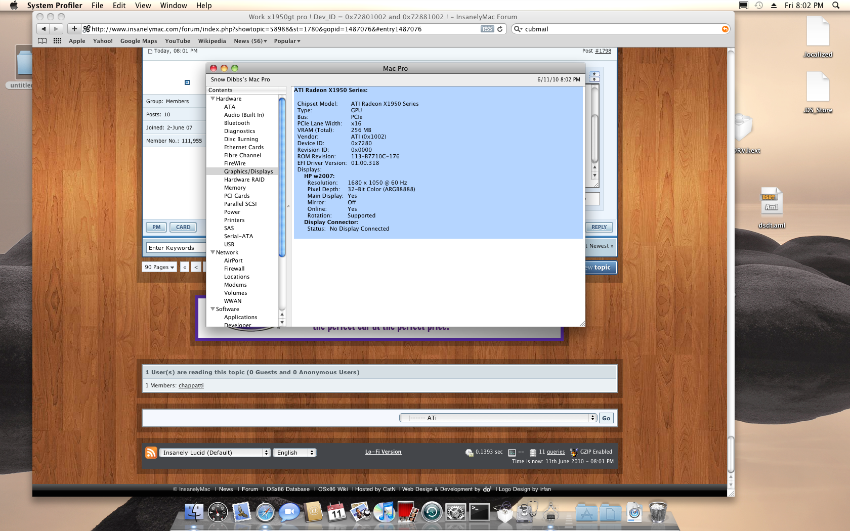

chappatti Posted June 12, 2010 Share Posted June 12, 2010 TO JAMINMC A BIG thanks to you. After agony, there is ecstasy!! :angel: Your kexts work as follow on my x1950Pro in 32-bit + res + QE/CI device id 7280 ** Put your kexts in Extra/Extensions ** Put ATIRadeonX1000...in S/L/E. (A caveat: One thing after so much fidgeting with this kext I am not 100% sure where my working one is exactly from !!! :) :P , But I am leaning heavily towards it being yours.) BUT I had to add device id to ATI1900Controller.kext to get full resolution and QE/CI. Everything else is vanilla. So if anyone else gets screen to work at basic res, adding device to ATI1900Controller may help. Without this everything is basic. NO DSDT patch, Nothing else added. Jaminmc, why is this so? AND, PLEASE I DO NOT SEE MY HD ON THE DESKTOP....I think this may just be a setting issue on 10.6.3??? since everything else I put on my desktop shows. A huge thanks again! EDIT: I used the following site ( http://www.ltooz.com/ltooz341/item/testing...os-x-1058--1063 ) to check for QE/CI function, BUT THE QE/CI DOES NOT SHOW IN "About This Mac". But the tests work. Make sense ?? Link to comment https://www.insanelymac.com/forum/topic/58988-work-x1950gt-pro-dev_id-0x72801002-and-0x72881002/page/72/#findComment-1487076 Share on other sites More sharing options...
