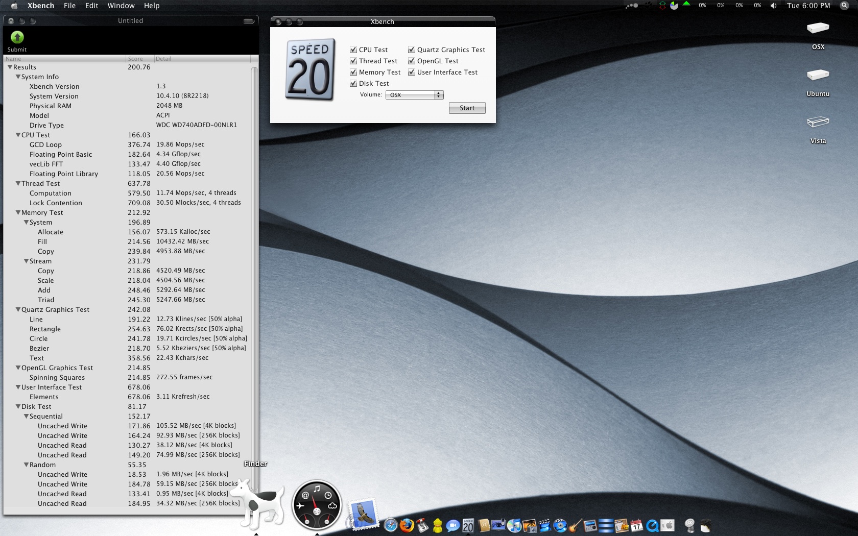

sarahbau Posted July 11, 2007 Share Posted July 11, 2007 Nice scores, but what are you running? Edit: Nevermind. I see you're running basically the same stuff as Vlad, but with much better results for some reason. Edit again: I don't see your CPU listed. It's interesting that the CPU result wasn't much higher than the E6320 @ 3.0, but the Thread test was twice as high. Is it a Core 2 Quad? Link to comment https://www.insanelymac.com/forum/topic/56545-new-hackintosh-abit-ip-35-pro-intel-p35-chipset/page/2/#findComment-405652 Share on other sites More sharing options...
drewintheav Posted July 11, 2007 Share Posted July 11, 2007 Hi sarahbau, A Q6600, an Abit IP35 Pro, and 2 GB of DDR2. Is there a bug in xBench? or is it a driver issue? The score of a single individual test (uncached write), brings the whole score down to an unrealistic value. Does anybody know if there is a fix for this hard disk performance issue? Link to comment https://www.insanelymac.com/forum/topic/56545-new-hackintosh-abit-ip-35-pro-intel-p35-chipset/page/2/#findComment-405655 Share on other sites More sharing options...
vlad1966 Posted July 11, 2007 Author Share Posted July 11, 2007 Maybe the HDD performance is so low because we're using AHCI for SATA mode? Doesn't explain why the rest of my xBench scores suck. Although this feels like the quickest Mac I've ever used. It will be hard to part with. Ijust tried playing Open Arena & It's fast as Hell - so fast I couldn't keep up with it & I kept getting destroyed @ 1600x1200 Link to comment https://www.insanelymac.com/forum/topic/56545-new-hackintosh-abit-ip-35-pro-intel-p35-chipset/page/2/#findComment-405687 Share on other sites More sharing options...
wood_e Posted July 12, 2007 Share Posted July 12, 2007 yep those xbench scores aren't stunning, they're not what they should be. My hackintosh gets 105 with my SATA 1TB RAID Link to comment https://www.insanelymac.com/forum/topic/56545-new-hackintosh-abit-ip-35-pro-intel-p35-chipset/page/2/#findComment-406637 Share on other sites More sharing options...
Hirez Posted July 12, 2007 Share Posted July 12, 2007 Wood: how do you get a TB raid working there? does it work with hardware or are you using softraid? is that the same performance? Link to comment https://www.insanelymac.com/forum/topic/56545-new-hackintosh-abit-ip-35-pro-intel-p35-chipset/page/2/#findComment-406705 Share on other sites More sharing options...
sarahbau Posted July 12, 2007 Share Posted July 12, 2007 Xbench just sucks I think. My PowerBook gets a 5 in sequential write, and a 630 in random write. lmao Link to comment https://www.insanelymac.com/forum/topic/56545-new-hackintosh-abit-ip-35-pro-intel-p35-chipset/page/2/#findComment-406718 Share on other sites More sharing options...
