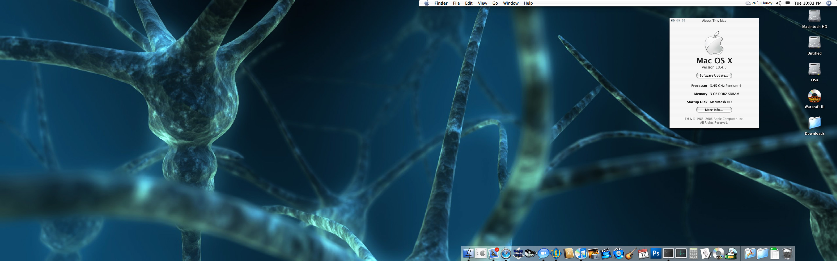

Nykwil Posted June 14, 2007 Share Posted June 14, 2007 Specs: CPU: core 2 duo e6600 Ram: Corsair xms2 2gig ddr2 800 Mobo: Gigabyte 965P-DQ6 HDD: Seagate 7200.10 500gb PSU: Seasonic M12 600w VID: SAPPHIRE X1950xtx 512mb The motherboard tray was from a coolermaster wavemaster case the video spans across both displays just fine via DVI Link to comment https://www.insanelymac.com/forum/topic/53904-dual-spanning-postem-if-you-got-em/#findComment-385206 Share on other sites More sharing options...
RobD Posted June 14, 2007 Share Posted June 14, 2007 ... I started this thread because i think im just going to go ahead and buy a new card (200 bucks is 2,000 cheaper than a new mac). That makes sense. Could those who post their success stories please also post a screen capture of their display settings... ? (and/or their System Profile video card readings). Nice pics nykwil. Cheers Link to comment https://www.insanelymac.com/forum/topic/53904-dual-spanning-postem-if-you-got-em/#findComment-385389 Share on other sites More sharing options...
