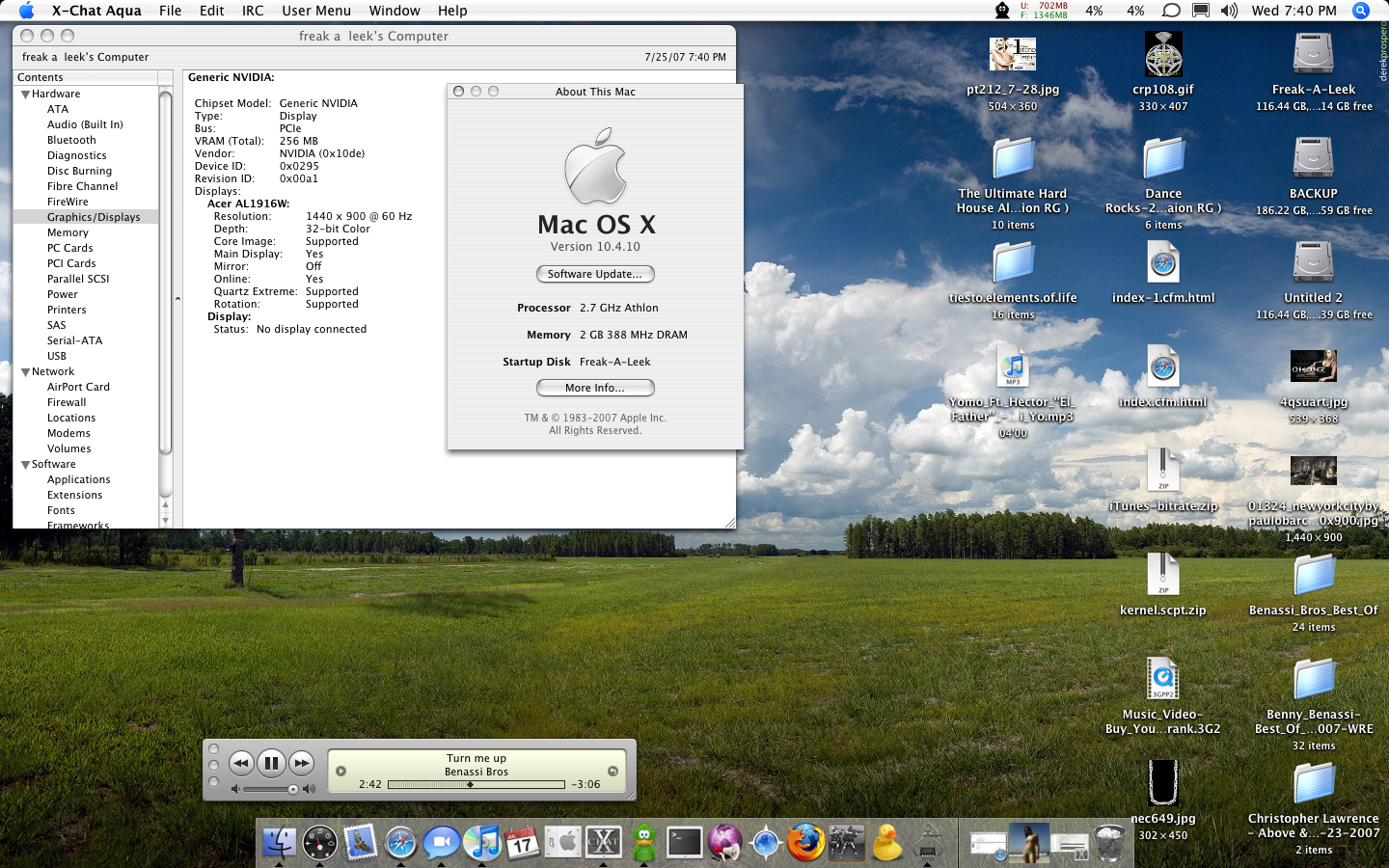

RobNyc Posted May 23, 2007 Share Posted May 23, 2007 Generic NVIDIA: Chipset Model: Generic NVIDIA Type: Display Bus: PCIe VRAM (Total): 256 MB Vendor: NVIDIA (0x10de) Device ID: 0x0295 Revision ID: 0x00a1 Displays: Acer AL1916W: Resolution: 1440 x 900 @ 60 Hz Depth: 32-bit Color Core Image: Supported Main Display: Yes Mirror: Off Online: Yes Quartz Extreme: Supported Display: Status: No display connected Doesnt seem to work for me Link to comment https://www.insanelymac.com/forum/topic/51886-evga-7950gt-256mb-pci-e/ Share on other sites More sharing options...

lithium06 Posted July 23, 2007 Share Posted July 23, 2007 RobNyc: i have supported for both qe and ci. see attached pic. http://www.grawcock.us/osx.png Link to comment https://www.insanelymac.com/forum/topic/51886-evga-7950gt-256mb-pci-e/#findComment-413831 Share on other sites More sharing options...
AaronR Posted July 24, 2007 Share Posted July 24, 2007 Why the status shows 'No display connected'? Link to comment https://www.insanelymac.com/forum/topic/51886-evga-7950gt-256mb-pci-e/#findComment-413906 Share on other sites More sharing options...
lithium06 Posted July 24, 2007 Share Posted July 24, 2007 It says Displays: BenQ FP931 Resolution 1280x1024 @ 60Hz blah blah so I have a display obviously but the other Display under that... i dont know. Link to comment https://www.insanelymac.com/forum/topic/51886-evga-7950gt-256mb-pci-e/#findComment-414231 Share on other sites More sharing options...

RobNyc Posted July 26, 2007 Author Share Posted July 26, 2007 Here's the new.. Jas 10.4.8 First post TubGirl 10.4.9 Same TubGirl 10.4.10 here same RobNyc: you haven't said what driver you have installed, if its Natit you can try and add your devID to the naming keys.Put the following code after "<string>IOPCIDevice</string>" in info.plist in natit.kext<key>Vendors</key> <dict> <key>0x10de</key> <dict> <key>Devices</key> <dict> <key>0x0295</key> <dict> <key>name</key> <string>NVIDIA GeForce 7950 GT</string> </dict> </dict> <key>name</key> <string>nVidia</string> </dict> </dict> if there are entries like this already, then just modify one of them to add your cards DevID.This might work (or crash), so keep a backup of your Natit.kext.These entries are in some versions of Natit. It seems that I have Titan installedWhen I had installed the Natit installer on 10.4.8, 10.4.9 I got kernel panicsI'm scared to do it here on 10.4.10 Link to comment https://www.insanelymac.com/forum/topic/51886-evga-7950gt-256mb-pci-e/#findComment-415045 Share on other sites More sharing options...
