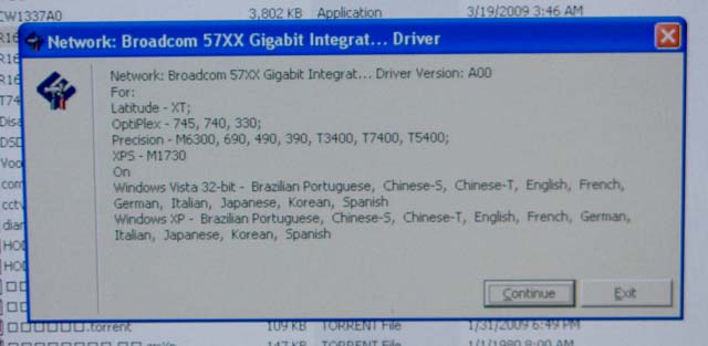

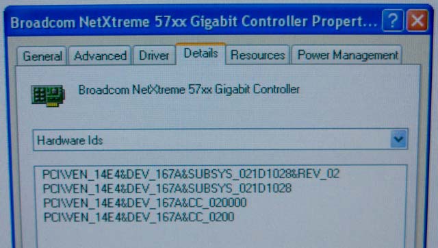

crazy drummer Posted April 26, 2009 Share Posted April 26, 2009 Hi all I've got a Dell Precision T7400 workstation, and finally get its broadcom 5754 working (with window$ installed, i find that inside T7400 is a 5754, and probably share more or less the same hardware with a no. of dell products, one of these is the XPS 1730 laptop in the 2nd link below, the only difference being on T7400 the device id is 167a, not 1672) i get the 2 kexts from here then modify with ref. to this post first, i replace 167d with 167a in BOTH the info.plist inside "AppleBCM5751Ethernet.kext" AND "AppleBCM5751Ethernet.kext inside IONetworkingFamily.kext" second, with hex editor, replace all "66 81 FA 7D 16" with "66 81 FA 7A 16", then "F8 08 75 59" with "F8 08 74 59" of only AppleBCM5751Ethernet.kext/Content/MacOs/AppleBCM5751Ethernet (i once tried doing the hex replacement also on AppleBCM5751Ethernet inside IONetworkingFamily.kext, but this causes KP) install the 2 kexts, then the usual repair permissions/clear cache/rebuild cache/touch extensions folder housekeeping stuff reboot, boom! an ethernet adaptor appears in system pref.! i have no problem with the mac address being all 00000000 with DHCP, connect to router and internet fine~ 10.6 will probably break sth but who cares now thx for sharing all these wonderful stuff, you guys rock!!! cheers!!! Link to comment https://www.insanelymac.com/forum/topic/4987-broadcom-570x-and-575x/page/31/#findComment-1141926 Share on other sites More sharing options...
