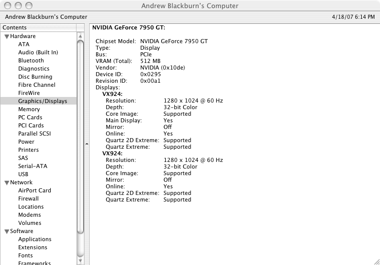

Blurn Posted April 18, 2007 Share Posted April 18, 2007 Just wanted to report that this fix works on my PNY 7950GT 512MB card. Dual DVI monitors. Full QE/QE2D/CI... Using Natit Dual 0.2 (Screen shot Attached) Link to comment https://www.insanelymac.com/forum/topic/45938-512mb-nvidia-fix-done/#findComment-349474 Share on other sites More sharing options...
