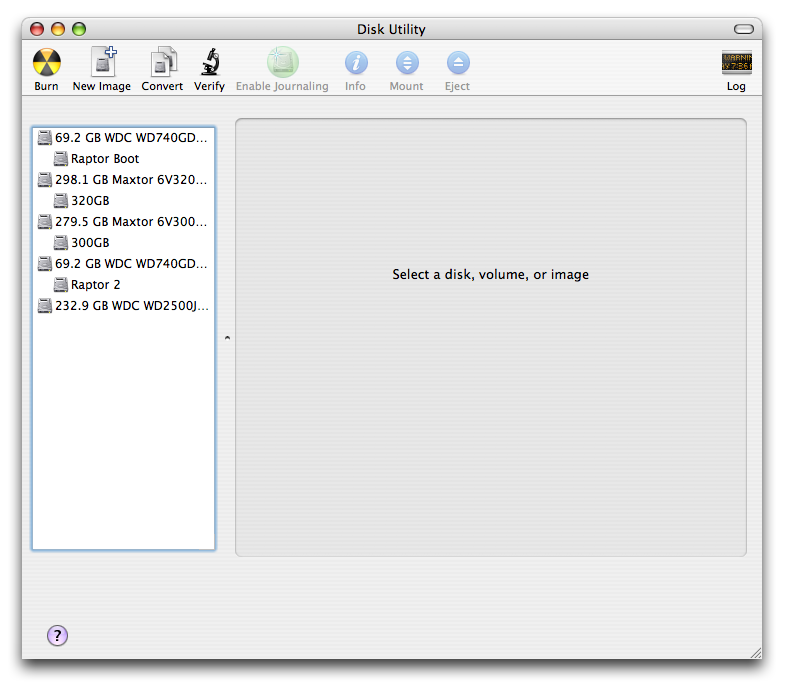

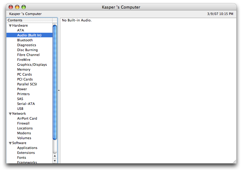

KasperNL Posted March 9, 2007 Author Share Posted March 9, 2007 Just build and installed my brand new Hackintosh with the D975XBX2 (8 port SATA) installed. Nearly everything is working except: - 4 additional Marvell SATA ports (causing 2 of my harddisks not to work) - Audio I just read a whole topic about getting the audio to work, but when I launch 'AppleHDAPatcher_v1.15.app' it requests my Admin password, when I supply this password I get a kernel panic (the screen with the diferent languages telling me to reboot).. Anybody any idea on getting these 2 things to work? Thanks... Link to comment https://www.insanelymac.com/forum/topic/43444-intel%C2%AE-desktop-board-d975xbx-vs-gigabyte-ga-965p-dq6/#findComment-320180 Share on other sites More sharing options...
nagal Posted March 9, 2007 Share Posted March 9, 2007 Which kernel are you using? There is some info in the AppleHDA patcher theard about upgrading to the DemonES kernel. Link to comment https://www.insanelymac.com/forum/topic/43444-intel%C2%AE-desktop-board-d975xbx-vs-gigabyte-ga-965p-dq6/#findComment-320183 Share on other sites More sharing options...
KasperNL Posted March 9, 2007 Author Share Posted March 9, 2007 I'm currently using the kernel which came with my JaS 10.4.8 DVD, it's Symthex 8.8.1 or something like that.. Link to comment https://www.insanelymac.com/forum/topic/43444-intel%C2%AE-desktop-board-d975xbx-vs-gigabyte-ga-965p-dq6/#findComment-320189 Share on other sites More sharing options...
nagal Posted March 9, 2007 Share Posted March 9, 2007 check out the AppleHDA patcher theard http://forum.insanelymac.com/index.php?showtopic=32859 I used it last night. Did not get my audio working but no kernel panic. I am using DemonES kernel which is not what comes on the JaS 10.4.* DVD Link to comment https://www.insanelymac.com/forum/topic/43444-intel%C2%AE-desktop-board-d975xbx-vs-gigabyte-ga-965p-dq6/#findComment-320190 Share on other sites More sharing options...

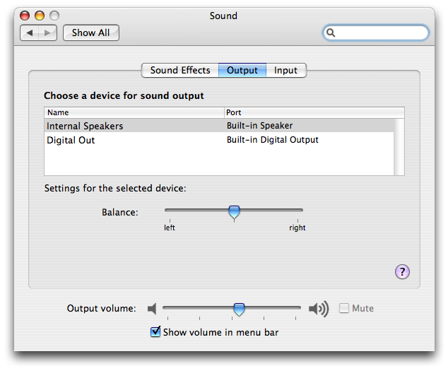

KasperNL Posted March 9, 2007 Author Share Posted March 9, 2007 (edited) Two things ... - Anybody has a solution for the 4 additional SATA ports? Just found the DeamonEs kernel at: http://forum.insanelymac.com/index.php?act...ost&id=5798 DeamonEs Kernel is now up 'n running.. Some things are changed by now: - Audio seems to work (not yet connected speakers, but atleasts show output devices in System Profiler) - CPU Speed Detection goes wrong With the Semthex kernel I had no audio, but the CPU speed was indicated correctly.. Another weird thing is that the System Profiler does show both audio input / output devices buth the System Profiler shows none (see screendumps).. With both kernels the Marvell SATA ports are not working and the System Profiler gives an error on the SATA information page (see screendump)... Anybody any idea how to fix the Marvell Sata ports? Edited March 9, 2007 by KasperNL Link to comment https://www.insanelymac.com/forum/topic/43444-intel%C2%AE-desktop-board-d975xbx-vs-gigabyte-ga-965p-dq6/#findComment-320237 Share on other sites More sharing options...
mifki Posted March 9, 2007 Share Posted March 9, 2007 Get the daemones's kernel or a updated semthex one from the kernel room, and for the additional SATA ports,try adding thier id into the Appleviaata kext. It worked on badaxe one, but im not sure how similar marvell is to VIA Link to comment https://www.insanelymac.com/forum/topic/43444-intel%C2%AE-desktop-board-d975xbx-vs-gigabyte-ga-965p-dq6/#findComment-320247 Share on other sites More sharing options...

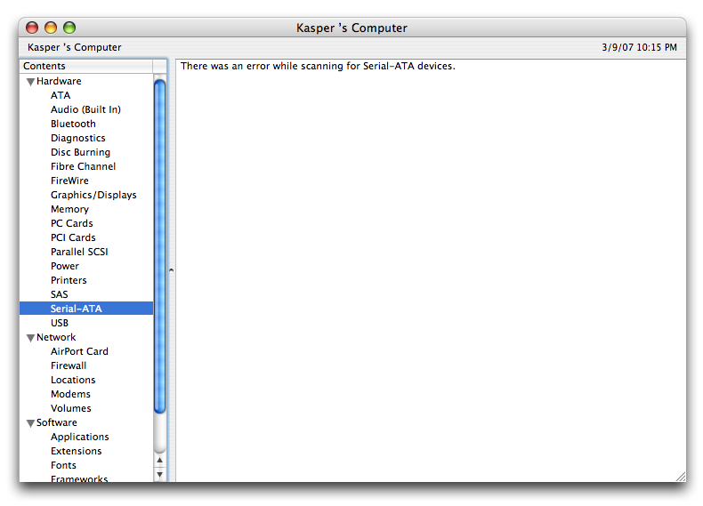

KasperNL Posted March 9, 2007 Author Share Posted March 9, 2007 Dear Kiko, How to detect the Device ID's of the Marvell adapter? Is there some terminal command I can use.. The System Profiler gives errors on the Serial-ATA, SCSI, SAS and PCI 'pages'. Link to comment https://www.insanelymac.com/forum/topic/43444-intel%C2%AE-desktop-board-d975xbx-vs-gigabyte-ga-965p-dq6/#findComment-320271 Share on other sites More sharing options...
mifki Posted March 9, 2007 Share Posted March 9, 2007 Wow, is this some sort of love letter or sumfin :S. Hmm, google? or install windows /linux Link to comment https://www.insanelymac.com/forum/topic/43444-intel%C2%AE-desktop-board-d975xbx-vs-gigabyte-ga-965p-dq6/#findComment-320275 Share on other sites More sharing options...
KasperNL Posted March 9, 2007 Author Share Posted March 9, 2007 Wow, is this some sort of love letter or sumfin :S. Hmm, google? or install windows /linux Sorry to bother you... Another thing which happens sometimes which is quite weird... Sometimes one of the two drives which is attached to the 'Marvell' controler show up in Disk Utility (when booted I get a message of an unformated disk, which isn't correct).. But only one disks shows up, but this disk is also seen as 'unpartitioned', whereas there's a HFS+ Journaled filesystem on the disk. (see screendump).. Link to comment https://www.insanelymac.com/forum/topic/43444-intel%C2%AE-desktop-board-d975xbx-vs-gigabyte-ga-965p-dq6/#findComment-320281 Share on other sites More sharing options...
