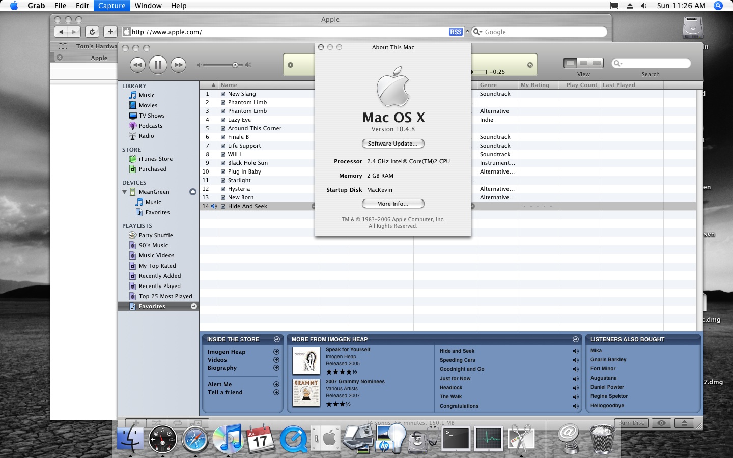

KDH Posted April 28, 2007 Share Posted April 28, 2007 Hey Folks... I have the Asus p5n-e SLI with the JaS 10.4.8 AMD/Intel ppf1 ppf2 installed and running beautifully (must use x11 and AMD install only on the "custom settings" for some reason). My Hardware: Intel e6400 @ 2.4 GHz 2 GB el cheapo ram @ 800MHz Seagate Sata drive (not detected) a couple of IDE drives (where my Mac OS is) eVGA 7600 GS running as a result of patching with natit_dual v0.02 Audio running as a result of patching with ALC883Audio.mpkg USB and Firewire detected NO ETHERNET dammit. Can anyone help please? K Link to comment Share on other sites More sharing options...

KDH Posted April 29, 2007 Share Posted April 29, 2007 Well... I cheated. I got a $5 Lan card from Fry's and now it works. It is the Airlink ASOHORL (No I didnt make that name up.) It isnt gigabit, but I didnt want to invest a whole lot just to try something out. Gigabit cards on the HCL can be had for about $20. K Link to comment Share on other sites More sharing options...
KDH Posted April 29, 2007 Share Posted April 29, 2007 PS.. This is a screen shot Link to comment Share on other sites More sharing options...
