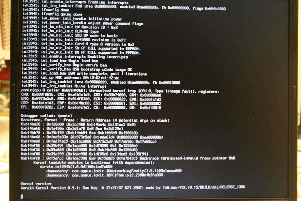

uk_rules_ok Posted October 27, 2007 Share Posted October 27, 2007 iwi3945i've disabled a feature that reads rfkill status since it doesn't give a kp i've put it back again still getting panic on Sony VAIO VGN-AR41L Mac OS X 10.4.10. Link to comment https://www.insanelymac.com/forum/topic/36976-intel-wireless-driver/page/128/#findComment-483297 Share on other sites More sharing options...

jalavoui Posted October 27, 2007 Author Share Posted October 27, 2007 iwi3945 wrote code for kp while scanning better test this with "boot -s" option if you get the same kp as uk_rules_ok try a few more times - i haven't figure out that kp yet the driver should pass this point and start the scan job iwi3945.dmg Link to comment https://www.insanelymac.com/forum/topic/36976-intel-wireless-driver/page/128/#findComment-483445 Share on other sites More sharing options...
uk_rules_ok Posted October 27, 2007 Share Posted October 27, 2007 iwi3945wrote code for kp while scanning better test this with "boot -s" option if you get the same kp as uk_rules_ok try a few more times - i haven't figure out that kp yet the driver should pass this point and start the scan job loaded the latest , here are the logs.. when starting normaly i get two diferent boot screens as attached sometimes i get panic and sometimes i dont, but when i dont it just freezes.. Link to comment https://www.insanelymac.com/forum/topic/36976-intel-wireless-driver/page/128/#findComment-483475 Share on other sites More sharing options...

jalavoui Posted October 28, 2007 Author Share Posted October 28, 2007 iwi3945 you all read about iwl_alive_start() beeing the core of driver setup but it was never called in logs i find out why instead of passing p=9 i was doing p=4 a simple bug that prevent the driver from working get ready to see some action in this release:) test this with the "boot -s" method explained in previous posts i find out what's happening with the cards that don't get detected in ioreg as pci8086,xxxx that happens because of shared irqs - this mean that the driver receivs interrupts of other devices!!! this can cause the driver to fail since i have no code to filter the interrupts from other devices!! can someone do a search on this subject - the driver will not work properly for those cards until this is fixed although ther'es some code to filter the interrupts from other drivers iwi3945 will be much slower this way iwi3945.dmg Link to comment https://www.insanelymac.com/forum/topic/36976-intel-wireless-driver/page/128/#findComment-484670 Share on other sites More sharing options...
