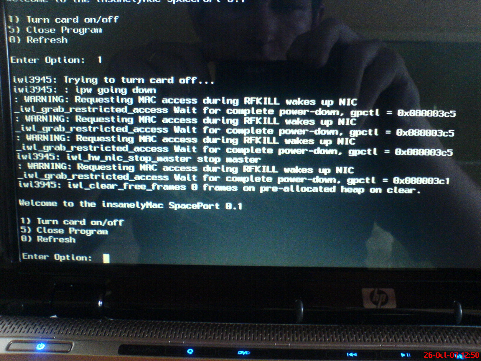

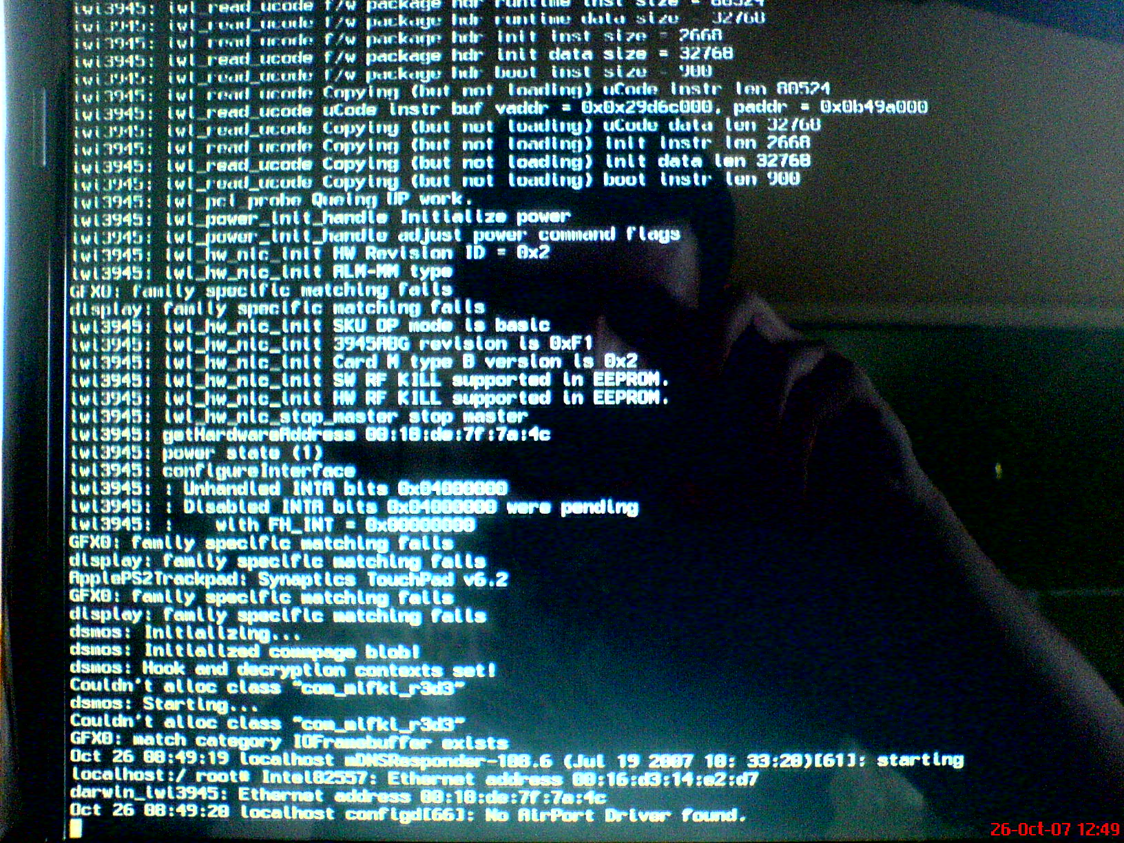

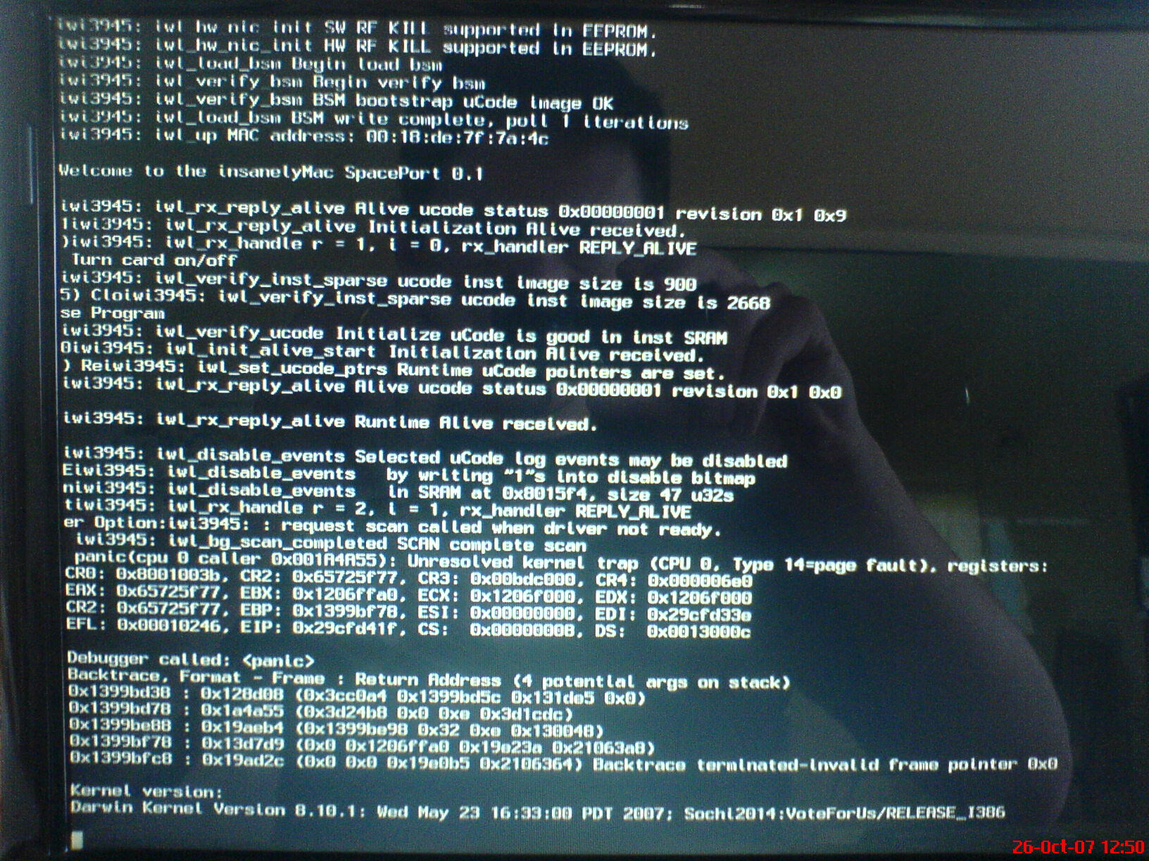

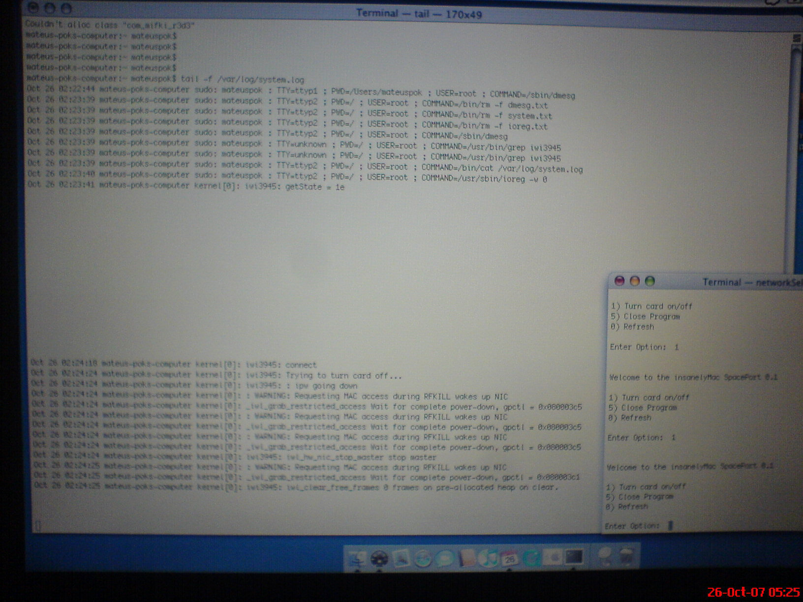

Mateus Posted October 26, 2007 Share Posted October 26, 2007 The logs files are from booting messages, before I try to run NS... the picture is from system.log when I tried to turn off and when tried to turn on, the system freeze and there's no message in the system.log ioreg.txt dmesg.txt system.txt Link to comment https://www.insanelymac.com/forum/topic/36976-intel-wireless-driver/page/127/#findComment-481899 Share on other sites More sharing options...

jalavoui Posted October 26, 2007 Author Share Posted October 26, 2007 iwi3945 panic fix to test this: install the driver copy networkselector to / folder reboot press F8 type -s type sh /etc/rc wait for driver to load if no kp them type ./networkselector try option 1 a few times take a picture of the screen if you get a kernel panic iwi3945.dmg Link to comment https://www.insanelymac.com/forum/topic/36976-intel-wireless-driver/page/127/#findComment-482122 Share on other sites More sharing options...
Mateus Posted October 26, 2007 Share Posted October 26, 2007 Thrid pictures is from driver load... Second pictures is from Trying to turn off First is from kernel panic when try to turn on... Link to comment https://www.insanelymac.com/forum/topic/36976-intel-wireless-driver/page/127/#findComment-482241 Share on other sites More sharing options...
