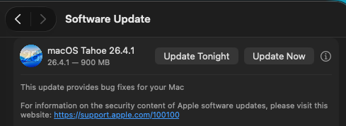

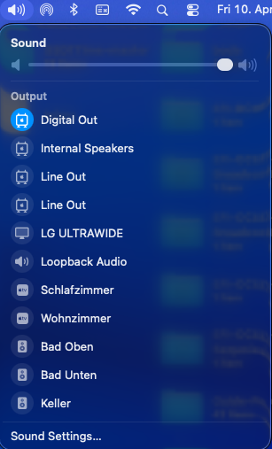

deeveedee Posted April 9 Share Posted April 9 (edited) Very easy update on my newest hack. My system config is as follows: HP EliteDesk 800 G4 Mini 65W (i5-8600 / UHD630 / 32GB DDR4) Open Core 1.0.7 / SIP csr-active-config = <01000000> / No root patches VoodooHDA.kext 3.3.4 Multi-output device configured with Audio MIDI Setup: speakers on 1st output, subwoofer on 2nd output. Audio quality is outstanding. Incremental Update Spoiler EDIT: I am extremely impressed with the responsiveness of this hack. Even with only Intel UHD630 graphics, Tahoe responsiveness is excellent. This is a perfect mini hack for a multimedia platform. Edited April 9 by deeveedee 5 Link to comment https://www.insanelymac.com/forum/topic/362627-release-macos-tahoe-2641/#findComment-2848895 Share on other sites More sharing options...

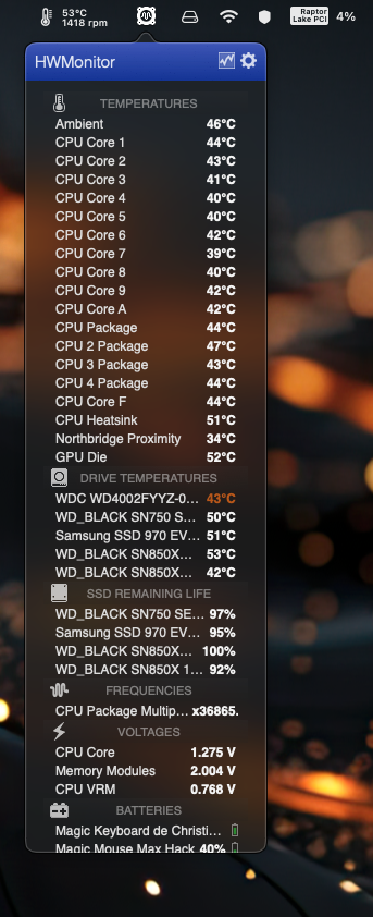

Max.1974 Posted April 10 Share Posted April 10 (edited) The icons really did return to normal on macOS 26.4.1, thank God! 😀 Low temperature is fine! Edited April 10 by Max.1974 6 Link to comment https://www.insanelymac.com/forum/topic/362627-release-macos-tahoe-2641/#findComment-2848906 Share on other sites More sharing options...
litemint09 Posted April 10 Share Posted April 10 Incremental update (900MB) done with Thinkpad T480, voodooHDA is not broken after doing the update, which is a good thing. 7 Link to comment https://www.insanelymac.com/forum/topic/362627-release-macos-tahoe-2641/#findComment-2848908 Share on other sites More sharing options...

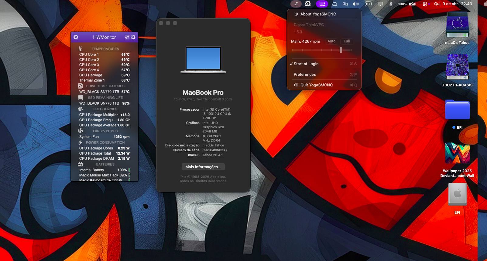

Max.1974 Posted April 10 Share Posted April 10 (edited) Nice my friend @litemint09 working fine here Lenovo T14 Edited April 10 by Max.1974 4 Link to comment https://www.insanelymac.com/forum/topic/362627-release-macos-tahoe-2641/#findComment-2848909 Share on other sites More sharing options...

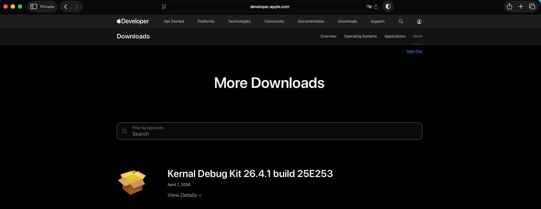

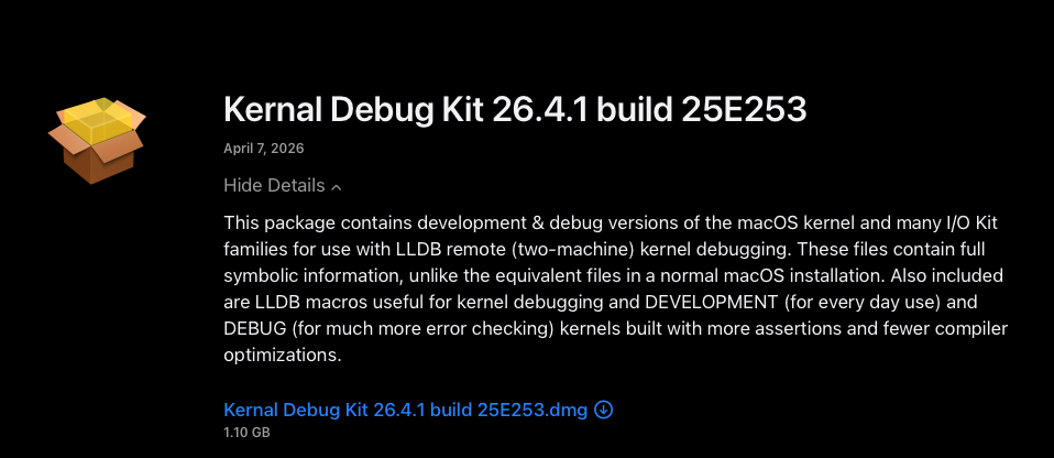

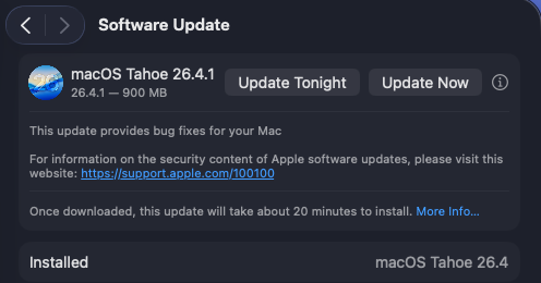

kgp Posted April 10 Share Posted April 10 (edited) Fast, painless and tiny (900 MB) sequential OTA update from macOS 26.4 to macOS 26.4.1 (25E253). New Kernel Debug Kit 26.4.1 build 25E253 available at Apple but not yet available at Dortania. -> For now running OCLP 3.0.0 Nightly (amfipassbeta variant) with Kernel Debug Kit 26.4 (build 25E246) from macOS 26.4. AppleHDA, Wi-Fi and AWDL are fully functional. The same likely applies to OCLP-Mod 3.1.7 and OCLP-Plus 3.1.9. Useful context information: a.) EFI-Folder distribution b.) Experimental Fork of OCLP 3.0.0 Nightly c.) OCLP-Mod d.) OCLP-Plus e.) X299 Guidelines Cheers, KGP 👍 Edited April 10 by kgp Fixing typo 4 3 Link to comment https://www.insanelymac.com/forum/topic/362627-release-macos-tahoe-2641/#findComment-2848910 Share on other sites More sharing options...

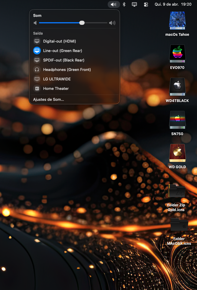

kaoskinkae Posted April 10 Share Posted April 10 prerfect in NEW: 5 Link to comment https://www.insanelymac.com/forum/topic/362627-release-macos-tahoe-2641/#findComment-2848911 Share on other sites More sharing options...

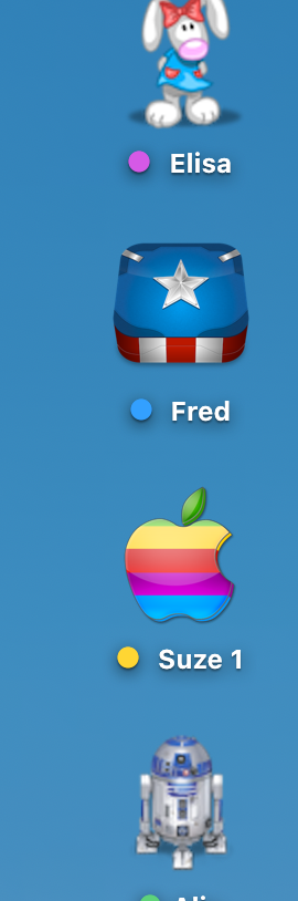

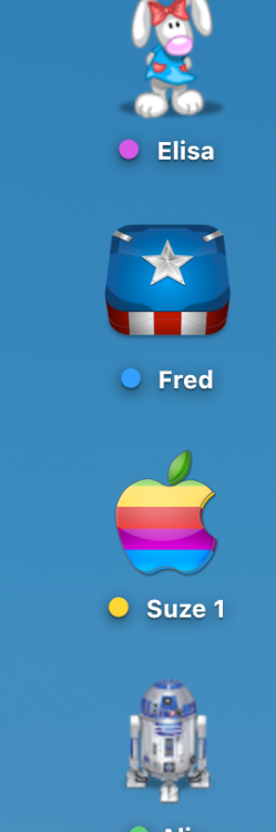

fredouille Posted April 10 Share Posted April 10 Hello Everything went OK and overall, custom Icons are back ! Great regards fred😃 5 Link to comment https://www.insanelymac.com/forum/topic/362627-release-macos-tahoe-2641/#findComment-2848916 Share on other sites More sharing options...

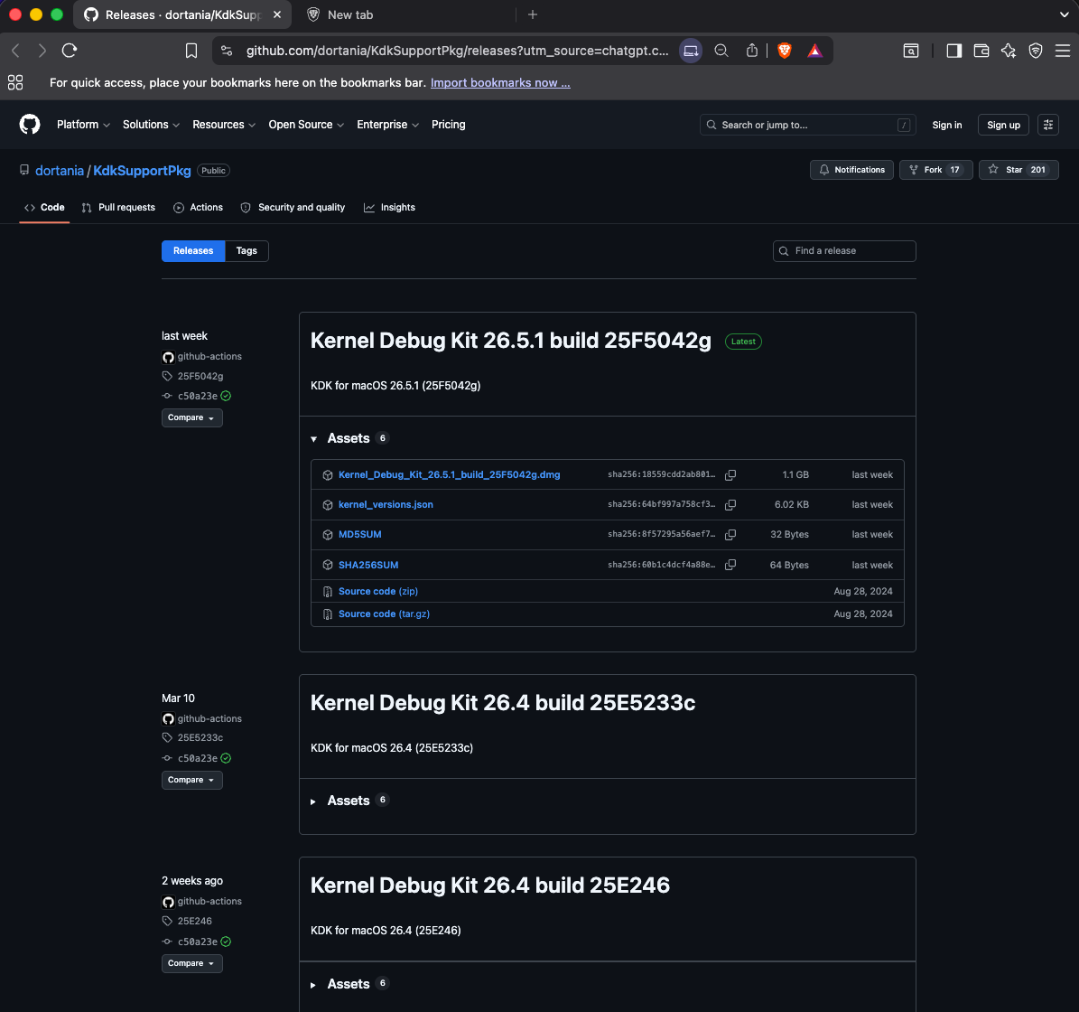

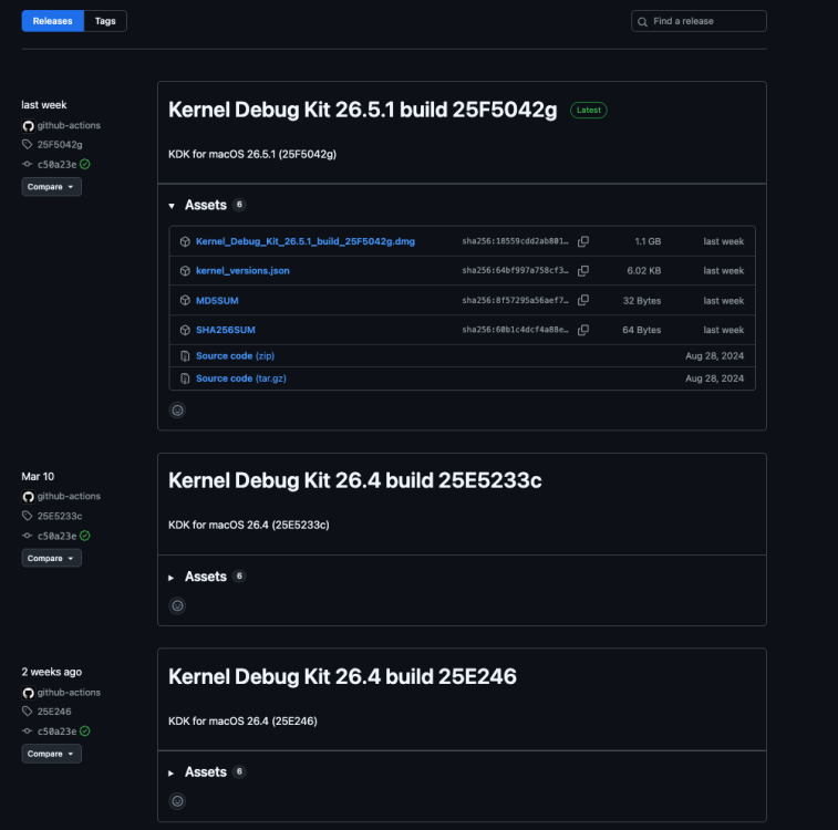

LockDown Posted April 10 Share Posted April 10 2 hours ago, kgp said: New Kernel Debug Kit 26.4.1 build 25E253 available at Apple but not yet available at Dortania. But their releases are identical right? 3 Link to comment https://www.insanelymac.com/forum/topic/362627-release-macos-tahoe-2641/#findComment-2848917 Share on other sites More sharing options...

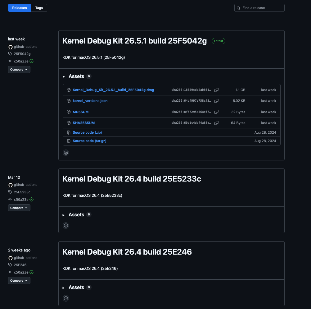

kgp Posted April 10 Share Posted April 10 (edited) 33 minutes ago, LockDown said: But their releases are identical right? I don't know what's up with Dortania. Still missing Kernel Debug Kit 26.4.1 build 25E253 although it is available at Apple. I don't know if KDK 26.4 (build 25E246) and KDK 26.4.1 (build 25E253) are identical. In my opinion, It would not make sense for Apple to release two identical KDKs. There might be minor changes that however seem not to affect OCLP which works flawlessly with KDK 26.4 (build 25E246). Edited April 10 by kgp 4 Link to comment https://www.insanelymac.com/forum/topic/362627-release-macos-tahoe-2641/#findComment-2848918 Share on other sites More sharing options...

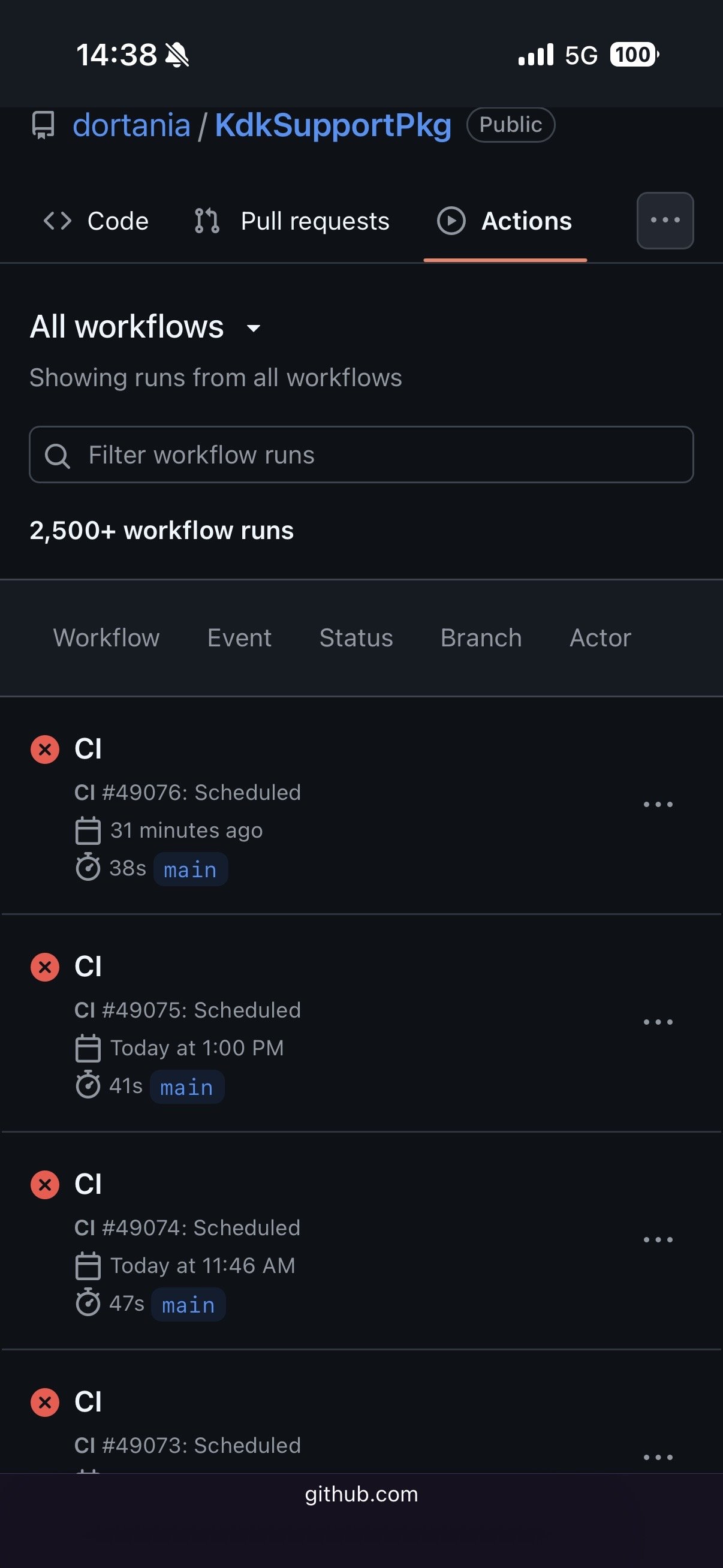

deeveedee Posted April 10 Share Posted April 10 2 hours ago, kgp said: I don't know what's up with Dortania. Still missing Kernel Debug Kit 26.4.1 build 25E253 although it is available at Apple. That is strange. The Dortania KDK mirror is supposed to be automated. Apple KDKs Spoiler 3 Link to comment https://www.insanelymac.com/forum/topic/362627-release-macos-tahoe-2641/#findComment-2848922 Share on other sites More sharing options...
kgp Posted April 10 Share Posted April 10 (edited) 18 minutes ago, deeveedee said: That is strange. The Dortania KDK mirror is supposed to be automated. Apple KDKs Reveal hidden contents Yes that's strange there. There is KDK 26.4.1 (build 25E253) at Apple but not at dortania. Just checked it again. Edited April 10 by kgp 3 Link to comment https://www.insanelymac.com/forum/topic/362627-release-macos-tahoe-2641/#findComment-2848923 Share on other sites More sharing options...

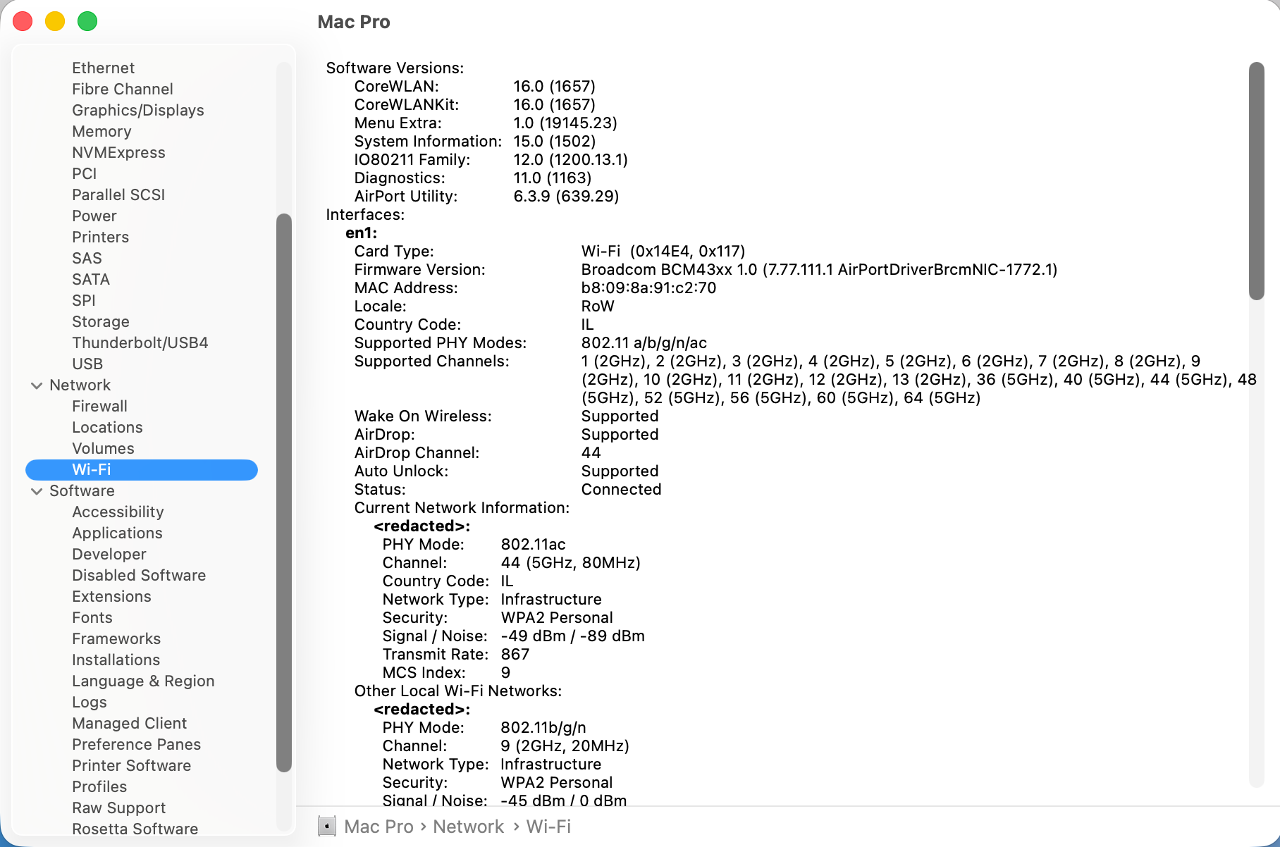

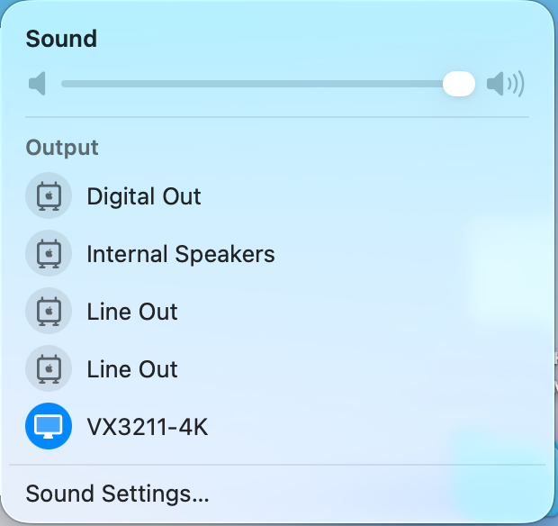

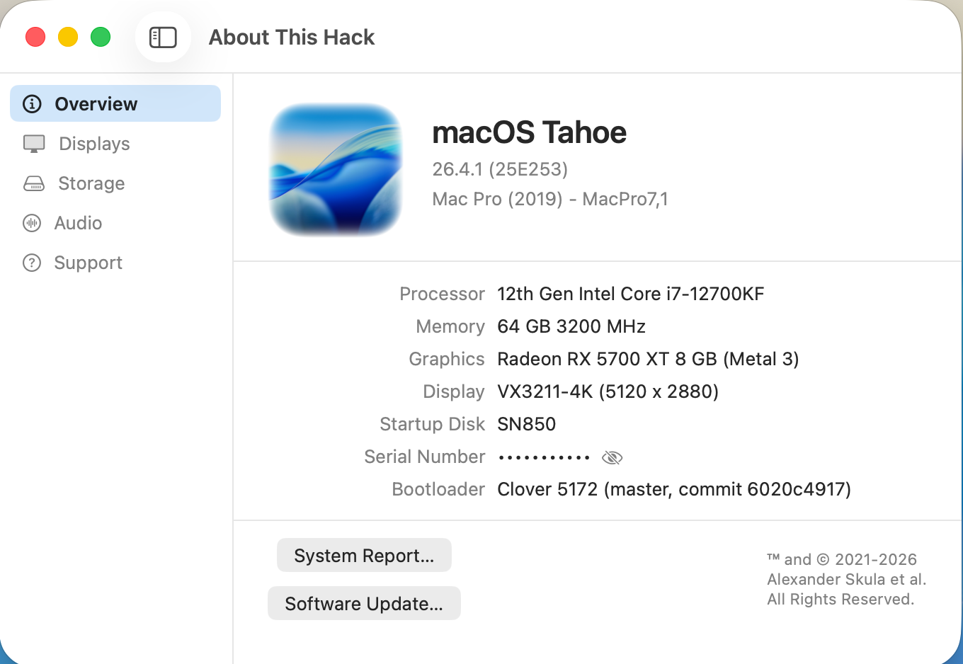

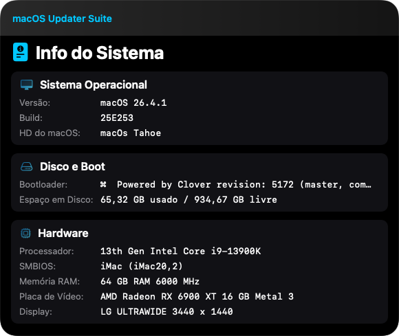

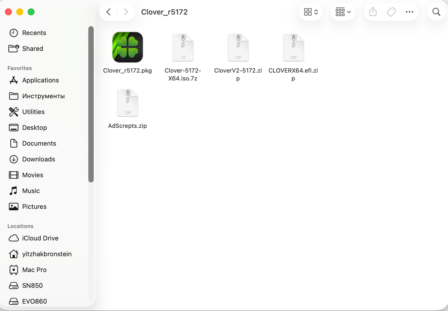

MakAsrock Posted April 10 Share Posted April 10 (edited) The new macOS 26.4.1 (25E253) Powered by Clover revision: 5172 (master, commit 6020c4917) is installed, and the icons have returned. OCLP-Plus 3.1.9 (Tahoe Patch Set) Wi-Fi and sound are working. Kernal_Debug_Kit_26.4.1_build_25E253.dmg is Apple's, not at dortania. Edited April 10 by MakAsrock 3 Link to comment https://www.insanelymac.com/forum/topic/362627-release-macos-tahoe-2641/#findComment-2848924 Share on other sites More sharing options...

arsradu Posted April 10 Share Posted April 10 (edited) Oook... So, MacOS update went seamlessly (as opposed to the installation I tried a couple days ago). :)) Problem: there is no KDK from Dortania. Aaand, apparently, even if you manually download and install the one from Apple, and try to patch with OCLP-Mod, and even though it says it found KDK 26.4.1, I now seem to be in some sort of boot loop, most likely caused by the patches. Is OCLP-Mod not able to use the previously downloaded KDK? If not, maybe this could be implemented... Something like: Browse KDKs (if you already downloaded it). I'm not quite sure what/how is OCLP-Mod usually using those KDKs, but, it feels like an option to use an existing KDK should probably be a good idea. Just saying. So, I guess I'll have to revert for now. But...do you guys know of a way to use root patches with a previously installed KDK? It sounds like it should work, but, in my experience so far, it looks like it doesn't. Edited April 10 by arsradu 1 1 Link to comment https://www.insanelymac.com/forum/topic/362627-release-macos-tahoe-2641/#findComment-2848928 Share on other sites More sharing options...
kgp Posted April 10 Share Posted April 10 26 minutes ago, arsradu said: Oook... So, MacOS update went seamlessly (as opposed to the installation I tried a couple days ago). :)) Problem: there is no KDK from Dortania. Aaand, apparently, even if you manually download and install the one from Apple, and try to patch with OCLP-Mod, and even though it says it found KDK 26.4.1, I now seem to be in some sort of boot loop, most likely caused by the patches. Is OCLP-Mod not able to use the previously downloaded KDK? If not, maybe this could be implemented... Something like: Browse KDKs (if you already downloaded it). I'm not quite sure what/how is OCLP-Mod usually using those KDKs, but, it feels like an option to use an existing KDK should probably be a good idea. Just saying. So, I guess I'll have to revert for now. But...do you guys know of a way to use root patches with a previously installed KDK? It sounds like it should work, but, in my experience so far, it looks like it doesn't. Currently OCLP 3.0.0 Nightly automatically takes KDK of 26.4 and still works flawlessly. 4 Link to comment https://www.insanelymac.com/forum/topic/362627-release-macos-tahoe-2641/#findComment-2848929 Share on other sites More sharing options...
arsradu Posted April 10 Share Posted April 10 21 minutes ago, kgp said: Currently OCLP 3.0.0 Nightly automatically takes KDK of 26.4 and still works flawlessly. So sound works with KDK 26.4 on Tahoe 26.4.1...? Did it get it right? 2 Link to comment https://www.insanelymac.com/forum/topic/362627-release-macos-tahoe-2641/#findComment-2848930 Share on other sites More sharing options...
MakAsrock Posted April 10 Share Posted April 10 (edited) 1 hour ago, arsradu said: Oook... So, MacOS update went seamlessly (as opposed to the installation I tried a couple days ago). :)) Problem: there is no KDK from Dortania. Aaand, apparently, even if you manually download and install the one from Apple, and try to patch with OCLP-Mod, and even though it says it found KDK 26.4.1, I now seem to be in some sort of boot loop, most likely caused by the patches. Is OCLP-Mod not able to use the previously downloaded KDK? If not, maybe this could be implemented... Something like: Browse KDKs (if you already downloaded it). I'm not quite sure what/how is OCLP-Mod usually using those KDKs, but, it feels like an option to use an existing KDK should probably be a good idea. Just saying. So, I guess I'll have to revert for now. But...do you guys know of a way to use root patches with a previously installed KDK? It sounds like it should work, but, in my experience so far, it looks like it doesn't. Currently OCLP-Plus 3.1.9 (Tahoe Patch Set) Automatically uses Kernal_Debug_Kit_26.4.1_build_25E253 wi-fi and sound works flawlessly. Edited April 10 by MakAsrock 3 Link to comment https://www.insanelymac.com/forum/topic/362627-release-macos-tahoe-2641/#findComment-2848931 Share on other sites More sharing options...
kgp Posted April 10 Share Posted April 10 (edited) 24 minutes ago, arsradu said: So sound works with KDK 26.4 on Tahoe 26.4.1...? Did it get it right? Yes.. Sound, Wi-Fi and AWDL! 3 minutes ago, MakAsrock said: Currently OCLP-Plus 3.1.9 (Tahoe Patch Set) Automatically uses Kernal_Debug_Kit_26.4.1_build_25E253 and works flawlessly. Did you change the source in the code or is the KDK for 26.4.1 now available in the Dortania repository? I am currently not at home and writing from my mobile phone.. Edited April 10 by kgp 3 Link to comment https://www.insanelymac.com/forum/topic/362627-release-macos-tahoe-2641/#findComment-2848932 Share on other sites More sharing options...
MakAsrock Posted April 10 Share Posted April 10 (edited) 7 minutes ago, kgp said: Yes.. Sound, Wi-Fi and AWDL! Did you change the source in the code or is the KDK for 26.4.1 now available in the Dortania repository? I am currently not at home and writing from my mobile phone.. I just downloaded it from Apple and Currently OCLP-Plus 3.1.9 (Tahoe Patch Set) does not install it forcibly. Edited April 10 by MakAsrock 2 Link to comment https://www.insanelymac.com/forum/topic/362627-release-macos-tahoe-2641/#findComment-2848933 Share on other sites More sharing options...
kgp Posted April 10 Share Posted April 10 4 minutes ago, MakAsrock said: I just downloaded it from Apple. ?? Does OCLP Plus now directly download the KDK from Apple or did you download the KDK manually? 3 Link to comment https://www.insanelymac.com/forum/topic/362627-release-macos-tahoe-2641/#findComment-2848934 Share on other sites More sharing options...
