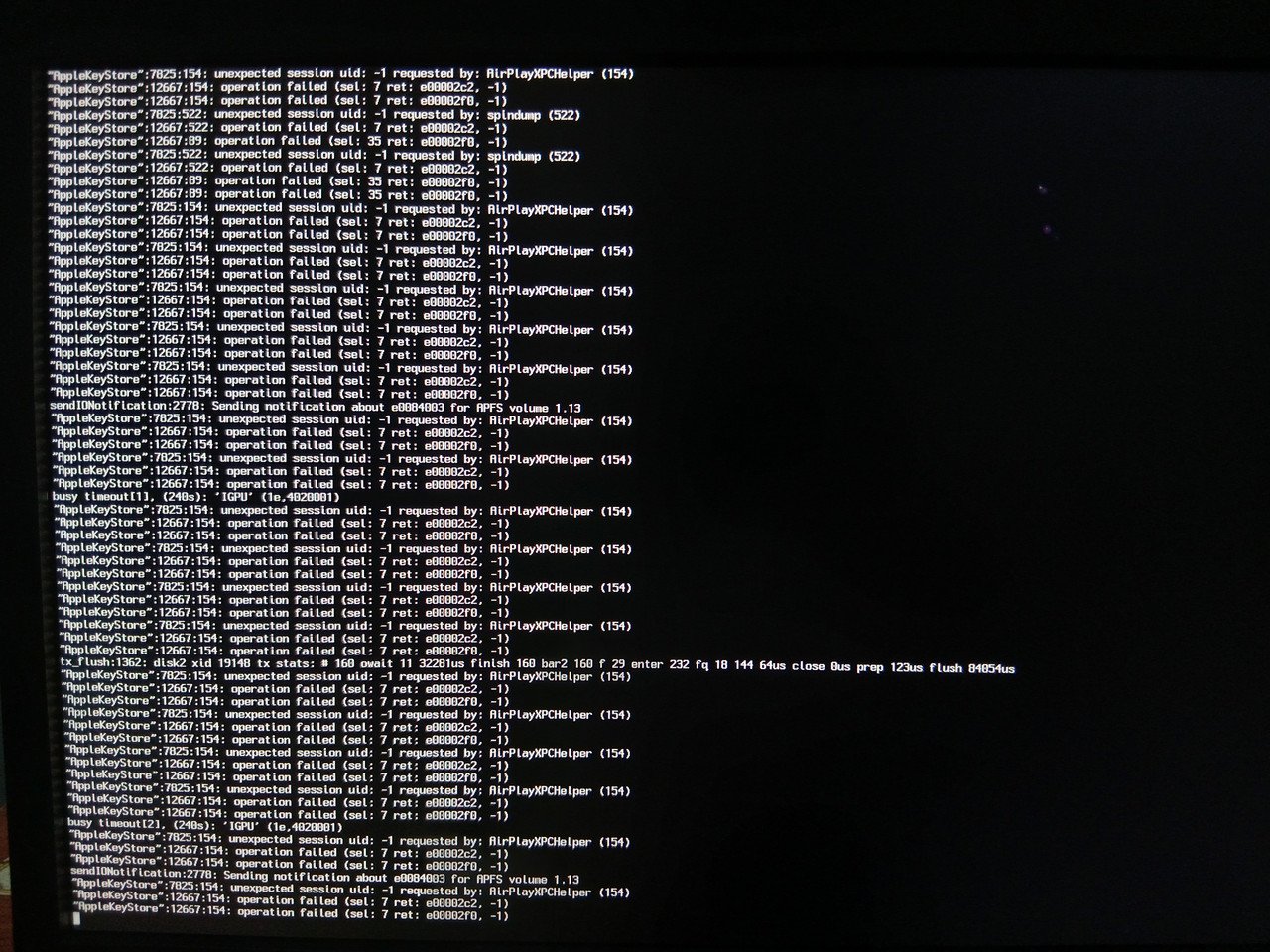

cipiter Posted November 26, 2025 Share Posted November 26, 2025 (edited) Hi everyone, as the title states i'm having graphics stuck at 7MB in sequoia i recently installed it after having a hard time with Tahoe now the issue is even tho i have an RX580 but macOS is not picking it but the monitor is still connected to the GPU with DP Cable, i created my EFI with OC Simplify and it worked perfectly but now i'm stuck with graphics issue, i have attached my EFI folder, thanks. PC Specification: CPU: Intel Core i7-4790 GPU: AMD Radeon RX580 (8GB Variant) Motherboard: Gigabyte H81M-S2V Memory: 16GB DDR3 Storage: 160GB Samsung HDD Ethernet: RTL8111 (Realtek GbE LAN chip (10/100/1000 Mbit) Audio: ALC887 (Realtek® ALC887 codec) I/0 Ports: 2 x USB 3.0/2.0 ports on the back panel OS: Sequoia 15.7.2 efi.zip Edited November 26, 2025 by cipiter Link to comment https://www.insanelymac.com/forum/topic/362022-display-7-mb-issue-on-rx580-in-sequoia-1572/ Share on other sites More sharing options...

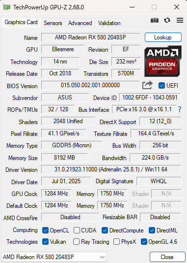

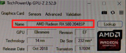

strangeron Posted November 26, 2025 Share Posted November 26, 2025 (edited) If an RX580 isn't working on a Mac, my first thought is that this card is an RX 580 2048SP. The only cards that are not supported are the RX 580 2048SP and RX 590 GME. Check first. If so, the problem can still be solved. Edited November 26, 2025 by strangeron 3 2 Link to comment https://www.insanelymac.com/forum/topic/362022-display-7-mb-issue-on-rx580-in-sequoia-1572/#findComment-2844235 Share on other sites More sharing options...
cipiter Posted November 26, 2025 Author Share Posted November 26, 2025 Just now, strangeron said: If an RX580 isn't working on a Mac, my first thought is that this card is an RX 580 2048SP. The only cards that are not supported are the RX 580 2048SP and RX 590 GME. Check first. Thanks i just checked as you can see in the ScreenShot: So is it possible that i keep my main GPU plugged in but use my iGPU for macOS?, If so can you please recommend a guide thats easy to follow and isn't confusing, thanks. 1 Link to comment https://www.insanelymac.com/forum/topic/362022-display-7-mb-issue-on-rx580-in-sequoia-1572/#findComment-2844236 Share on other sites More sharing options...

strangeron Posted November 26, 2025 Share Posted November 26, 2025 19 minutes ago, cipiter said: So is it possible that i keep my main GPU plugged in but use my iGPU for macOS? HD Graphics 4600 can be run on Sequoia, but OCLP is required. By the way, the RX580 2048SP can be flashed with a correct RX 570 vBios. And it works. 3 Link to comment https://www.insanelymac.com/forum/topic/362022-display-7-mb-issue-on-rx580-in-sequoia-1572/#findComment-2844240 Share on other sites More sharing options...

cipiter Posted November 27, 2025 Author Share Posted November 27, 2025 2 minutes ago, Leo Mauti said: It should be for the card oh ok, but will it work for a fake RX580? since i just discovered that the GPU is Chinese fake sadly. Link to comment https://www.insanelymac.com/forum/topic/362022-display-7-mb-issue-on-rx580-in-sequoia-1572/#findComment-2844269 Share on other sites More sharing options...
