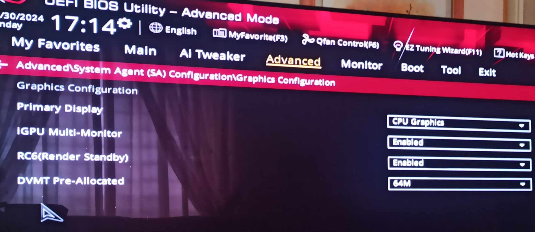

Montelli Posted July 1, 2024 Author Share Posted July 1, 2024 (edited) 36 minutes ago, deeveedee said: @Montelli My solution for the HP EliteDesk 800 G4 Mini with Radeon RX560x shows that you can use both iGPU and dGPU for displays. I don't have your motherboard, so you'll need to experiment. If my results are any indication of what you should expect then you would need to do the following: Choose the appropriate frame buffer for your iGPU (not headless) Make sure that your iGPU is enabled in BIOS You may need to set your iGPU as the boot display in BIOS I've set it up like this in BIOS, it's right? Do I just need to set up buffer now? How do I set it up? Thank you @deeveedee Edited July 1, 2024 by Montelli Link to comment https://www.insanelymac.com/forum/topic/359471-help-upgrade-monterey-to-ventura-or-sonoma/page/3/#findComment-2822095 Share on other sites More sharing options...

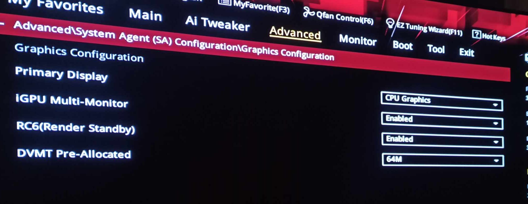

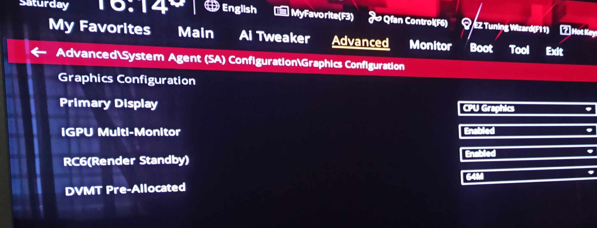

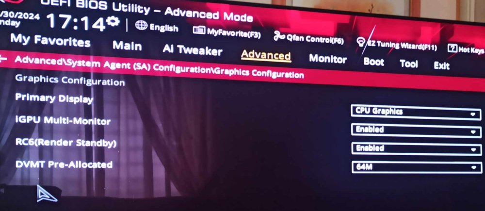

Montelli Posted July 6, 2024 Author Share Posted July 6, 2024 (edited) @MaLd0n I can't understand why, but PC starts with internal Gpu and not with AMD, so I suppose that hardware acceleration is not working either... I tried again to delete EFI folder and paste one you created for me and I reset the NVRAM, but still nothing... Attaching iReg report and these are current bios settings: iMac di Montelli.ioreg I'm waiting for your response Thank you Edited July 6, 2024 by Montelli Link to comment https://www.insanelymac.com/forum/topic/359471-help-upgrade-monterey-to-ventura-or-sonoma/page/3/#findComment-2822304 Share on other sites More sharing options...
miliuco Posted July 6, 2024 Share Posted July 6, 2024 @Montelli You have CPU graphics as primary display, so it boots with this GPU and not the AMD. Try changing this. Disabling iGPU Multi-Monitor can help too. 1 Link to comment https://www.insanelymac.com/forum/topic/359471-help-upgrade-monterey-to-ventura-or-sonoma/page/3/#findComment-2822308 Share on other sites More sharing options...
Montelli Posted July 7, 2024 Author Share Posted July 7, 2024 (edited) Ok, AMD works.. and I had to use a combination 🫠... I entered the BIOS with the HDMI connected to iGPU and then I set primary display to PCIE and before saving and restarting I connected monitor to AMD displayPort. This way, upon reboot, AMD and macOS started correctly. @MaLd0n Now, which AMD GPU do you recommend for using 4 monitors? Could I use AMD RX 580 or there is a list of compatible GPU?? Thank you Edited July 7, 2024 by Montelli Link to comment https://www.insanelymac.com/forum/topic/359471-help-upgrade-monterey-to-ventura-or-sonoma/page/3/#findComment-2822353 Share on other sites More sharing options...
