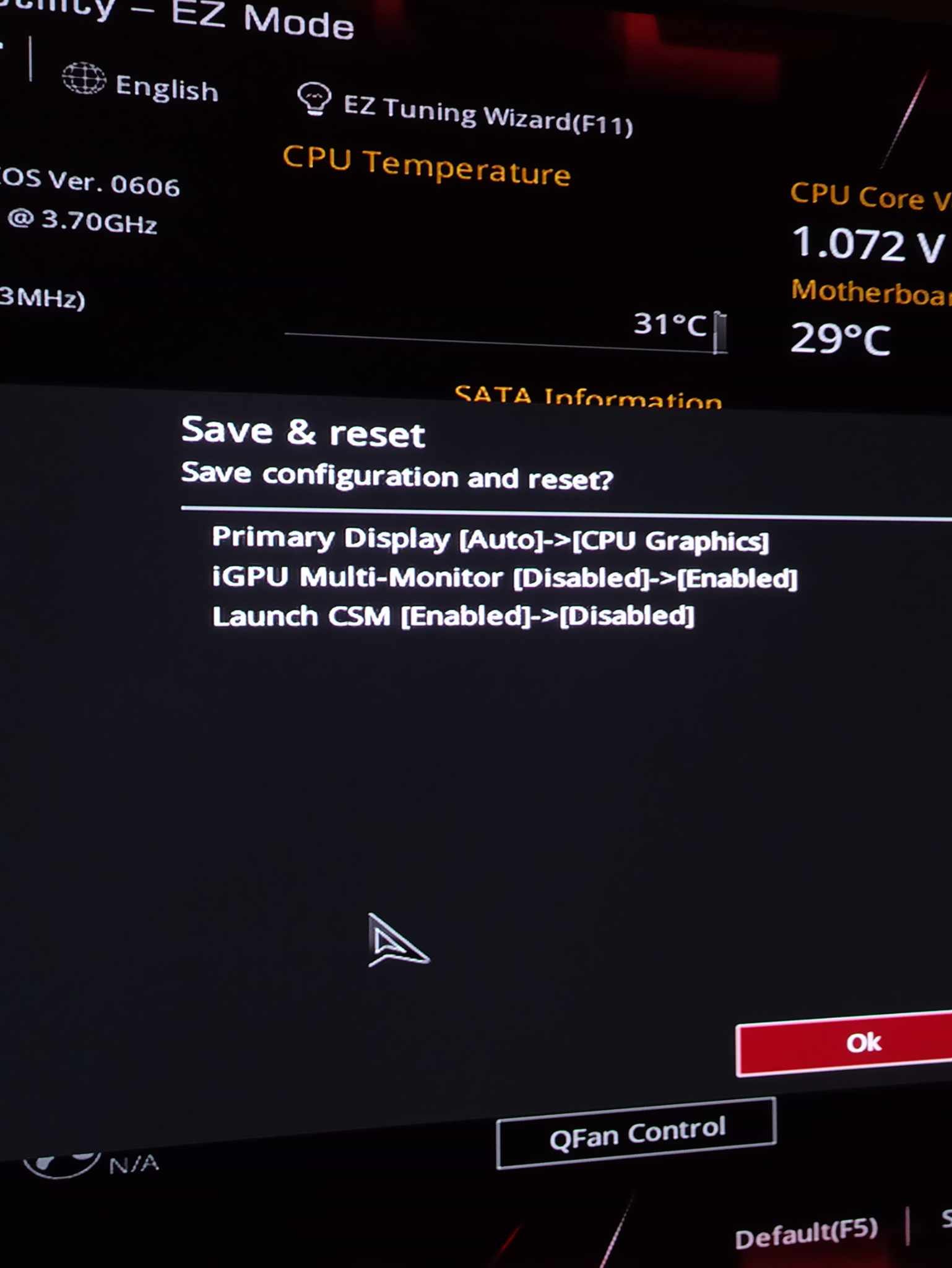

MaLd0n Posted June 14, 2024 Share Posted June 14, 2024 CSM disable and monitors on AMD GPU Link to comment https://www.insanelymac.com/forum/topic/359471-help-upgrade-monterey-to-ventura-or-sonoma/page/2/#findComment-2821170 Share on other sites More sharing options...

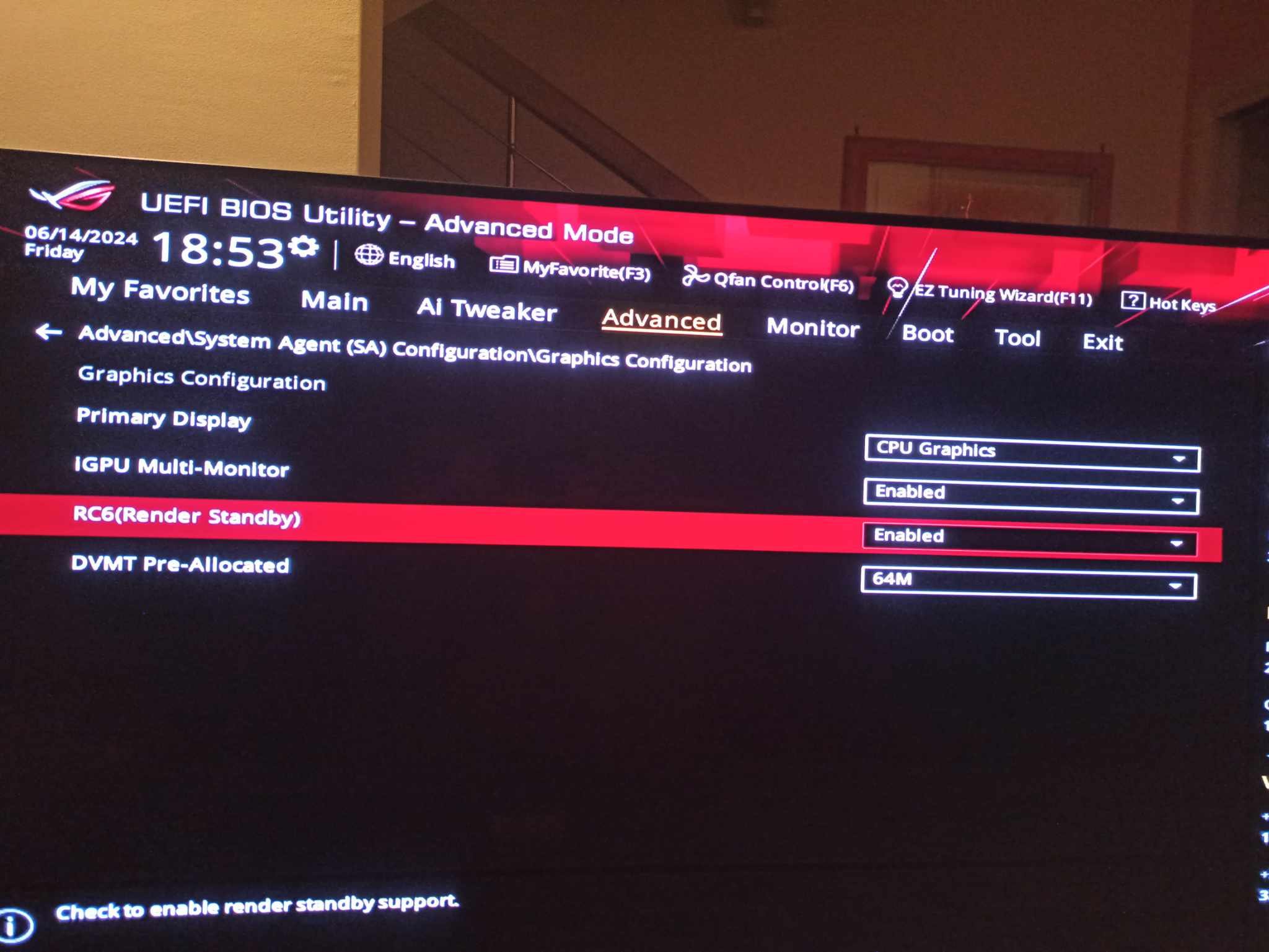

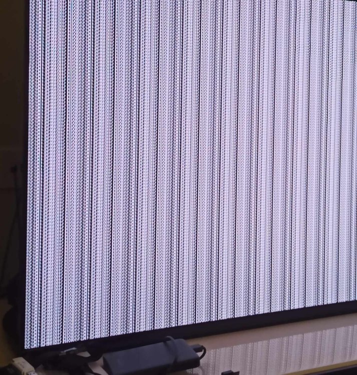

Montelli Posted June 14, 2024 Author Share Posted June 14, 2024 (edited) 4 hours ago, MaLd0n said: CSM disable and monitors on AMD GPU Thanks for your availability, I changed smbios and followed what you told me: it's right ? maybe I haven't enabled iGPU hardware acceleration, where can I find it...🤔 ...Anyway HDMI and DisplayPort on the AMD GPU still doesn't work, how can fix it? Thank You Edited June 14, 2024 by Montelli Link to comment https://www.insanelymac.com/forum/topic/359471-help-upgrade-monterey-to-ventura-or-sonoma/page/2/#findComment-2821180 Share on other sites More sharing options...

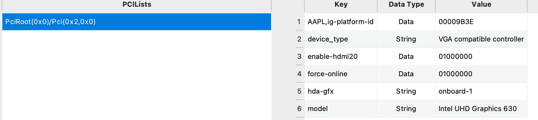

MaLd0n Posted June 21, 2024 Share Posted June 21, 2024 4 minutes ago, Montelli said: Ok thanks @MaLd0n. I'm attaching report and look forward to your response IGPU and DGPU need to work together Don't inject any properties for IGPU, just enable. Link to comment https://www.insanelymac.com/forum/topic/359471-help-upgrade-monterey-to-ventura-or-sonoma/page/2/#findComment-2821592 Share on other sites More sharing options...
Montelli Posted June 21, 2024 Author Share Posted June 21, 2024 38 minutes ago, MaLd0n said: IGPU and DGPU need to work together Don't inject any properties for IGPU, just enable. Should I delete this? Link to comment https://www.insanelymac.com/forum/topic/359471-help-upgrade-monterey-to-ventura-or-sonoma/page/2/#findComment-2821593 Share on other sites More sharing options...

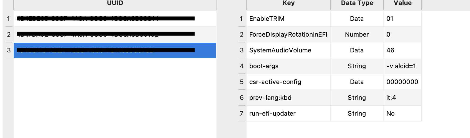

MaLd0n Posted June 21, 2024 Share Posted June 21, 2024 Yes and -wegnoegpu too All monitors is connected on DGPU Link to comment https://www.insanelymac.com/forum/topic/359471-help-upgrade-monterey-to-ventura-or-sonoma/page/2/#findComment-2821594 Share on other sites More sharing options...
Montelli Posted June 21, 2024 Author Share Posted June 21, 2024 (edited) 6 minutes ago, MaLd0n said: Sì e anche -wegnoegpu Tutti i monitor sono collegati alla DGPU Where do I find this: -wegnoegpu ? Edited June 21, 2024 by Montelli Link to comment https://www.insanelymac.com/forum/topic/359471-help-upgrade-monterey-to-ventura-or-sonoma/page/2/#findComment-2821595 Share on other sites More sharing options...
MaLd0n Posted June 21, 2024 Share Posted June 21, 2024 NVRAM / Bootargs, remove if have Link to comment https://www.insanelymac.com/forum/topic/359471-help-upgrade-monterey-to-ventura-or-sonoma/page/2/#findComment-2821596 Share on other sites More sharing options...

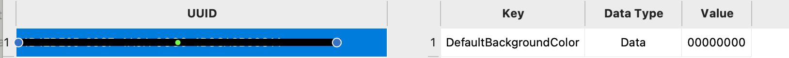

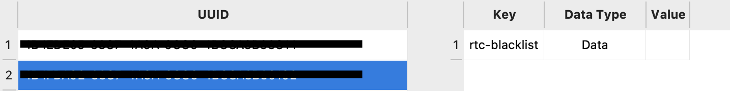

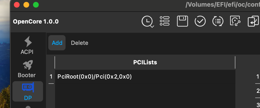

Montelli Posted June 22, 2024 Author Share Posted June 22, 2024 @MaLd0n unfortunately nothing yet... what else do I need to do? Meanwhile I deleted this: while bootarg is not there: Link to comment https://www.insanelymac.com/forum/topic/359471-help-upgrade-monterey-to-ventura-or-sonoma/page/2/#findComment-2821605 Share on other sites More sharing options...

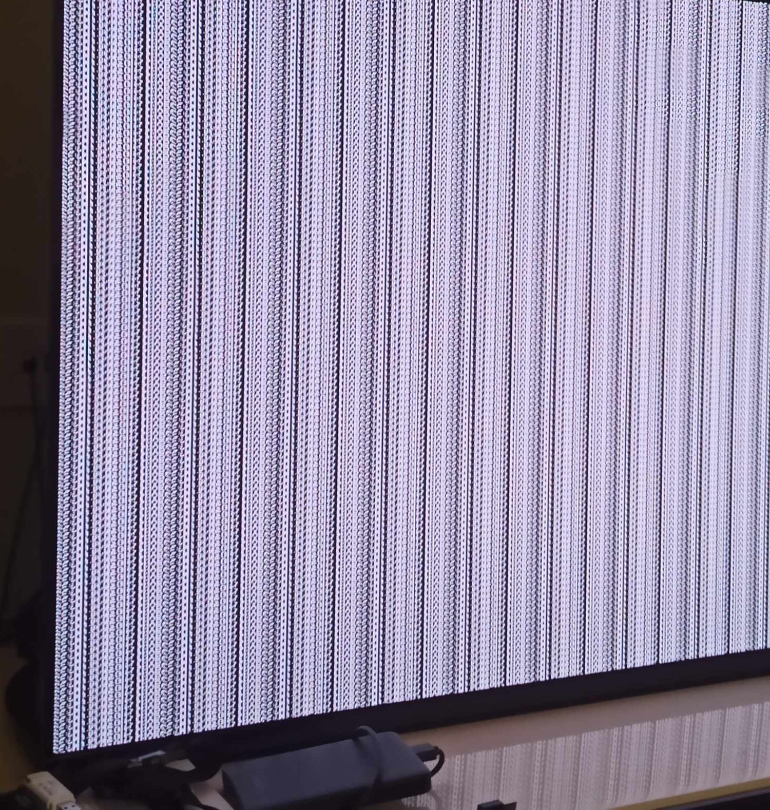

Montelli Posted June 30, 2024 Author Share Posted June 30, 2024 33 minutes ago, MaLd0n said: EFI Montelli.zip -Delete old EFI folder and paste new. Don't use merge files -Don't use Drag and Drop into EFI partition. Use Copy/Paste instead -Reset NVRAM one time - with OpenCore use entry "Reset Nvram" / with Clover use F11 key on boot screen There is some error, when I start macOS Sonoma screen scrolls and then restarts pc Link to comment https://www.insanelymac.com/forum/topic/359471-help-upgrade-monterey-to-ventura-or-sonoma/page/2/#findComment-2822062 Share on other sites More sharing options...
MaLd0n Posted June 30, 2024 Share Posted June 30, 2024 U need to use ur monitor in AMD GPU only. IGPU stay only for hardware accel, don't connect any monitor on IGPU. Link to comment https://www.insanelymac.com/forum/topic/359471-help-upgrade-monterey-to-ventura-or-sonoma/page/2/#findComment-2822064 Share on other sites More sharing options...
Montelli Posted June 30, 2024 Author Share Posted June 30, 2024 (edited) 25 minutes ago, MaLd0n said: U need to use ur monitor in AMD GPU only. IGPU stay only for hardware accel, don't connect any monitor on IGPU. ok now macOS starts with hdmi and dp ports of AMD gpu, but my initial question was, how can I use 4 displays at same time as an extension of main screen ? now hdmi and dp ports of integrated gpu doesn't work... Edited June 30, 2024 by Montelli Link to comment https://www.insanelymac.com/forum/topic/359471-help-upgrade-monterey-to-ventura-or-sonoma/page/2/#findComment-2822067 Share on other sites More sharing options...
