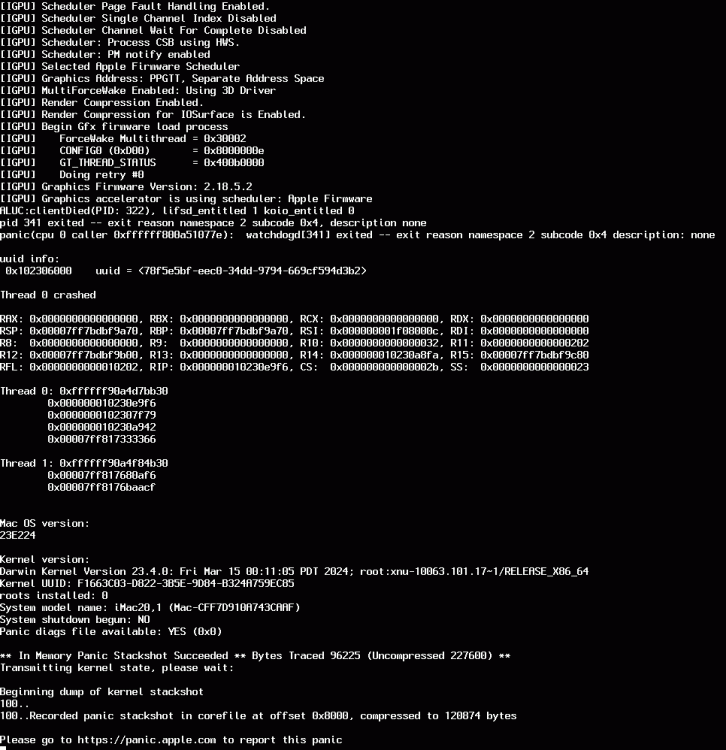

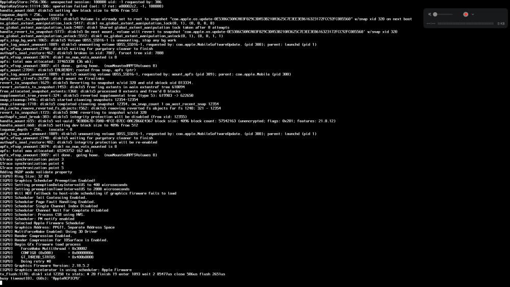

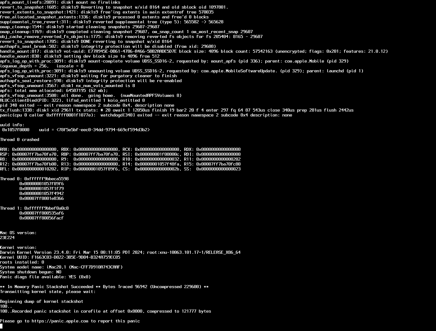

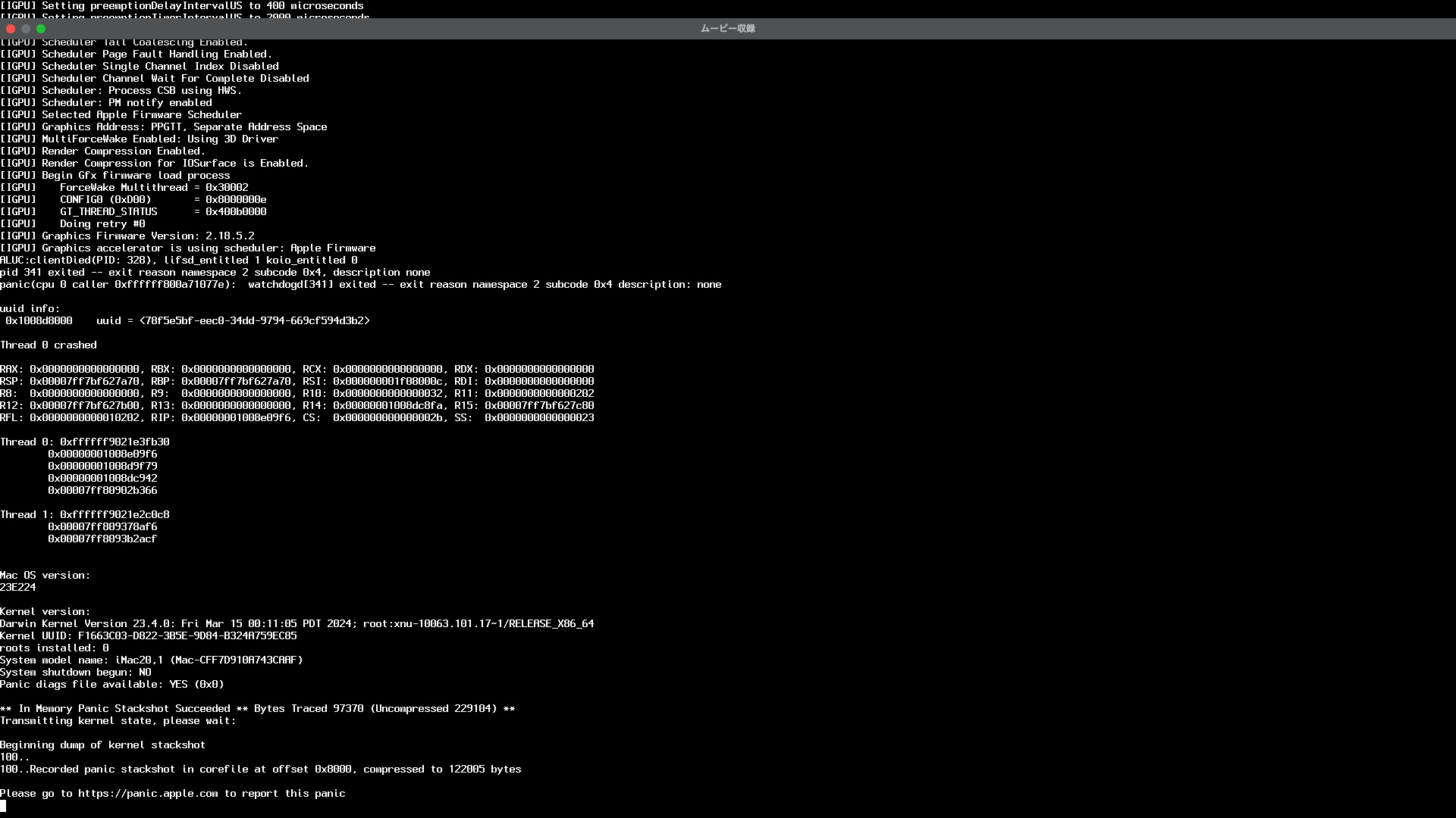

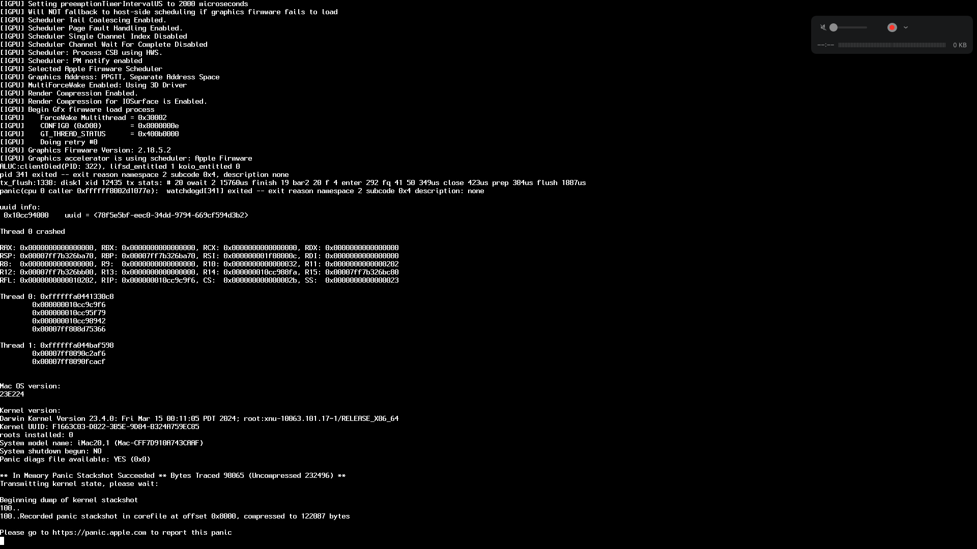

vtec100000000rpm Posted April 30 Share Posted April 30 (edited) I'm struggling with KP. Sonoma + Clover r5158 -> Kernel Panic Sonoma + Clover r5158 -igfxvesa -> Kernel Panic Sonoma + Clover r5158 -wegoff -> Kernel Panic Monterey + Clover r5158 -> busy timeout Sonoma + OpenCore -> boot Any Idea? I want to boot with Clover. Thanks in advance. ASUS PRIME H410M-A + i3-10105 + UHD630 https://www.asus.com/motherboards-components/motherboards/prime/prime-h410m-a/ H410M-A.zip Edited April 30 by vtec100000000rpm Link to comment Share on other sites More sharing options...

Slice Posted May 1 Share Posted May 1 Show preboot.log obtained by F2 in Clover GUI. We might see what is wrong. 1 Link to comment Share on other sites More sharing options...
vtec100000000rpm Posted May 2 Author Share Posted May 2 14 hours ago, Slice said: Show preboot.log obtained by F2 in Clover GUI. We might see what is wrong. Thank you for your reply. This log is with UHD630. I'll put the other ( with GeForce 630) later. preboot.log Link to comment Share on other sites More sharing options...
vtec100000000rpm Posted May 2 Author Share Posted May 2 config(add_some_boot-args).plist preboot(UHD630+Kepler).log H410M-A(OpenCore).ioreg.zip Link to comment Share on other sites More sharing options...
Slice Posted May 2 Share Posted May 2 2 hours ago, vtec100000000rpm said: config(add_some_boot-args).plist 21.09 kB · 1 download preboot(UHD630+Kepler).log 25.74 kB · 0 downloads H410M-A(OpenCore).ioreg.zip 683.71 kB · 1 download VirtualSMC is not compatible with Clover. Use FakeSMC instead. Link to comment Share on other sites More sharing options...

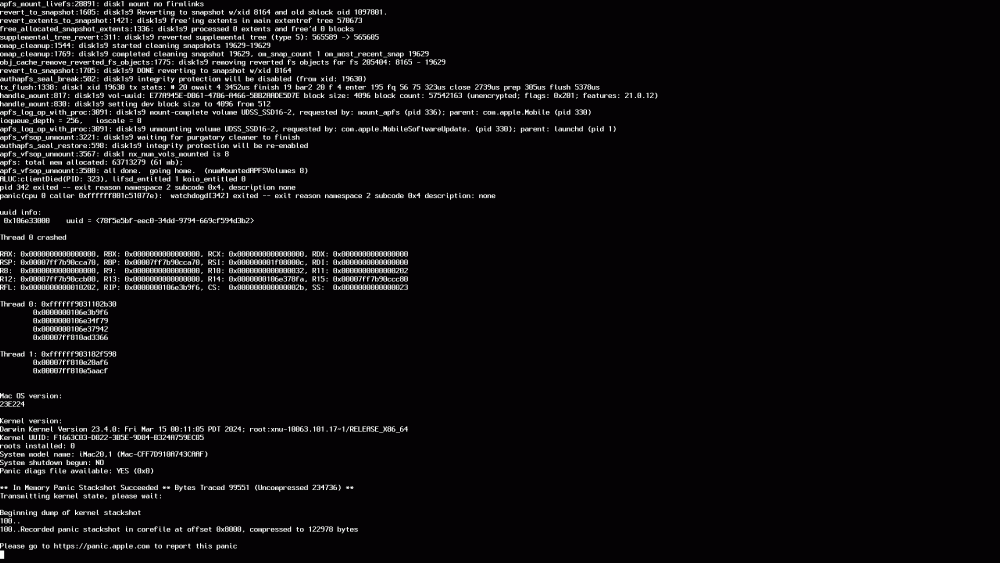

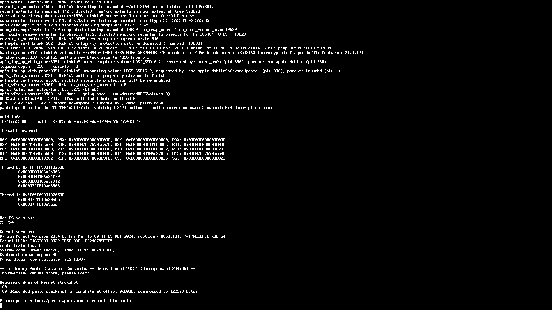

vtec100000000rpm Posted May 3 Author Share Posted May 3 21 hours ago, Slice said: VirtualSMC is not compatible with Clover. Use FakeSMC instead. Added FakeSMC.kext and removed VirtualSMC.kext. But didn't work.... (T_T) config.plist drivers.zip ACPI.zip preboot.log Link to comment Share on other sites More sharing options...
Slice Posted May 3 Share Posted May 3 You have Graphics->Inject->ATI=NO OK, but I recommend to do same for Nvidia and Intel because default values are YES. Why you set device-id as <C59B0000>? Your native 9BC8 is supported by macOS Sonoma at least. And I don't know about ig-platform-id for your card. You may choose between 0x3EA50009 (mobile, 3 connectors, no fbmem, 58 MB) 0x3E920009 (mobile, 3 connectors, no fbmem, 58 MB) 0x3E9B0009 (mobile, 3 connectors, no fbmem, 58 MB) 0x3EA50000 (mobile, 3 connectors, no fbmem, 58 MB) 0x3E920000 (mobile, 3 connectors, no fbmem, 58 MB) 0x3E000000 (mobile, 3 connectors, no fbmem, 58 MB) 0x3E9B0000 (mobile, 3 connectors, no fbmem, 58 MB) 0x3EA50004 (mobile, 3 connectors, no fbmem, 58 MB) 0x3EA50005 (mobile, 3 connectors, no fbmem, 58 MB) 0x3EA60005 (mobile, 3 connectors, no fbmem, 58 MB) 0x3E9B0006 (mobile, 1 connectors, no fbmem, 39 MB) 0x3E9B0008 (mobile, 1 connectors, no fbmem, 58 MB) 0x3E9B0007 (desktop, 3 connectors, no fbmem, 58 MB) 0x3E920003 (desktop, 0 connectors, no fbmem, 1 MB) 0x3E910003 (desktop, 0 connectors, no fbmem, 1 MB) 0x3E980003 (desktop, 0 connectors, no fbmem, 1 MB) 0x9BC80003 (desktop, 0 connectors, no fbmem, 1 MB) 0x9BC50003 (desktop, 0 connectors, no fbmem, 1 MB) 0x9BC40003 (desktop, 0 connectors, no fbmem, 1 MB) Link to comment Share on other sites More sharing options...
vtec100000000rpm Posted May 4 Author Share Posted May 4 On 5/4/2024 at 2:11 AM, Slice said: You have Graphics->Inject->ATI=NO OK, but I recommend to do same for Nvidia and Intel because default values are YES. Why you set device-id as <C59B0000>? Your native 9BC8 is supported by macOS Sonoma at least. And I don't know about ig-platform-id for your card. You may choose between 0x3EA50009 (mobile, 3 connectors, no fbmem, 58 MB) 0x3E920009 (mobile, 3 connectors, no fbmem, 58 MB) 0x3E9B0009 (mobile, 3 connectors, no fbmem, 58 MB) 0x3EA50000 (mobile, 3 connectors, no fbmem, 58 MB) 0x3E920000 (mobile, 3 connectors, no fbmem, 58 MB) 0x3E000000 (mobile, 3 connectors, no fbmem, 58 MB) 0x3E9B0000 (mobile, 3 connectors, no fbmem, 58 MB) 0x3EA50004 (mobile, 3 connectors, no fbmem, 58 MB) 0x3EA50005 (mobile, 3 connectors, no fbmem, 58 MB) 0x3EA60005 (mobile, 3 connectors, no fbmem, 58 MB) 0x3E9B0006 (mobile, 1 connectors, no fbmem, 39 MB) 0x3E9B0008 (mobile, 1 connectors, no fbmem, 58 MB) 0x3E9B0007 (desktop, 3 connectors, no fbmem, 58 MB) 0x3E920003 (desktop, 0 connectors, no fbmem, 1 MB) 0x3E910003 (desktop, 0 connectors, no fbmem, 1 MB) 0x3E980003 (desktop, 0 connectors, no fbmem, 1 MB) 0x9BC80003 (desktop, 0 connectors, no fbmem, 1 MB) 0x9BC50003 (desktop, 0 connectors, no fbmem, 1 MB) 0x9BC40003 (desktop, 0 connectors, no fbmem, 1 MB) Thank you for your reply again and again. I tried, but same KP. Hmm.... config(Inject-NO).plist preboot(UHD630Only).log preboot(KeplerOnly).log Link to comment Share on other sites More sharing options...
