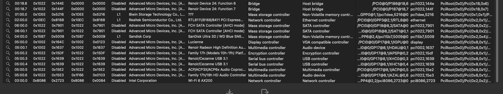

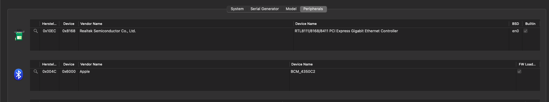

Mona Nur Posted April 26, 2024 Author Share Posted April 26, 2024 (edited) 45 minutes ago, spakk said: @ Mona NurKönnten Sie den EFI-Ordner testen? Wenn ja, was war das Ergebnis? Even with the EFI, no WiFi, everything else works. If I pack the aml files attached to this message into or into my EFI, the WIFI works immediately. Only the two files from an HP laptop come from an EFI found on the Internet. So it doesn't fit my computer In the hackintool it is displayed but always as Disabled. If I enter the wrong 2 data, WiFi works and then L1 is there too DSDT-S3.aml SSDT-EC.aml Edited April 26, 2024 by Mona Nur Quote Link to comment https://www.insanelymac.com/forum/topic/359231-mini-pc-amd-ryzen-7-5700u-wlan-problem/#findComment-2819412 Share on other sites More sharing options...
Mona Nur Posted April 28, 2024 Author Share Posted April 28, 2024 Does anyone else have an idea ? Everything is correct and the correct kexts are installed but WIFI doesn't start. The joke is I take the attached files from an HP laptop from the network. My WIFI works. I even made a video of it. https://www.transfernow.net/dl/20240428d8yTbTtb On 4/26/2024 at 2:22 PM, spakk said: @ Mona NurKönnten Sie den EFI-Ordner testen? Wenn ja, was war das Ergebnis? Even with the EFI, no WiFi, everything else works. If I pack the aml files attached to this message into or into my EFI, the WIFI works immediately. Only the two files from an HP laptop come from an EFI found on the Internet. So it doesn't fit my computer DSDT-S3.aml SSDT-EC.aml Quote Link to comment https://www.insanelymac.com/forum/topic/359231-mini-pc-amd-ryzen-7-5700u-wlan-problem/#findComment-2819444 Share on other sites More sharing options...
