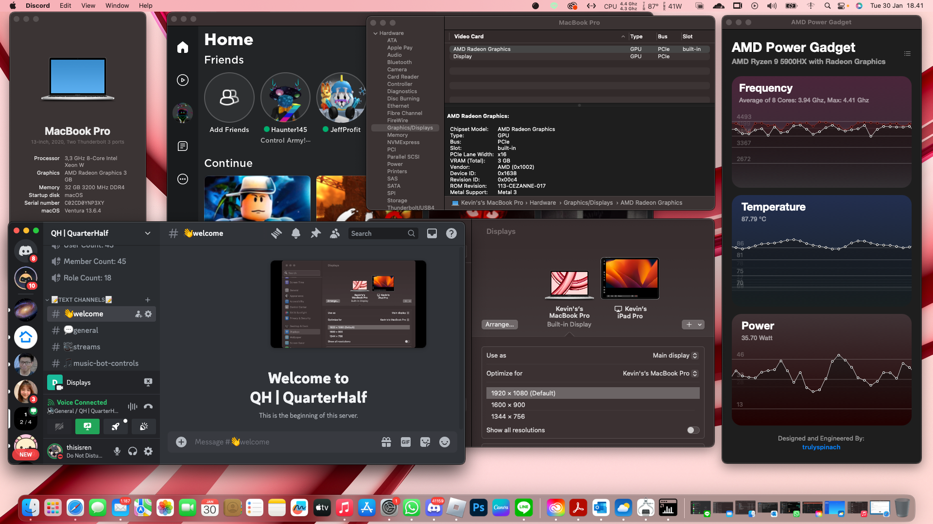

neither Posted January 30, 2024 Share Posted January 30, 2024 (edited) Hello there ! I just wanted to share my build for this particular Asus ROG model and might as well share to people that now AMD iGPUs on a Hackintosh are possible ! General Spec: AMD RYZEN 9 5900HX AMD RADEON VEGA 8 WIFI/BT - MT7921 AUDIO - ALC285 ETHERNET - RTL8111 I haven't really explored but here's what's CLEARLY not working: WIFI BLUETOOTH CONTINUITY-FANCY APPLE ECOSYSTEM FEATURES (SideCar possible, but no sign bcs the wifi card is not supported, it detects my iPad Pro M1 on the displays settings-connected with USB) SOME WORKAROUNDS: UMAF - I SET THE VRAM TO 3 GB Discord voice and screen streams are not possible at first, but thanks to a patch I found on GitHub, it works. I will attach my efi folder without the config here, please do understand what u are doing with your laptop and figure things out yourself. I'm still working on finding kexts for the wifi and I still haven't got to set up the sleep mode for this setup bcs its too much work and I'd rather have this not sleep at all. and maybe I'm gonna change my wifi card to bcm94360ng :)) good luck with ur rig yuHHH EFI 2.zip Edited January 30, 2024 by neither add more details 3 Quote Link to comment https://www.insanelymac.com/forum/topic/358596-hackintosh-working-asus-rog-strix-g513qm-ryzen-9-5900hx-with-vega-booting-on-ventura-136/ Share on other sites More sharing options...

Shaneee Posted April 10, 2024 Share Posted April 10, 2024 43 minutes ago, disneywishe said: Hello, have you found the wifi kext for wifi yet? I've been tinkering around for the past week but still haven't found a suitable solution. As a newbie in this field, I would like to receive advice from you. OP WiFi uses MediaTek which won't work on macOS. You'll need a compatible Broadcom card ( using OCLP if running Sonoma ) Or compatible Intel WiFi using itlwm. Quote Link to comment https://www.insanelymac.com/forum/topic/358596-hackintosh-working-asus-rog-strix-g513qm-ryzen-9-5900hx-with-vega-booting-on-ventura-136/#findComment-2819038 Share on other sites More sharing options...
Slice Posted April 10, 2024 Share Posted April 10, 2024 Or USB WiFi. Quote Link to comment https://www.insanelymac.com/forum/topic/358596-hackintosh-working-asus-rog-strix-g513qm-ryzen-9-5900hx-with-vega-booting-on-ventura-136/#findComment-2819039 Share on other sites More sharing options...
