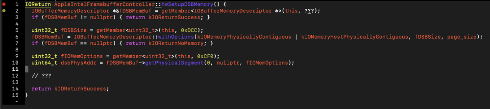

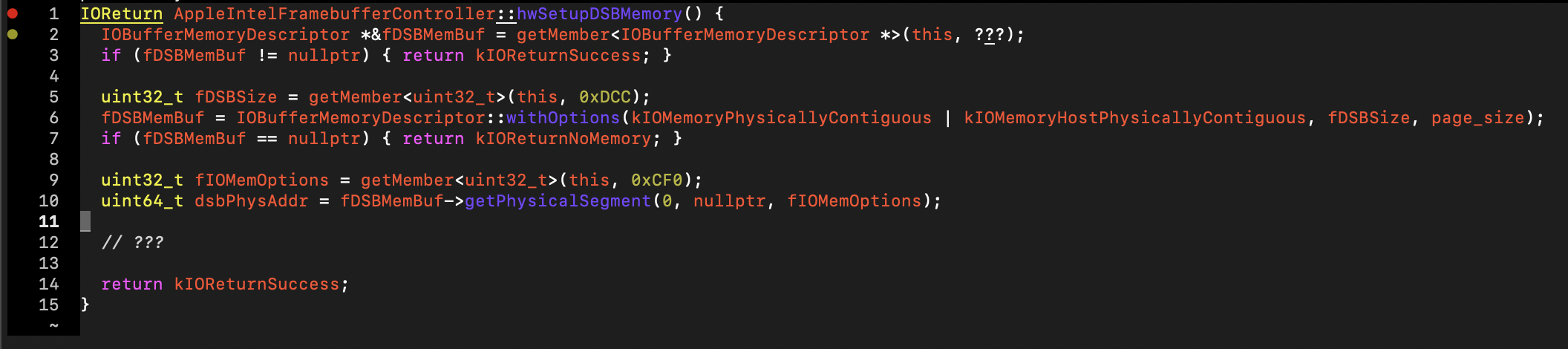

Visual Ehrmanntraut Posted September 11, 2024 Share Posted September 11, 2024 @jalavoui This is what I have so far for hwSetupDSBMemory. Still working on finding out what I need to do afterwards (likely write this to a bunch of registers) Link to comment https://www.insanelymac.com/forum/topic/358305-iris-xe-igpu-on-tiger-lake-successfully-loaded-icllp-frambuffer-and-vram-also-recognizes-1536mb-however-some-issues/page/18/#findComment-2825165 Share on other sites More sharing options...
Visual Ehrmanntraut Posted September 11, 2024 Share Posted September 11, 2024 (edited) Actually no, I think this is likely wrong. Edited September 11, 2024 by Visual Ehrmanntraut Link to comment https://www.insanelymac.com/forum/topic/358305-iris-xe-igpu-on-tiger-lake-successfully-loaded-icllp-frambuffer-and-vram-also-recognizes-1536mb-however-some-issues/page/18/#findComment-2825167 Share on other sites More sharing options...

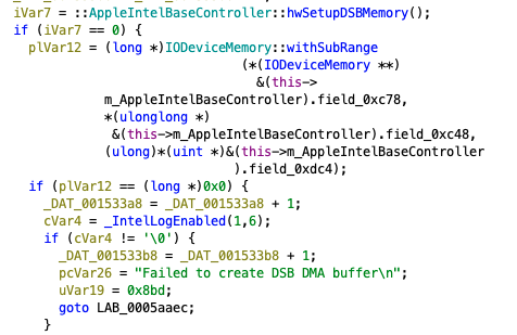

jalavoui Posted September 11, 2024 Share Posted September 11, 2024 (edited) uint32_t AppleIntelBaseController::hwSetupDSBMemory(class AppleIntelBaseController* this) { //intel_dsb_prepare(state, crtc, INTEL_DSB_0, 1024); unsigned int size=DSB_BUF_SIZE; IOOptionBits options = kIODirectionInOut | kIOMemoryPhysicallyContiguous | kIOMapInhibitCache; mach_vm_address_t fDSBOffset = getMember<mach_vm_address_t>(this, 0xc50);//0x4180000 IOMemoryDescriptor* ioMemory = IOMemoryDescriptor::withAddressRange(fDSBOffset, size, kIODirectionIn, NULL); IODMACommand *cmd = IODMACommand::withSpecification( kIODMACommandOutputHost64, 64, 0, IODMACommand::kMapped, 0, 1); cmd->setMemoryDescriptor(ioMemory); cmd->prepare(); IODMACommand::Segment64 seg; UInt64 ofs = 0; UInt32 numSegs = 1; if (cmd->gen64IOVMSegments(&ofs, &seg, &numSegs) != kIOReturnSuccess) { cmd->complete(); cmd->release(); cmd = NULL; ioMemory->complete(); ioMemory->release(); ioMemory = NULL; return 1; } return 0; } i can't follow linux code but isnt this supposed tobe some dma allocation ? this wont crash but doesnt seem todo nothing usefull. #define DSB_BUF_SIZE (2 * PAGE_SIZE) so its someting small Edited September 11, 2024 by jalavoui Link to comment https://www.insanelymac.com/forum/topic/358305-iris-xe-igpu-on-tiger-lake-successfully-loaded-icllp-frambuffer-and-vram-also-recognizes-1536mb-however-some-issues/page/18/#findComment-2825169 Share on other sites More sharing options...
Visual Ehrmanntraut Posted September 11, 2024 Share Posted September 11, 2024 42 minutes ago, jalavoui said: uint32_t AppleIntelBaseController::hwSetupDSBMemory(class AppleIntelBaseController* this) { //intel_dsb_prepare(state, crtc, INTEL_DSB_0, 1024); unsigned int size=DSB_BUF_SIZE; IOOptionBits options = kIODirectionInOut | kIOMemoryPhysicallyContiguous | kIOMapInhibitCache; mach_vm_address_t fDSBOffset = getMember<mach_vm_address_t>(this, 0xc50);//0x4180000 IOMemoryDescriptor* ioMemory = IOMemoryDescriptor::withAddressRange(fDSBOffset, size, kIODirectionIn, NULL); IODMACommand *cmd = IODMACommand::withSpecification( kIODMACommandOutputHost64, 64, 0, IODMACommand::kMapped, 0, 1); cmd->setMemoryDescriptor(ioMemory); cmd->prepare(); IODMACommand::Segment64 seg; UInt64 ofs = 0; UInt32 numSegs = 1; if (cmd->gen64IOVMSegments(&ofs, &seg, &numSegs) != kIOReturnSuccess) { cmd->complete(); cmd->release(); cmd = NULL; ioMemory->complete(); ioMemory->release(); ioMemory = NULL; return 1; } return 0; } i can't follow linux code but isnt this supposed tobe some dma allocation ? this wont crash but doesnt seem todo nothing usefull. #define DSB_BUF_SIZE (2 * PAGE_SIZE) so its someting small This ain't it chief Link to comment https://www.insanelymac.com/forum/topic/358305-iris-xe-igpu-on-tiger-lake-successfully-loaded-icllp-frambuffer-and-vram-also-recognizes-1536mb-however-some-issues/page/18/#findComment-2825170 Share on other sites More sharing options...

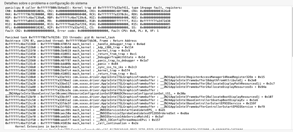

jalavoui Posted September 11, 2024 Share Posted September 11, 2024 (edited) panic during start. do you have a opinion for icl code ? undefined4 __thiscall AppleIntelBaseController::ReadRegister32(AppleIntelBaseController *this,ulong param_1) { char cVar1; undefined8 uVar2; undefined8 uVar3; char *pcVar4; undefined8 in_stack_ffffffffffffffd8; undefined4 uVar5; uVar5 = (undefined4)((ulong)in_stack_ffffffffffffffd8 >> 0x20); _DAT_001934b8 = _DAT_001934b8 + 1; if ((*(byte *)(*(long *)&(this->m_AppleIntelBaseController).field_0xce0 + 0xb2) & 1) != 0) { _DAT_001934c8 = _DAT_001934c8 + 1; if (param_1 < 0x2000) { _DAT_001934d0 = _DAT_001934d0 + 1; } else { _DAT_001934d8 = _DAT_001934d8 + 1; if ((param_1 < 0x40000) || ((_DAT_001934d0 = _DAT_001934d0 + 1, 0x1bffff < param_1 && (_DAT_001934e0 = _DAT_001934e0 + 1, param_1 < 0x240000)))) { _DAT_001934c0 = _DAT_001934c0 + 1; cVar1 = _IntelLogEnabled(2,0xf); if (cVar1 == '\0') { return 0; } _DAT_001934f0 = _DAT_001934f0 + 1; pcVar4 = "0x%lx MMIO dropped for 2D only part\n"; uVar2 = 0x4c3; uVar3 = 2; goto LAB_0006ab99; } } } if (param_1 < *(int *)&(this->m_AppleIntelBaseController).field_0xc20 - 4) { _DAT_001934b0 = _DAT_001934b0 + 1; return *(undefined4 *)(*(long *)&(this->m_AppleIntelBaseController).field_0x9b0 + param_1); } _DAT_001934f8 = _DAT_001934f8 + 1; cVar1 = _IntelLogEnabled(1,0xf); if (cVar1 == '\0') { return 0; } _DAT_00193508 = _DAT_00193508 + 1; param_1 = CONCAT44(uVar5,(int)param_1); pcVar4 = "Invalid register access at offset = %x. Returning without register access\n"; uVar2 = 0x4ce; uVar3 = 1; LAB_0006ab99: _IntelLog(uVar3,0xf, "/Library/Caches/com.apple.xbs/Sources/GPUDriversIntel/GPUDriversIntel-16.0.32/IONDRV/IC LLP/AppleIntelFramebuffer/AppleIntelController.cpp" ,uVar2,"ReadRegister32",pcVar4,param_1); return 0; } this doesnt exist in hookcase. gonna check the new panic i got at star() fixed by reverteding code tobe close to your sources but the same kp as posted above at depthfromattribute(). gonna upload sources as nblue is using only 3 patches and the bins this is funny if i use nblue patch for depthfromattribute() i end up where i started b4 reverting previous code here's the kp not that i wanna do a tutorial on bypassing kp but if you guys grab the source code and build nblue with this line enabled {"__ZN31AppleIntelRegisterAccessManager14ReadRegister32Em",raReadRegister32,this->oraReadRegister32} you pass previous kp will get a kp here allright time to let others think about it this is the way to make the driver produce something we can use to fix it Edited September 12, 2024 by jalavoui Link to comment https://www.insanelymac.com/forum/topic/358305-iris-xe-igpu-on-tiger-lake-successfully-loaded-icllp-frambuffer-and-vram-also-recognizes-1536mb-however-some-issues/page/18/#findComment-2825184 Share on other sites More sharing options...
