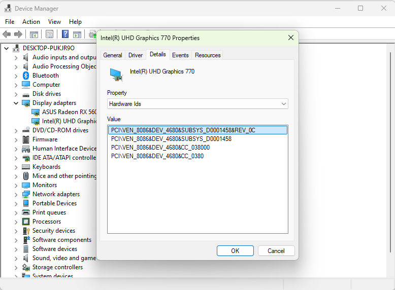

litemintx Posted October 1, 2024 Share Posted October 1, 2024 15 hours ago, naiclub said: Hide contents Is this graphics card compatible? You have Radeon GPU, you can try NootedRed if thats supported. Link to comment https://www.insanelymac.com/forum/topic/358305-iris-xe-igpu-on-tiger-lake-successfully-loaded-icllp-frambuffer-and-vram-also-recognizes-1536mb-however-some-issues/page/20/#findComment-2826059 Share on other sites More sharing options...
naiclub Posted October 1, 2024 Share Posted October 1, 2024 (edited) 4 hours ago, litemintx said: You have Radeon GPU, you can try NootedRed if thats supported. @litemintx Could you please explain this to me? What do I need? Is there anything special? this I read it and still don't understand. Could you please explain it? Edited October 1, 2024 by naiclub Link to comment https://www.insanelymac.com/forum/topic/358305-iris-xe-igpu-on-tiger-lake-successfully-loaded-icllp-frambuffer-and-vram-also-recognizes-1536mb-however-some-issues/page/20/#findComment-2826066 Share on other sites More sharing options...

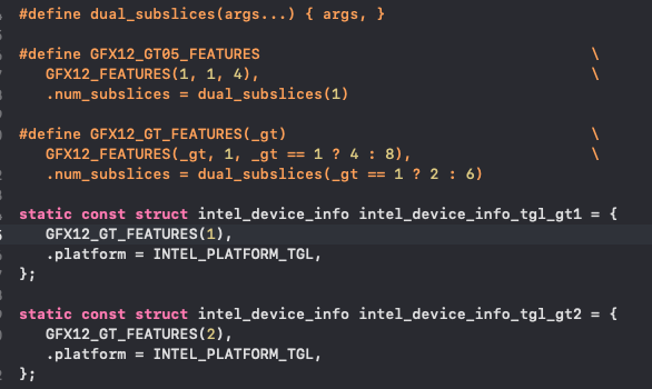

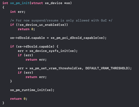

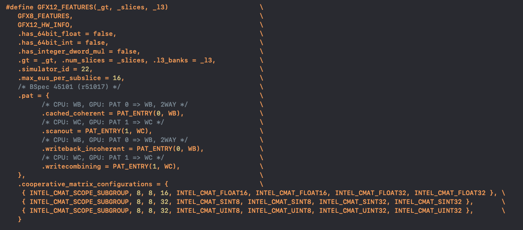

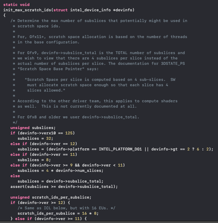

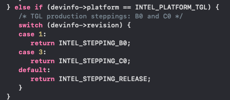

jalavoui Posted October 1, 2024 Share Posted October 1, 2024 (edited) https://elixir.bootlin.com/linux/v6.12-rc1/source/drivers/gpu/drm/xe new intel linux code - check the comment you guys can try the new driver if updating kernel. to get logs use debug flags mesa source code https://gitlab.freedesktop.org/mesa/mesa so using mesa for gt2: GFX12_GT_FEATURES(2) GFX12_FEATURES(2,1,8) .num_subslices = 6 .gt = 2 .num_slices = 1 .l3_banks = 8 .max_eus_per_subslice = 16 Edited October 4, 2024 by jalavoui 2 Link to comment https://www.insanelymac.com/forum/topic/358305-iris-xe-igpu-on-tiger-lake-successfully-loaded-icllp-frambuffer-and-vram-also-recognizes-1536mb-however-some-issues/page/20/#findComment-2826075 Share on other sites More sharing options...

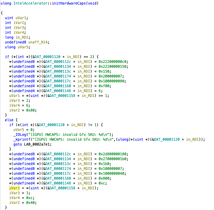

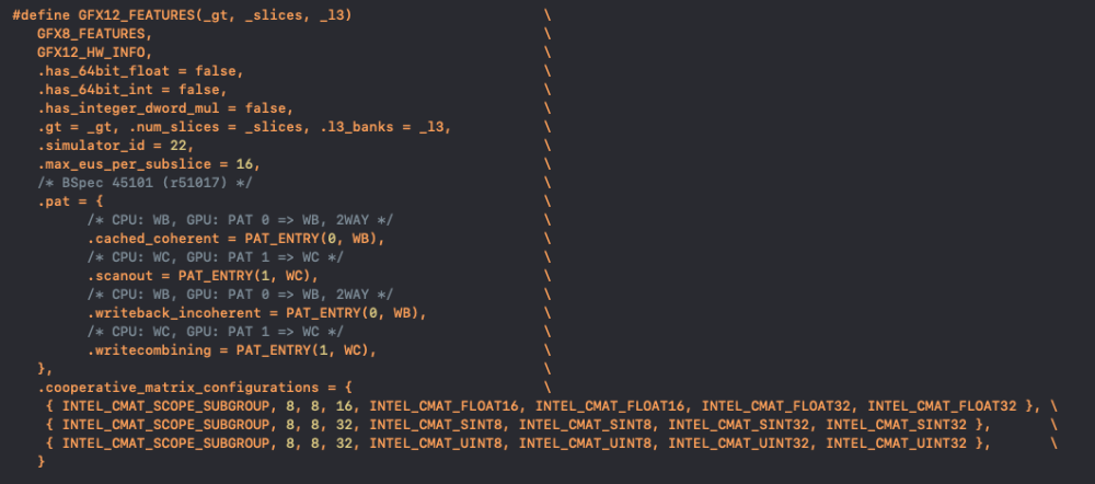

jalavoui Posted October 6, 2024 Share Posted October 6, 2024 (edited) this are tgl caps for gt1/2 altough IGScheduler5 doesn't crash it is not working - if someone solve this then the acelerator will work this var as changes in icl/tgl graphics kext Edited October 6, 2024 by jalavoui 2 Link to comment https://www.insanelymac.com/forum/topic/358305-iris-xe-igpu-on-tiger-lake-successfully-loaded-icllp-frambuffer-and-vram-also-recognizes-1536mb-however-some-issues/page/20/#findComment-2826228 Share on other sites More sharing options...
benmacfreak Posted October 6, 2024 Share Posted October 6, 2024 1 hour ago, jalavoui said: this are tgl caps for gt1/2 altough IGScheduler5 doesn't crash it is not working - if someone solve this then the acelerator will work this var as changes in icl/tgl graphics kext idk how to solve that jala, but when and if someone does ill gladly try it out on my laptop Link to comment https://www.insanelymac.com/forum/topic/358305-iris-xe-igpu-on-tiger-lake-successfully-loaded-icllp-frambuffer-and-vram-also-recognizes-1536mb-however-some-issues/page/20/#findComment-2826230 Share on other sites More sharing options...

Visual Ehrmanntraut Posted October 9, 2024 Share Posted October 9, 2024 On 10/6/2024 at 3:34 AM, jalavoui said: this are tgl caps for gt1/2 altough IGScheduler5 doesn't crash it is not working - if someone solve this then the acelerator will work this var as changes in icl/tgl graphics kext What exactly is happening right now? Link to comment https://www.insanelymac.com/forum/topic/358305-iris-xe-igpu-on-tiger-lake-successfully-loaded-icllp-frambuffer-and-vram-also-recognizes-1536mb-however-some-issues/page/20/#findComment-2826362 Share on other sites More sharing options...

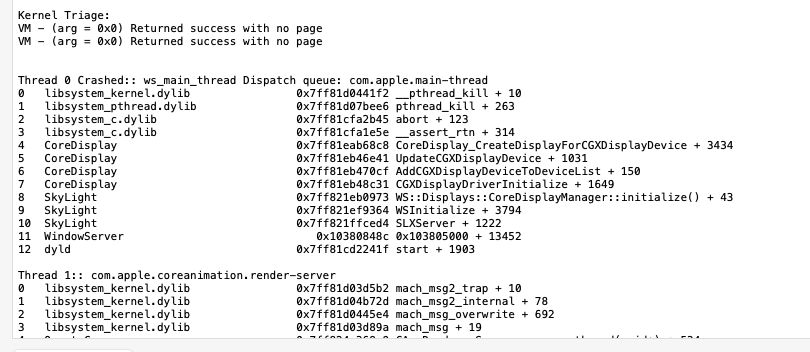

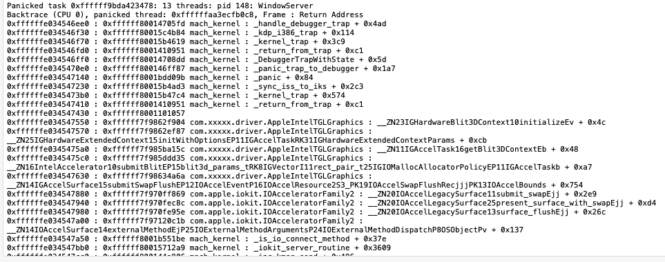

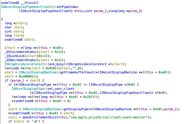

jalavoui Posted October 10, 2024 Share Posted October 10, 2024 (edited) right let me share some new logs if i ignore wrong config of slices,etc and display pipes i can reach this. patching this allow the display to show working cursor with a black screeen. this is very bad practice but allow to get some gpu hang logs windowserver display panic (temp patch in DYLDPatches.cpp depends on os x version) WindowServer-2024-10-07-032842.ipsMTLCompilerService-2024-10-07-234202.ipsKernel_2024-10-08-005107_Mac.gpuRestart can you guys check if you have this igpu property ? Edited October 11, 2024 by jalavoui Link to comment https://www.insanelymac.com/forum/topic/358305-iris-xe-igpu-on-tiger-lake-successfully-loaded-icllp-frambuffer-and-vram-also-recognizes-1536mb-however-some-issues/page/20/#findComment-2826374 Share on other sites More sharing options...
Mastachief Posted October 12, 2024 Share Posted October 12, 2024 On 10/10/2024 at 6:21 AM, jalavoui said: windowserver display panic (temp patch in DYLDPatches.cpp depends on os x version can you guys check if you have this igpu property ? A panic in WindowServer points to issues in how the framebuffer interacts with macOS's core display services. The temporary patch in DYLDPatches.cpp might be bypassing some version-specific checks, but it still results in the system becoming unstable (segmentation fault or access violation based on what youve shown). core display patch needed then? Display Pipeline Errors: The logs show multiple references to CoreDisplay::DisplayPipe, particularly in the function stack: CoreDisplay::DisplayPipe::RunFullDisplayPipe CoreDisplay::DisplayPipe::RunGPUDisplayPipe CoreDisplay::DisplayPipe::Commit CoreDisplay::Display::Present These indicate that the display pipeline is not being fully initialized or committed, leading to incomplete GPU rendering on the display. This is likely where the cursor works but the screen remains black—cursor rendering is handled separately, while the main framebuffer fails to initialize. its the same reason why with nootedblue the cursor moves so fast now, versus its choppy behaviour with whatevergreen. The log mentions VM_REGION errors related to memory regions that are either unmapped or unallocated. This might suggest an issue in GPU power management or resource allocation via AGPM (AppleGraphicsPowerManagement.kext). These failures could be linked to improper configuration of display pipes or slices, causing GPU memory to be mapped incorrectly or not at all. Key Call Stacks: DisplayPipe Functions: The critical crash location occurs in: CoreDisplay::DisplayPipe::RunFullDisplayPipe CoreDisplay::DisplayPipe::Commit CoreDisplay::Display::Commit These functions are responsible for managing the GPU display pipes, which route pixel data from the framebuffer to the display. Given that the iGPU is partially working (cursor shows, but a black screen persists), it suggests that the display pipes are misconfigured or not properly handling display data. Present/Rendering Functions: Additional frames suggest the system fails during the present/update cycle: CoreDisplay::Display::Present WS::Displays::CDDisplay::present_update These functions relate to frame presentation, where completed frames are sent to the display. The presence of these functions in the crash stack indicates that the system is attempting to commit frames to the display, but something in the process (likely framebuffer or pipe misconfiguration) causes a failure. The crash log reports KERN_INVALID_ADDRESS, which means the system tried to access a memory region that wasn't properly allocated or mapped. This points to incomplete memory mapping for the framebuffer or improper slice configuration, leading to invalid memory accesses. The log mentions consecutive crashes and throttle timeout. This indicates that the WindowServer has been crashing repeatedly, likely due to the same unhandled GPU issues, which may result in the system preventing further crashes by throttling the WindowServer process. The framebuffer profiles are usually hardcoded into the framebuffer kexts themselves, with configuration tables that define how the framebuffer interacts with different Intel iGPU models. For both ICLFramebuffer and TGLFramebuffer, the configuration data is embedded within the binary code of the kext. todo patch AppleGraphicsPowerManagement.kext to include the correct power management profiles for Tiger Lake 9A49. Ensure that the AGPM profiles are correctly set up to prevent GPU hangs when switching power states. Link to comment https://www.insanelymac.com/forum/topic/358305-iris-xe-igpu-on-tiger-lake-successfully-loaded-icllp-frambuffer-and-vram-also-recognizes-1536mb-however-some-issues/page/20/#findComment-2826416 Share on other sites More sharing options...
jalavoui Posted October 12, 2024 Share Posted October 12, 2024 (edited) maybe (AppleMobileFileIntegrity) AMFI failing in ioaceleratorfamily2 ? i just installed kdk and try with signed kexts in /S/L/E - not sure if it helped but then the port config is wrong as forcing the display tobe on frame 1 bypass link config, etc and ofc the pipes won't work for aceleration. problem is frame/pipe 0 config in connectors is always lcd and code calls like this use wrong address 0x6f000 and here is the linux comment Edited October 12, 2024 by jalavoui Link to comment https://www.insanelymac.com/forum/topic/358305-iris-xe-igpu-on-tiger-lake-successfully-loaded-icllp-frambuffer-and-vram-also-recognizes-1536mb-however-some-issues/page/20/#findComment-2826426 Share on other sites More sharing options...

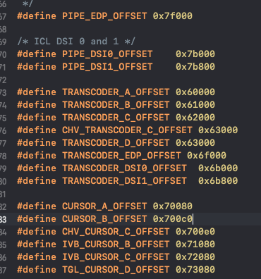

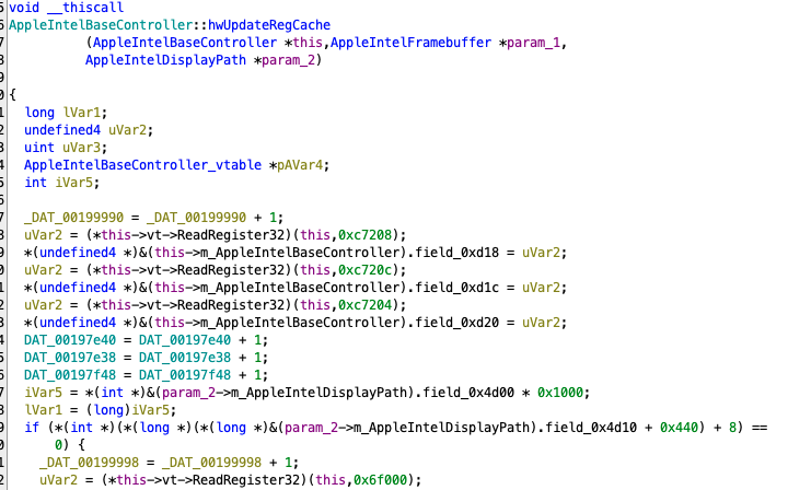

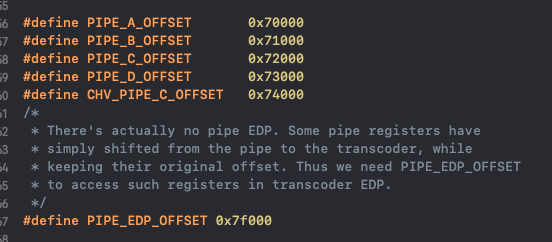

jalavoui Posted October 14, 2024 Share Posted October 14, 2024 (edited) found the pipe issue problem. in icl the hwUpdateRegCache() update for edp is port 0. i.e. the first conector on tgl the code changed to use pipe_A instead of icl pipe_EDP address but patching this on icl cause other issues with remaining edp panel code anyway i'ts progress Edited October 14, 2024 by jalavoui Link to comment https://www.insanelymac.com/forum/topic/358305-iris-xe-igpu-on-tiger-lake-successfully-loaded-icllp-frambuffer-and-vram-also-recognizes-1536mb-however-some-issues/page/20/#findComment-2826508 Share on other sites More sharing options...
