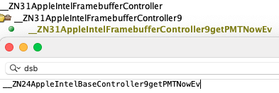

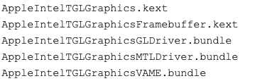

Could not use 'com.xxxxx.driver.AppleIntelTGLGraphicsFramebuffer' because:
this exist in our kext e.g. AppleIntelFramebufferController::getPMTNow
'__ZN24AppleIntelBaseController9getPMTNowEv' in 'com.xxxxx.driver.AppleIntelTGLGraphicsFramebuffer'
'__ZN24AppleIntelBaseController14ReadRegister32Em'
'__ZN24AppleIntelBaseController15WriteRegister32Emj'
__ZN24AppleIntelBaseController14ReadRegister64EPVvm
__ZN24AppleIntelBaseController15WriteRegister64EPVvmy

any ideas on howto load a apple non signed kext ?
my teory is that making AppleIntelTGLGraphicsFramebuffer depend on AppleIntelICLLPGraphicsFramebuffer with some symbol correction might solve most of the symbols
or idk if such a kext exist in dtk image (AppleIntelBaseControler)

i just noticed this
this intelbasecontroller is a old base version (production version) ZN24 and we are at ZN31
Edited by jalavoui
  • Like 4

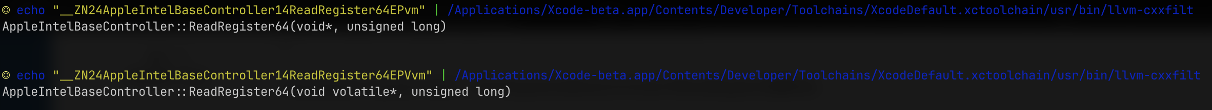

 i need a symbol mangling like this __ZN24AppleIntelBaseController14ReadRegister32Em
defining this class
class AppleIntelBaseController {
public:
static uint32_t ReadRegister32(void *controller, uint32_t  address);
will produce a symbol name __ZN24AppleIntelBaseController14ReadRegister32EPvm
so i need it to end in 32Em not in 32EPvm
what am i missing here ?
omfg - really that easy:
mr@iMac-Pro ~ % c++filt __ZN24AppleIntelBaseController14ReadRegister32Em
AppleIntelBaseController::ReadRegister32(unsigned long)
so this works
jtool2 --analyze NootedBlue
0x4040|__ZN24AppleIntelBaseController14ReadRegister32Em
from defining
static unsigned ReadRegister32(unsigned long  address);
almost done all except for
0x4050__ZN24AppleIntelBaseController14ReadRegister64EPvm
should be
so it miss a V letter
Edited by jalavoui
should be
it was missing a volatile void *controller
i had void *controller
i love symbols  !!

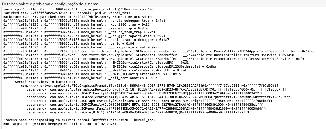

ok i got this - it's the 1st public panic of AppleIntelTGLGraphicsFramebuffer.kext
this after i disable loading icl framebuffer due to duplicate class error with tgl
we just entered a new level of development.
sharing some stuff
this is the base modded kext
this is hook mods
both need tobe in /Library/Extensions
use chmod +R root:wheel on both

boot flag is
IGLogLevel=8

makes more sense to load tgl using nblue so i use a fake gpu id in tgl frame by default
the driver as 9 default connectors. idk howto handle this yet but it seems it trys to activate the 3 valid connectors
with this driver setup any parameter of tgl can now be changed in nblue info.plist

idk how i miss this but this boot flag helps a lot: debug=0x100 keepsyms=1 IGLogLevel=8

cleared old sources (safari doesn't always allow delete)
this are latest but for new tgl framebufer - they are not stable.
stable version is based on icl framebufer (few posts back)

and as expected this tgl as the missing structure that matches a bit of linux code
After some browsing, I found extra AppleIntelTGLxxx files under (Decompress Root Directory)/System/Library/Extensions.
I'm feeding those to Ghidra and scrolling without any idea what to do.
I have no experience in kernel development, but I want to be of help.
I'm leaving a zip file of all the AppleIntelTGL files. Check the link below.
https://drive.google.com/file/d/1x4fDXIUAhNF8X3UgsVPsR9S54V1hrA3e/view?usp=sharing
