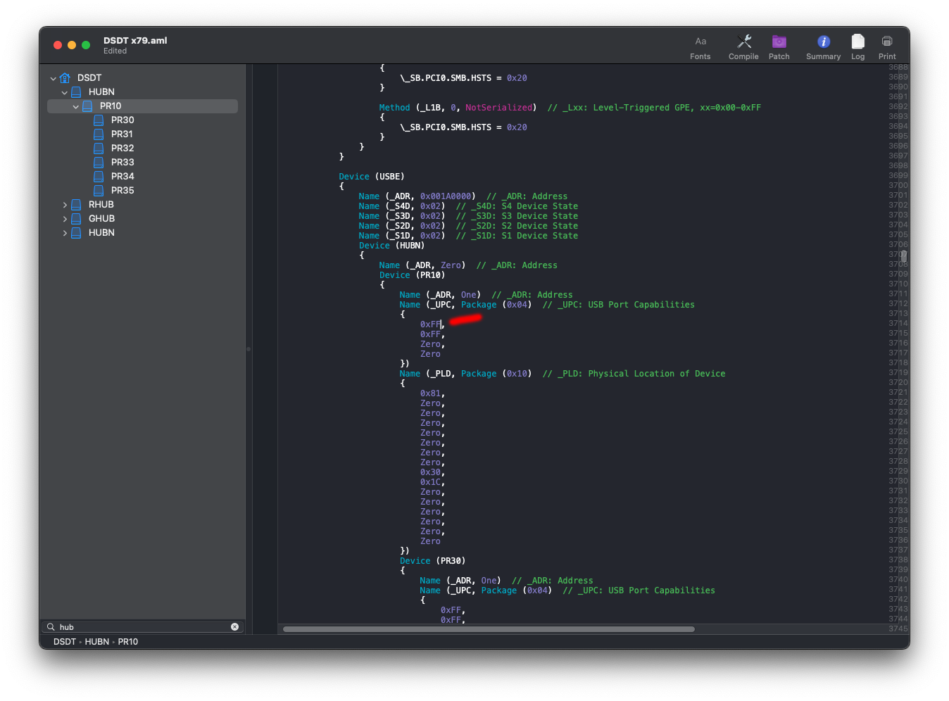

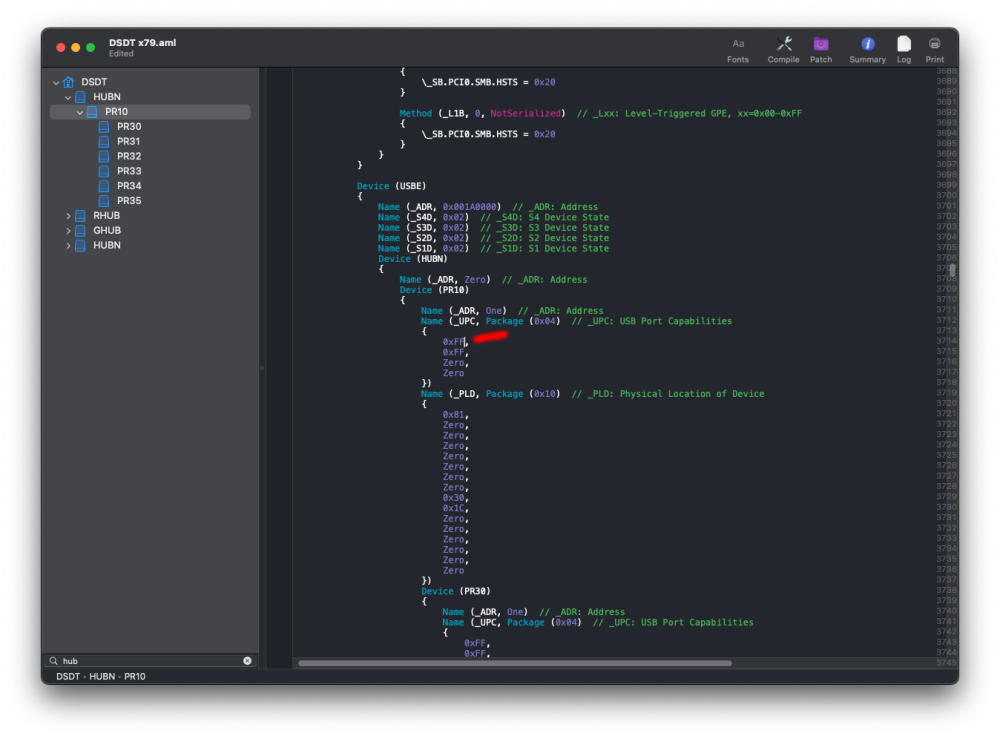

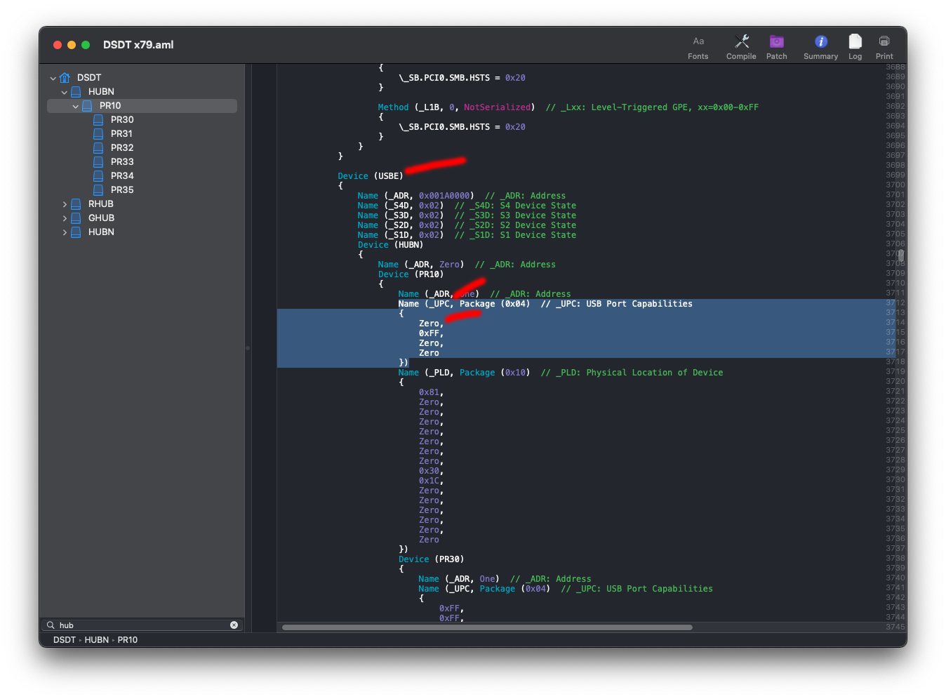

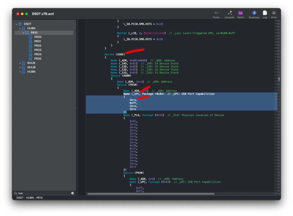

MaLd0n Posted September 28, 2024 Share Posted September 28, 2024 Check USBE/HUBN/PR10 device Too enable this just set Zero to 0xFF 2 Link to comment https://www.insanelymac.com/forum/topic/357234-x79-deluxe-4930k-rx580-no-luck/page/2/#findComment-2826000 Share on other sites More sharing options...
noisegate Posted September 29, 2024 Author Share Posted September 29, 2024 Thanks @MaLd0n, unfortunately your custom .aml gives a panic upon boot, so I'm using @strangeron's setup for now. His ACPI folder has a cluster of SSDT files: Which one should I edit? Thank you 🙏 Link to comment https://www.insanelymac.com/forum/topic/357234-x79-deluxe-4930k-rx580-no-luck/page/2/#findComment-2826011 Share on other sites More sharing options...

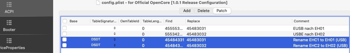

noisegate Posted September 29, 2024 Author Share Posted September 29, 2024 I tried editing my DSDT and place it into the ACPI folder > no luck 🚫 I also tried editing my config with ACPI > Patch > Rename EHC1 to EH01 / EHC2 to EH02 > no luck 🚫 I'm using USBInjectAll v0.8 Here's a dump here if you have a moment for it: https://file.io/3iKf71PZsHTl Thank you bro 🙏 Link to comment https://www.insanelymac.com/forum/topic/357234-x79-deluxe-4930k-rx580-no-luck/page/2/#findComment-2826021 Share on other sites More sharing options...
MaLd0n Posted September 29, 2024 Share Posted September 29, 2024 Try this version USBInjectAll.kext.zip 1 Link to comment https://www.insanelymac.com/forum/topic/357234-x79-deluxe-4930k-rx580-no-luck/page/2/#findComment-2826023 Share on other sites More sharing options...
noisegate Posted September 30, 2024 Author Share Posted September 30, 2024 (edited) Thank you @MaLd0n I tried this version again after renaming EHC1 to EH01 and EHC2 to EH02 but it still doesn't work 😑 Should I enable some quirks in ACPI? Also, does it make sense to try and use kexts that were released at the same time as the version of macOS we're using, or should we stay up to date (since Monterey is not supported anymore and there won't be any new updates)? 🙏 Edited September 30, 2024 by noisegate Link to comment https://www.insanelymac.com/forum/topic/357234-x79-deluxe-4930k-rx580-no-luck/page/2/#findComment-2826037 Share on other sites More sharing options...
