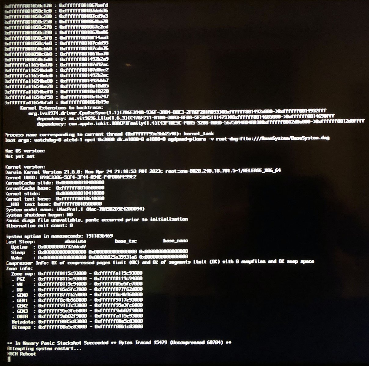

noisegate Posted September 28, 2023 Author Share Posted September 28, 2023 Hi @MaLd0n, @Slice. I finally got a new CPU cooler and some time to send the kernel panic I apologize for the blurry image, the light was poor, but it's readable Thanks! Link to comment https://www.insanelymac.com/forum/topic/357234-x79-deluxe-4930k-rx580-no-luck/#findComment-2811695 Share on other sites More sharing options...
noisegate Posted October 4, 2023 Author Share Posted October 4, 2023 Hi @MaLd0n, @Slice, can you make any sense of this panic screenshot? Thanks Link to comment https://www.insanelymac.com/forum/topic/357234-x79-deluxe-4930k-rx580-no-luck/#findComment-2812031 Share on other sites More sharing options...

Slice Posted October 18, 2023 Share Posted October 18, 2023 On 10/4/2023 at 6:34 PM, noisegate said: Hi @MaLd0n, @Slice, can you make any sense of this panic screenshot? Thanks The panic is with CpuTscSync.kext. I know this panic so I used VoodooTSCSync.kext instead. On 10/4/2023 at 8:43 PM, lidiano said: Hi everyone, I'm asking for a lot of help, I'm in trouble, I've always had "P9X79 deluxe" hackintosh on my computer, but all of a sudden it doesn't work anymore and I can't install OSX anymore, can you help me, what am I doing wrong ? I tried with this EFI, but the installation doesn't start EFI.zip 4.78 MB · 5 downloads Show what is happen. 1 Link to comment https://www.insanelymac.com/forum/topic/357234-x79-deluxe-4930k-rx580-no-luck/#findComment-2812555 Share on other sites More sharing options...

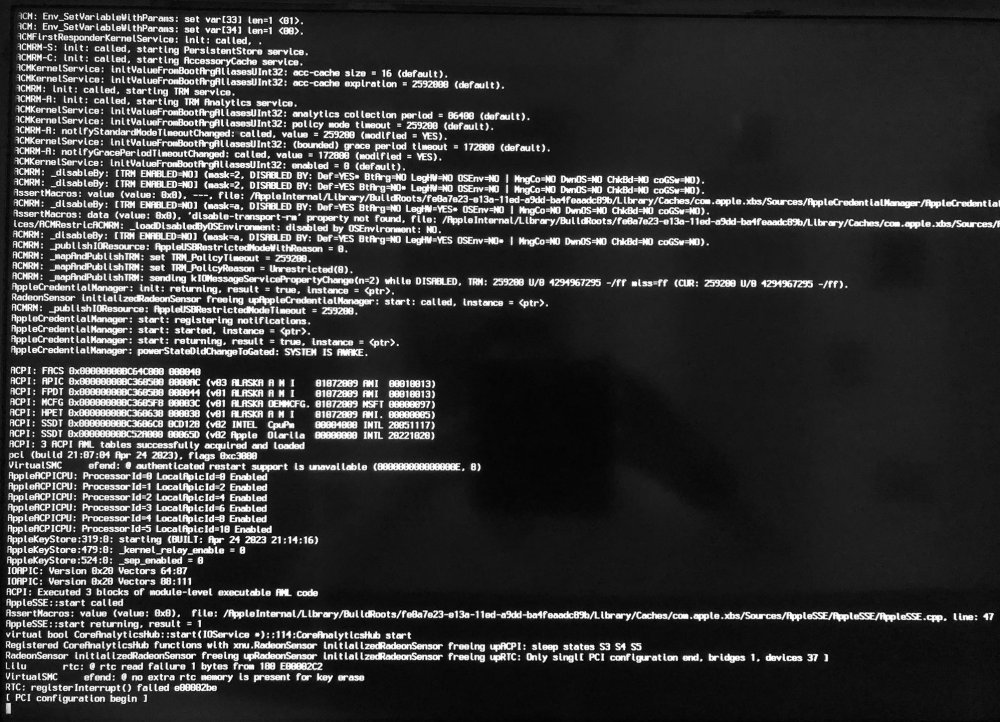

noisegate Posted November 9, 2023 Author Share Posted November 9, 2023 (edited) Hi @MaLd0n, @Slice, Booting directly into the Monterey USB drive from F8 with VoodooTSCSync.kext instead of CpuTscSync.kext automatically switches to another boot option, I don't even enter setup. Booting into my Mojave EFI partition and then selecting the Monterey USB drive from the Clover menu gets me to the Apple logo but I get stuck there. It's weird because I have the -v bootarg but I can't see verbose. My setup doesn't agree with Clover_r5155, I had to roll back Any ideas? Thanks Edited November 9, 2023 by noisegate Link to comment https://www.insanelymac.com/forum/topic/357234-x79-deluxe-4930k-rx580-no-luck/#findComment-2813323 Share on other sites More sharing options...

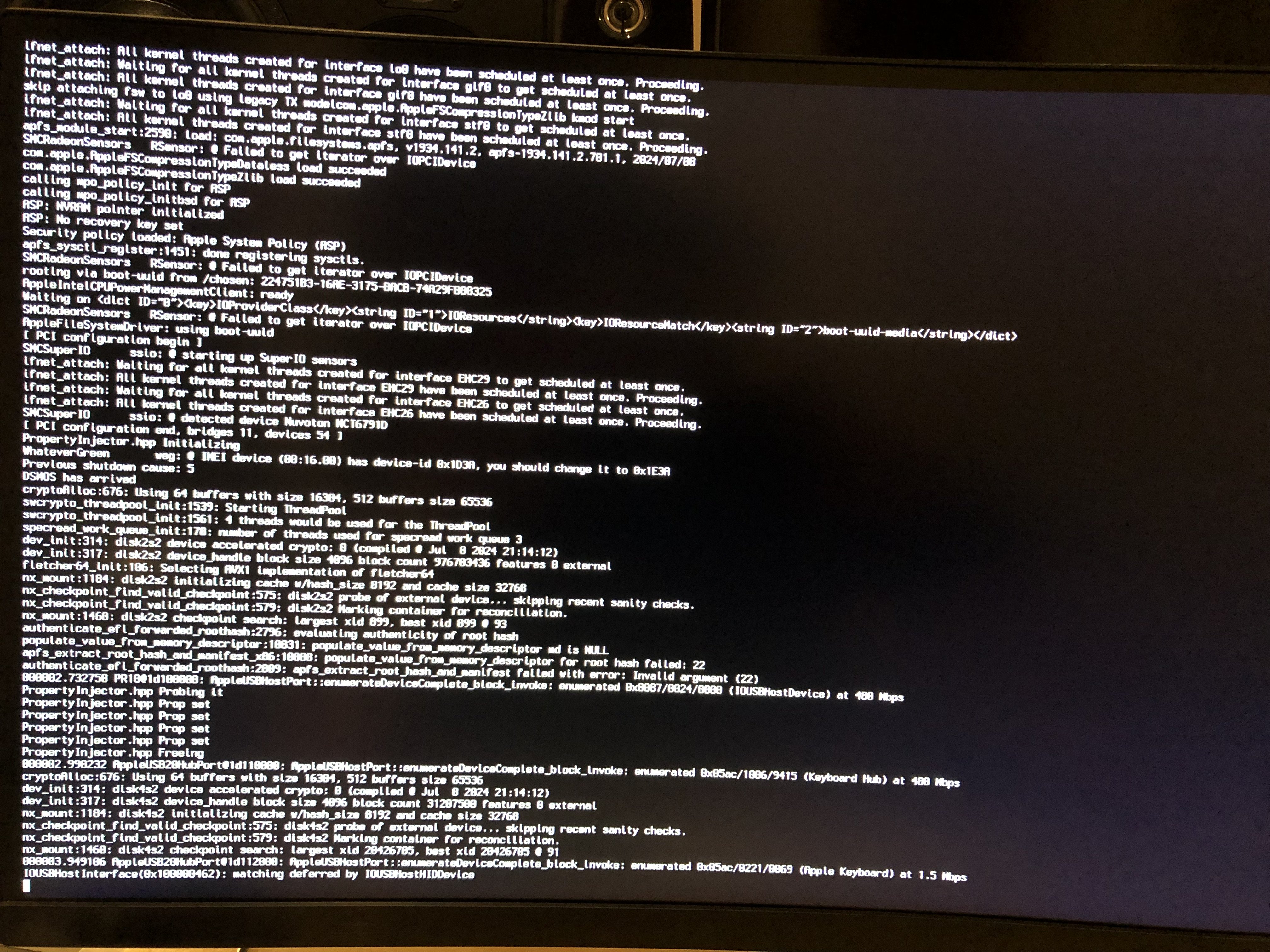

noisegate Posted August 3, 2024 Author Share Posted August 3, 2024 (edited) Hi @MaLd0n, @Slice, I'm giving Monterey v12.7.6 another try. The latest Olarilla OC / Clover EFIs both give me panics and I still can't boot into the installer. I also tried the OC Mod version. I added VoodooTSCSync from https://github.com/CloverHackyColor/VoodooTSCSync and set IOCPUNumber to 11. I tried a few values above 0 for TscSyncTimeout, but it doesn't change anything. No luck with npci=0x3000. Changing the SMBIOS to MacPro 6,1 doesn't work either. It's what I'm using on Mojave. I suspect a graphics issue but I don't know where else to look. The config checker in OC Configurator doesn't seem to work with my setup: Here's where I'm at, thanks for your help: Edited August 3, 2024 by noisegate Link to comment https://www.insanelymac.com/forum/topic/357234-x79-deluxe-4930k-rx580-no-luck/#findComment-2823611 Share on other sites More sharing options...

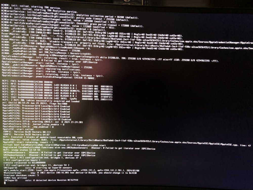

noisegate Posted August 3, 2024 Author Share Posted August 3, 2024 (edited) So here's what I'm getting after using the 3 ACPI files generated by OC Configurator's EFI Maker (SSDT-EC-DESKTOP, SSDT-PLUG-DRTNIA, SSDT-UNC). After a few seconds it gets blurry with the 'No Way' sign. But the boot sequence definitely lasts longer. Please let me know what you think @MaLd0n @Slice, thanks in advance! Edited August 3, 2024 by noisegate Link to comment https://www.insanelymac.com/forum/topic/357234-x79-deluxe-4930k-rx580-no-luck/#findComment-2823613 Share on other sites More sharing options...
Slice Posted August 5, 2024 Share Posted August 5, 2024 First, Clover should be recent 5159. Second, don't use VirtualSMC with Clover. Third, I did some significant DSDT changes on Processor section and on USB section. 1 Link to comment https://www.insanelymac.com/forum/topic/357234-x79-deluxe-4930k-rx580-no-luck/#findComment-2823642 Share on other sites More sharing options...
