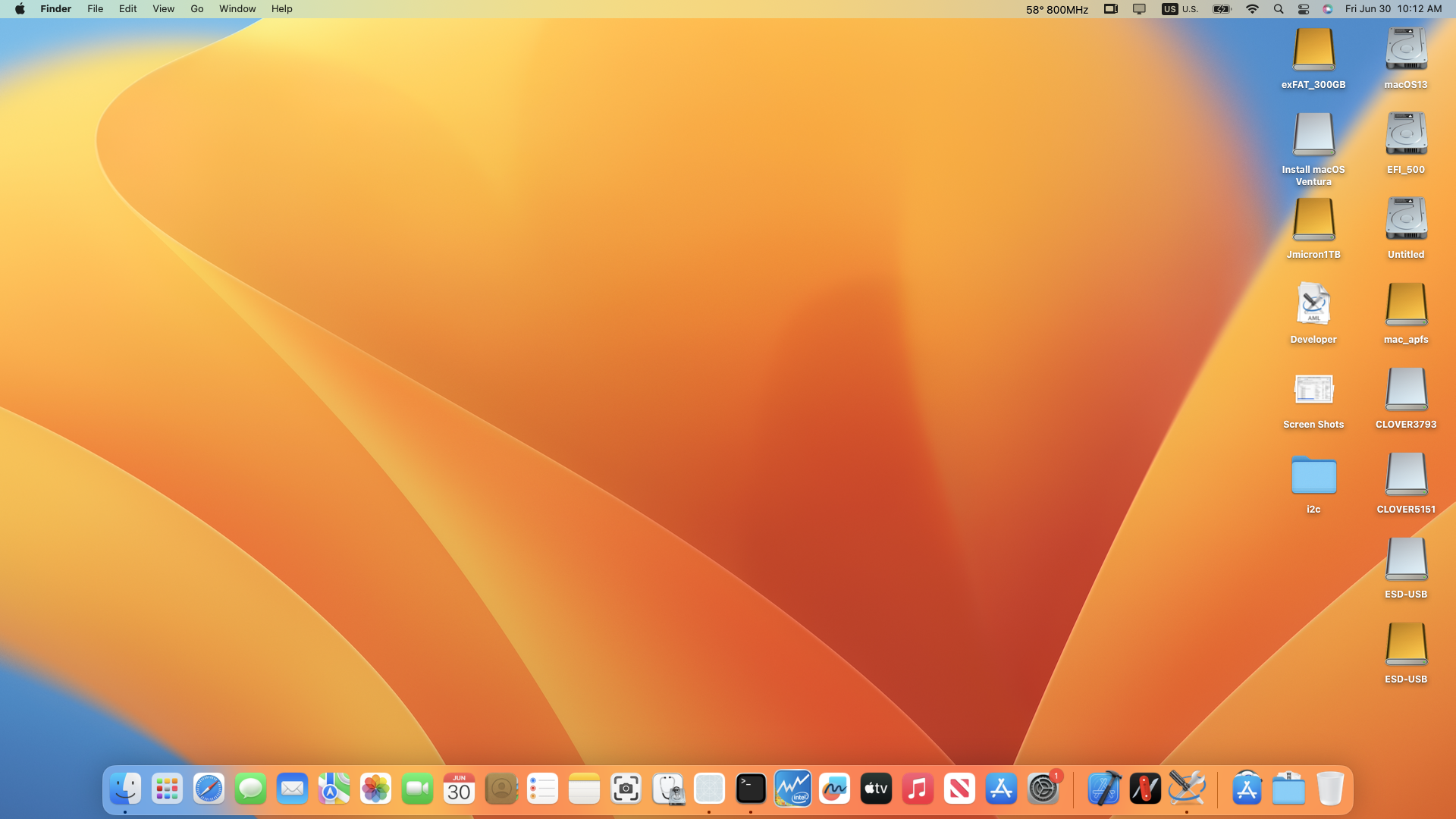

Hello all,
 I have a very nice HP Elitebook 840 G7 i5-10310u which installed with Ventura and Monterey. The sleep is working well, but as soon as it sleeps, the USB seems to be disconnected. Keyboard doesn't respond. Trackpad is flaky although working. Sound works, Wifi Works. The screen takes a long time to come up after wake.
 If someone knows how to fix this keyboard or USB wake please help. I tried everything that I know. All usb C and A work well.
 The sleep actually works because the power light is blinking.
 This MacBook Pro actually lasts 3 hr with Ventura.
Cheers,
Louis
