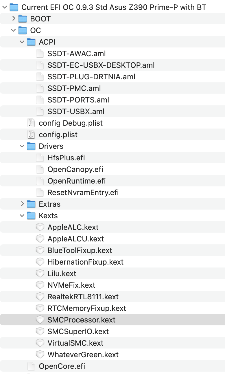

Sandgroper Posted July 5, 2023 Share Posted July 5, 2023 Hi, You did not specify the specific variant of the Asus Z390 Prime. I have the Asus Z390 Prime-P other than that the only difference between your config that you have listed is I also have an RX580 as my GPU. I am running Ventura 13.4.1 This is my current OC configuration which is working very well. I have used an SSDT for the USB ports instead of the USB Kext you have used. I did however disable in the BIOS USB ports 7 and 8 (internal motherboard USB3 ports) and USB ports 11 and 13 (internal motherboard USB2 ports). I upgraded the MB BIOS to version 4.0 - the latest version. The secure boot and Intel Trust Platform are both there, it was even present in my original BIOS version 1.3. There is no parallel port which explains why you could not find it. Also it is not actually possible to disable the Serial port, you have a choice of 4 possible configuration for the port however this is a red hearing as it has nothing to do with preventing the MacOS from operation correctly. I am an electronics geek and use the onboard serial port for connecting to serial devices. If you could not find the Secure Boot and the Intel Trust Platform then are you using the Simplified BIOS setup as opposed to the extended (F7) setup? I also set the DVMT Preallocated to 256M although it is not applicable to you as you are using a GPU. I am using M.2 NVME SSDs hence the NVME fixup. I use the identical EFI on both my installation USB stick as my boot SSD drive. For Bluetooth I am using a Bluetooth Dongle and therefore I also needed Bluetooth Quote Link to comment https://www.insanelymac.com/forum/topic/357092-can-someone-assist-with-debugging-my-opencore-im-getting-desperate-lol/#findComment-2807726 Share on other sites More sharing options...
