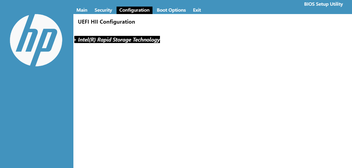

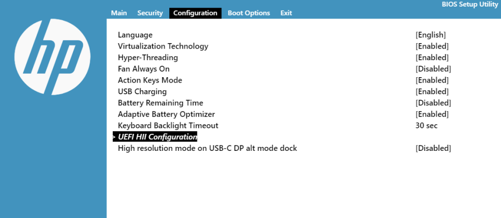

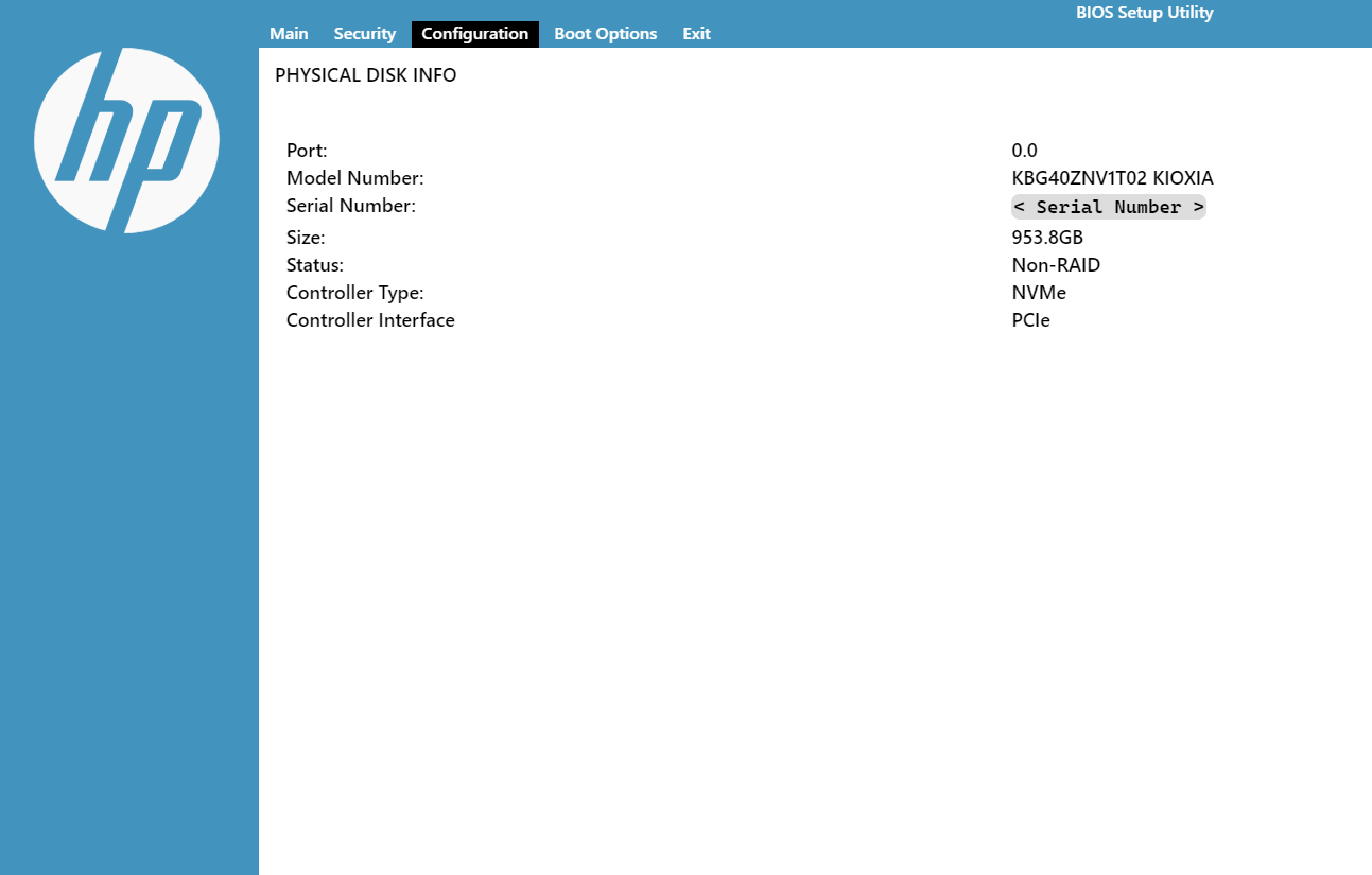

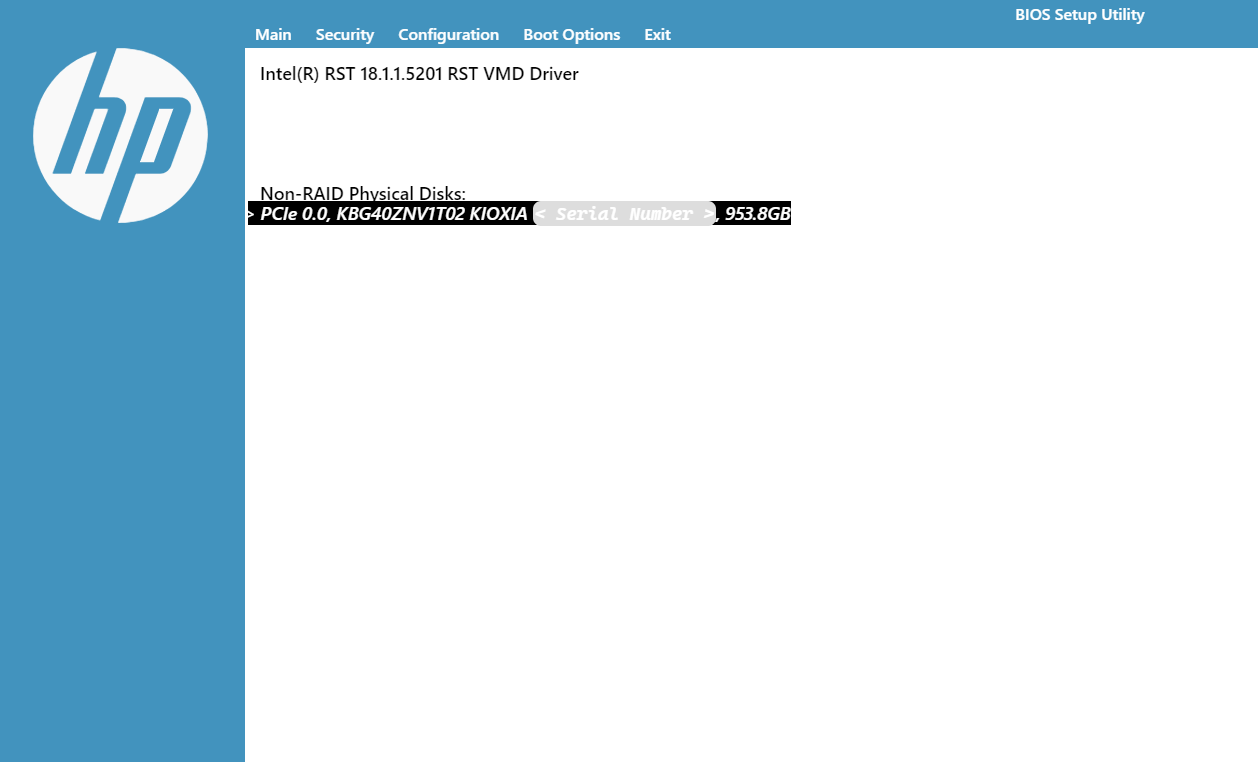

ciao1092 Posted April 5, 2023 Author Share Posted April 5, 2023 Hello, I looked in my UEFI settings and couldn't find AHCI mode or anything similar. Here is what I see: I open UEFI settings I open "Configuration" section I open "UEFI HII Configuration" I open "Intel(R) Rapid Storage Technology" I open the first (and only) disk, my 1TB KIOXIA NVMe Drive I can see disk information, but there is no option to change operating mode... Quote Link to comment https://www.insanelymac.com/forum/topic/356193-stuck-on-eblogexitbsstart/#findComment-2803185 Share on other sites More sharing options...
