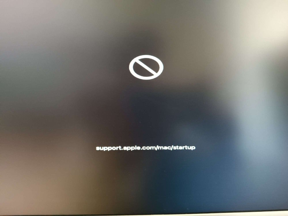

siddharth3322 Posted December 23, 2022 Share Posted December 23, 2022 Following this tutorial, I have prepared required EFI partition: How to Create OpenCore EFI for Intel Desktops using OCGen X | Hackintosh After applying BIOS changes those are required, I tried to boot with USB drive but I started getting this error - Check attached image: Even USB can't able to boot :( Let me give you system related information that I am using to install Hackintosh. Target OS - Ventura Processor - Intel Core i5 4440 3.2GHz Ram - 12GB DDR3 Ram Graphic Card - NVIDIA GeForce GT 710 Intel Motherboard SSD - SATA SSD 240GB Running OS - Windows 10 These are my current system related information and let me know if you need something more. I have uploaded my EFI partition and other system info too - check attached Zip file. I will reply here asap. Please give me some suggestion to sort out this. Thank you for your given time to this post :) 481456746_EFI_CPUDetails.zip Quote Link to comment https://www.insanelymac.com/forum/topic/355135-hackintosh-prepared-usb-cant-able-to-boot/ Share on other sites More sharing options...
Casey_S.J. Posted December 23, 2022 Share Posted December 23, 2022 Couple of quick suggestions: Disable XhciPortLimit in Kernel section of config.plist (for the time being) Insert the USB flash disk into a black USB 2.0 port (yes, USB 2.0 port) Try booting the macOS installer again Also, if I recall correctly, Ventura does not support Nvidia GT710. The GPU should still operate, but without accelerated graphics. 2 Quote Link to comment https://www.insanelymac.com/forum/topic/355135-hackintosh-prepared-usb-cant-able-to-boot/#findComment-2799196 Share on other sites More sharing options...
FirstTimeCustomac Posted December 24, 2022 Share Posted December 24, 2022 Most importantly, MacMini7,1 is not supported in Ventura. Change your system definition to something that's supported in Ventura. After that GT710 and HD4600 can be patched to work in Ventura via OpenCore Legacy patcher. 1 Quote Link to comment https://www.insanelymac.com/forum/topic/355135-hackintosh-prepared-usb-cant-able-to-boot/#findComment-2799218 Share on other sites More sharing options...

Slice Posted December 24, 2022 Share Posted December 24, 2022 1 hour ago, siddharth3322 said: This kind of verbos output I got, Please check attached image. I hope you will get some hint and give me further guidance So the guide you are using is wrong. Ventura can't be installed on iMac15,1. This is what the screen said you. You have to configure your bootloader for SMBIOS iMac18,1 at least. Or just use board-id substitution as Clover does. Quote Link to comment https://www.insanelymac.com/forum/topic/355135-hackintosh-prepared-usb-cant-able-to-boot/#findComment-2799247 Share on other sites More sharing options...
siddharth3322 Posted December 24, 2022 Author Share Posted December 24, 2022 6 minutes ago, Slice said: So the guide you are using is wrong. Ventura can't be installed on iMac15,1. This is what the screen said you. You have to configure your bootloader for SMBIOS iMac18,1 at least. Or just use board-id substitution as Clover does. At present, I am trying to install Catalina rather than Ventura. Then also shall I required to change SMBIOS iMac18,1? Quote Link to comment https://www.insanelymac.com/forum/topic/355135-hackintosh-prepared-usb-cant-able-to-boot/#findComment-2799248 Share on other sites More sharing options...
Slice Posted December 25, 2022 Share Posted December 25, 2022 10 hours ago, siddharth3322 said: At present, I am trying to install Catalina rather than Ventura. Then also shall I required to change SMBIOS iMac18,1? With catalina you should encounter other message and other advice follows. Quote Link to comment https://www.insanelymac.com/forum/topic/355135-hackintosh-prepared-usb-cant-able-to-boot/#findComment-2799260 Share on other sites More sharing options...
