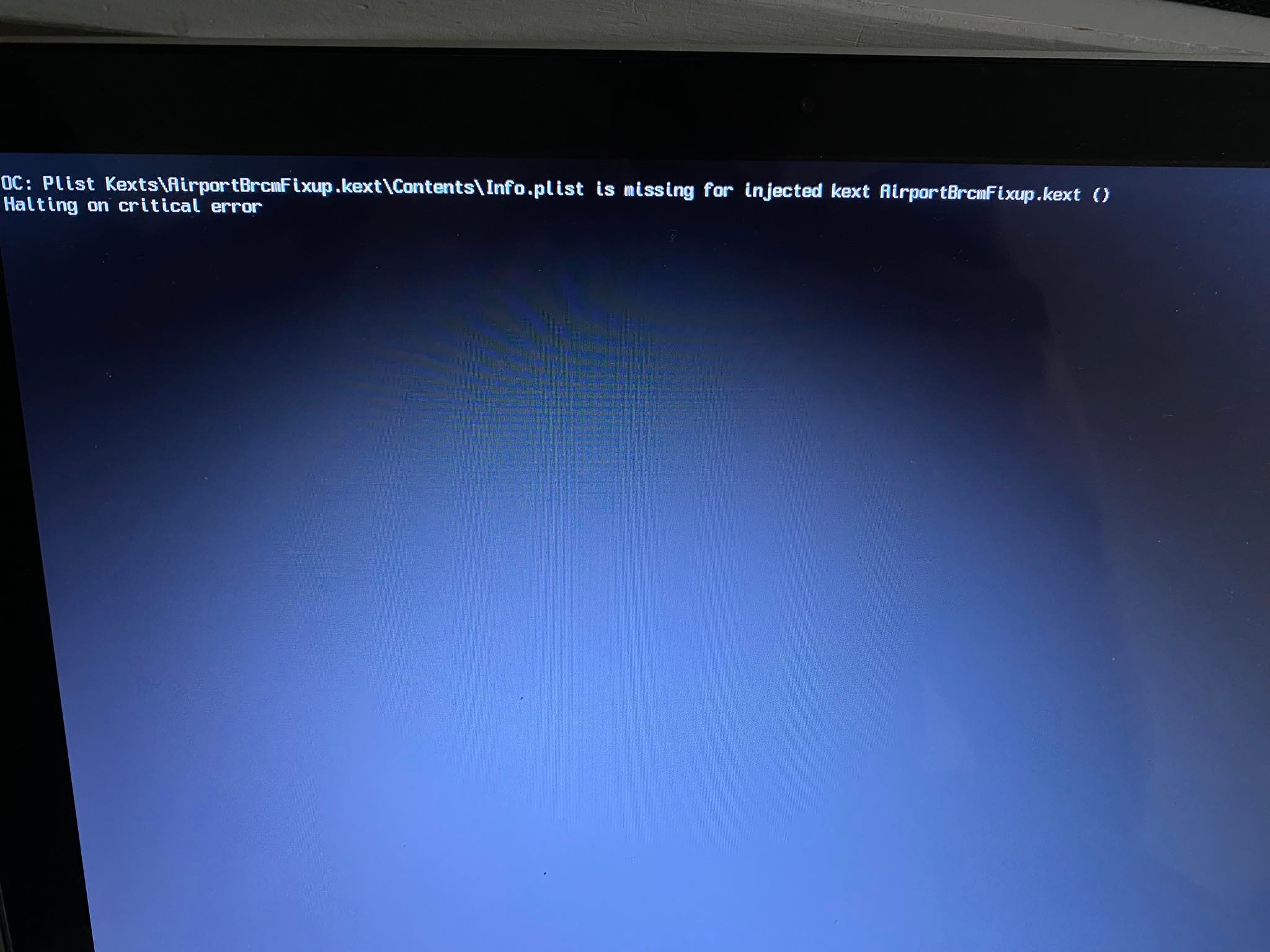

jakub daniło Posted November 18, 2022 Share Posted November 18, 2022 Hello, when I try to install the system on a purchased macbook, it shows this error, there is nothing you can do except enter openshell. SSD just bought, so it's clean Quote Link to comment https://www.insanelymac.com/forum/topic/354821-error-trying-to-install-macos/ Share on other sites More sharing options...
Allan Posted November 18, 2022 Share Posted November 18, 2022 Its a Macbook with OpenCore? 🤨 Inform us the model, give us more details Quote Link to comment https://www.insanelymac.com/forum/topic/354821-error-trying-to-install-macos/#findComment-2797425 Share on other sites More sharing options...
miliuco Posted November 19, 2022 Share Posted November 19, 2022 @jakub daniło Please add a signature to your user profile. The error message seems to say that AirportBcrmFixup.kext doesn't exist in the kext folder or there is something wrong inside it. 1 Quote Link to comment https://www.insanelymac.com/forum/topic/354821-error-trying-to-install-macos/#findComment-2797487 Share on other sites More sharing options...

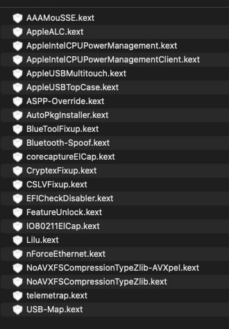

deeveedee Posted December 10, 2022 Share Posted December 10, 2022 (edited) @jakub daniło I never actually looked at your first post to see the error you originally asked about. That error is typically because AirportBrcmFixup.kext is missing from the folder OC/Kexts. I ran OpenCore Legacy Patcher (OCLP) version 0.5.2 to produce the EFI for the MacBook5,1. The kexts included in the OCLP-generated EFI (listed below) do not include AirportBrcmFixup.kext. As far as I know, AirportBrcmFixup.kext is not required for a genuine Apple Mac with genuine Apple Wi-Fi card. You can read more about AirportBrcmFixup.kext here. If the previous owner of your MacBook replaced the Wi-Fi card with a non-native (not Apple) card, then AirportBrcmFixup.kext might be necessary. If your MacBook still contains the original, genuine Apple card, then AirportBrcmFixup.kext may not be necessary and you can try to disable the kext in your config.plist. EDIT: As you can see in the list of kexts below, OCLP 0.5.2 does include IO80211ElCap.kext, so it appears that newer versions of macOS require kernel patching to work with the original Apple Wi-Fi card in the MacBook5,1. After you get your MacBook booting with the current EFI (disable AirportBrcmFixup.kext in config.plist or add AirportBrcmFixup.kext to OC/Kexts), it will be interesting to know if you have working Wi-Fi. If not and you have the original Wi-Fi card, you may need to load IO80211ElCap.kext. If you feel adventurous, you may want to generate a new EFI with OCLP 0.5.2. Be sure to backup your current EFI before you replace it with a new one (just in case). Spoiler @miliuco I just noticed that you already gave this answer earlier in the thread. Sorry to be redundant! Edited December 11, 2022 by deeveedee 1 Quote Link to comment https://www.insanelymac.com/forum/topic/354821-error-trying-to-install-macos/#findComment-2798581 Share on other sites More sharing options...
