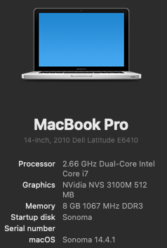

It's been a while since I provided OCLP testing updates (testing is just for fun/hobby/bragging-rights and not for production use for the security reasons stated previously), so this is just a quick update.  This hack is now able to run Sonoma 14.4.1 patched with OCLP 1.4.3 (Release).  My OC EFI is a using OC 0.9.9.  Sonoma 14.4.1 runs amazingly well on this old hack.  CPU/graphics power management in Sonoma 14.4.1 (with OCLP's injected power management kexts) is incredible... my CPU fan hardly runs during 'normal' office tasks.
For restored functionality and ease of patching, the OCLP Devs have done an amazing job.
About This Hack
Spoiler

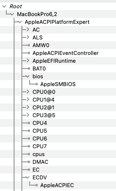

How have you been, I modified my post just now it looked like I was hi-jacking your thread at first.  I have a question regarding your ECDV device.  Your ECDV device does show AppleACPIEC under your ECDV in your ioreg snipit you posted way back on my Asus G51JX post.  My question is regarding your SSDT-EC.  I see the scope is for LPCB.  I have see two versions of this SSDT-EC.  The one you and I are using maybe meant for laptops and one maybe for desktops where the scope is SB rather than LPCB.
Should EC be under SB or LPCB or should it be under SB for desktops and LPCB for Laptops.  We don’t want our AppleACPIEC under the EC device on PCs either way correct?
Edited by oSxFr33k
@oSxFr33k Long time no talk!  I had to review our old discussions to refresh my memory.  Glad to see you're still active.  Hopefully I gave some good advice previously, as I was helping you while I was still figuring out things myself.
I spun my wheels over back and forth iterations of how to patch EC (not seeing a difference in any of them).  I finally settled on an Acidanthera recommendation to add a new EC device without renaming the original.  Renaming your original EC can have unintended downstream affects that change how you patch other elements, since Open Core ACPI renames (ACPI patches) happen before ACPI Adds (SSDTs).
If your hack is working, I don't think you need to worry much about where a particular binding (e.g., AppleACPIEC) appears in your IOReg.  This guide recommends keeping the original EC device (not renaming EC) for laptops.  Note that the recommendation is different for Desktops.
EDIT: Here's a snapshot of the IOReg on my HackBookPro6,2 (captured with IORegistryExplorer2.1 in Ventura 13.6.6):
Spoiler
@oSxFr33k Did I answer your question?

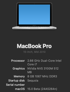

It appears that this HackBookPro6,2 will run Sequoia.  See details here.
Spoiler
... and Sequoia Beta 2
Spoiler
Edited by deeveedee

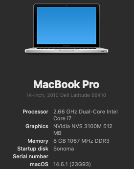

Smooth upgrade to Sonoma 14.6.1  patched with OCLP 1.4.3 and booting with Open Core 1.0.1.
Spoiler

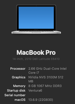

Smooth upgrade from Ventura 13.6.8 to 13.6.9 booting with Open Core 1.0.1.  Applying Ventura Nvidia Tesla post-install patches with OCLP 0.6.8.
Spoiler
