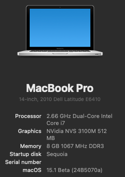

OCLP Devs have produced working non-metal post-install patches for Sequoia in OCLP 2.0.0 (Beta at the time of this writing).  I am now booting Big Sur, Monterey, Ventura, Sonoma and Sequoia on this HackBookPro6,2 (now just for a fun hobby and bragging rights since I don't trust OCLP-patched hacks and Macs for any production use).  My uses for OCLP are my preference.  If you are certain that you have use cases that can't be compromised by a broken APFS seal, disabled SIP and disabled SecureBootModel (or you just don't care), keep using your OCLP patched hack / Mac.
I am multibooting multiple versions of macOS with a single Open Core 1.0.1 EFI and am applying OCLP post-install patches to each version of macOS as follows:
  • Big Sur: OCLP 0.6.8
  • Monterey: OCLP 0.6.8
  • Ventura: OCLP 0.6.8
  • Sonoma: OCLP 1.4.3
  • Sequoia: OCLP 2.0.0
I don't upgrade OCLP post-install patches for the sake of upgrading, so this strategy (patching each macOS version with its own fully tested OCLP version) works well for me.  Others may find it more convenient to patch all versions of macOS with the same version of OCLP.  There is no technical reason to keep all OCLP post-install patch versions the same - it's just a personal preference.
I don't expect this old hack to be supported in macOS 16, but I do hope I'm wrong.  This has been a fun journey, which started when, in 2019, someone over at LatitudeOSX told me that "If no one has found a solution for the Dell Latitude E6410 by now, no one is going to find one" (referring to the fact that no one had ever gotten sleep/wake to work properly with the Dell Latitude E6410).  I hope they know how much I appreciated their encouragement ;)
There's nothing that motivates me more than being told that it can't be done.  I'm glad the OCLP Devs are motivated to do what others said couldn't be done.

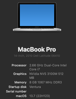

Upgrade from Ventura 13.6 -> 13.7 proceeded without issues via OTA.  Still applying Ventura Nvidia Tesla post-install patches with OCLP 0.6.8.
Spoiler

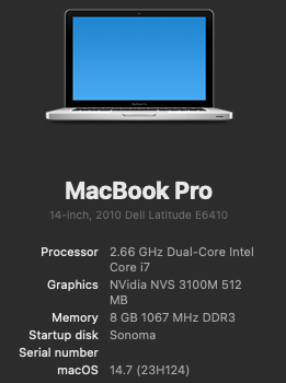

EDIT: ... and Sonoma 14.6 -> 14.7.  Still applying Sonoma post-install patches with OCLP 1.4.3.
Spoiler

Easy upgrade of this HackBookPro6,2 from Sequoia 15.1 Beta 5 -> Beta 6.  Booting with Open Core 1.0.2.  Post-install patches applied with OCLP 2.0.2.

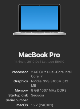

Smooth upgrade to Sequoia 15.2 (24C101) patched with OCLP 2.2.0, booting with OC 1.0.3.
EDIT: After reading reports by some in MacRumors, I expected Sequoia to be slower than previous versions of macOS.  It seems to me that Sequoia 15.2 is more responsive than Sonoma on this 2010 laptop.

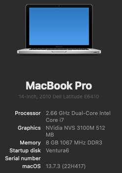

Smooth upgrade of this hack from Ventura 13.7.2 -> 13.7.3.  Applied post-install patches (Nvidia Tesla) with OCLP 2.2.0.  Booting with OC 1.0.3.
Must remain on Safari 18.1.1.  Safari 18.2 and Safari 18.3 crash when running in Ventura 13.7.3.
*** It appears that the Safari 18.1.1 install package for Ventura is no longer available for download from Apple. Recovery from an accidental upgrade to Safari 18.2+ may not be possible with a direct download from Apple. ***

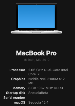

I couldn't resist the temptation, so I created a new APFS volume to test Sequoia 15.4 Beta 1.  Not surprised that Sequoia 15.4 Beta 1 does not boot after applying OCLP 2.2.0 post install patches.  Fortunately, I was able to revert the OCLP root patches by booting into Sequoia 15.4 Recovery and executing "bless --mount /Volumes/SequoiaBeta --bootefi --last-sealed-snapshot" to restore Sequoia 15.4 boot (albeit without OCLP root patches).
I also removed OpenCoreLegacyPatcher plists in /Volumes/SequoiaBeta/System/Library/CoreServices, /Library/LaunchAgents and /Library/LaunchDaemons (where SequoiaBeta is my test volume for SequoiaBeta 15.4).
EDIT: Here are the specific steps I followed to revert OCLP root patches after not being able to boot Sequoia 15.4 Beta 1:
  • Boot into Sequoia 15.4 Beta Recovery
  • mount -uw /Volumes/SequoiaBeta [where SequoiaBeta is the name of your Sequoia 15.4 Beta test volume]
  • bless --mount /Volumes/SequoiaBeta --bootefi --last-sealed-snapshot
  • Reboot Sequoia 15.4 Beta.
Edited by deeveedee

Sequoia 15.4 Beta 2 boots to blackscreen when patched with OCLP 2.2.0 and OCLP 2.3.0 Nightly (not surprised, since I see no commits that improve 2.3.0 over 2.2.0 for NVidia Tesla graphics).  Reverted to bootable state by following steps here.  It appears to me that Sequoia 15.4 Beta needs updated OCLP patches for NVidia Tesla.

OCLP 2.3.0 Release has successfully patched this HackBookPro6,2 running Sequoia 15.4 RC1. Posting this with Safari 18.4. Still booting with OC 1.0.3 EFI. For my purposes, all appears ok. Will be upgrading to 15.4 Release and maybe OC 1.0.4 soon. Well done, OCLP Devs!
EDIT: After upgrading to Sequoia 15.4 (Release) and upgrading my EFI to OC 1.0.4, all still appears to be good for my limited use cases.
