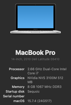

deeveedee Posted February 12 Author Share Posted February 12 (edited) Easy update to Sequoia 15.7.4 and Safari 26.3. The only problem that I found is that Shift-Command-4 no longer takes screenshots. I tried with the internal PS2 keyboard and an external USB keyboard - the problem exists on both, so this isn't a PS2 issue. Other than that, Sequoia 15.7.4 runs very well on this very old hack. EDIT: Note that Shift-Command-4 was working in Sequoia 15.7.3 as evidenced by this screenshot: EDIT2: I have confirmed that the Shift-Command-4 screenshot problem doesn't happen until OCLP post-install patches are applied for NVidia Tesla (using OCLP 2.4.1 or 2.5.0n). If I revert post-install patches, screenshot works. Edited February 13 by deeveedee 1 Link to comment https://www.insanelymac.com/forum/topic/354497-guide-dell-latitude-e6410-nvidia-hackintosh-big-sur-monterey-ventura-sonoma-sequoia-tahoe-installations-with-open-core-legacy-patching/page/15/#findComment-2847342 Share on other sites More sharing options...
johnnyl Posted February 13 Share Posted February 13 Isn't it Shift-Command-3 for screenshots ? Well that's what I use. Link to comment https://www.insanelymac.com/forum/topic/354497-guide-dell-latitude-e6410-nvidia-hackintosh-big-sur-monterey-ventura-sonoma-sequoia-tahoe-installations-with-open-core-legacy-patching/page/15/#findComment-2847345 Share on other sites More sharing options...
LockDown Posted February 13 Share Posted February 13 3 = Entire screen 4 = Selected portion of the screen 1 Link to comment https://www.insanelymac.com/forum/topic/354497-guide-dell-latitude-e6410-nvidia-hackintosh-big-sur-monterey-ventura-sonoma-sequoia-tahoe-installations-with-open-core-legacy-patching/page/15/#findComment-2847346 Share on other sites More sharing options...
deeveedee Posted February 13 Author Share Posted February 13 (edited) None of the Shift-Command screenshot key sequences work in Sequoia 15.7.4 on this old hack. I use Shift-Command-4 as explained by LockDown for capturing partial screen shots. Note that I don't have this problem on any of my newer hacks, so I suspect that this is a problem specific to non-metal (maybe specific to non-metal NVidia Tesla). EDIT: I updated this old hack to macOS Tahoe 26.3 (25D125). Still hoping that non-metal Tesla patches are released by the OCLP Devs. EDIT2: I have confirmed that the Sequoia 15.7.4 screenshot problem doesn't happen until I apply OCLP post-install patches (using OCLP 2.4.1 or 2.5.0n). Without post-install patches, screenshot still works. This Sequoia 15.7.4 screenshot issue may resolve itself when a newer KDK is available from Apple. Edited February 13 by deeveedee 1 Link to comment https://www.insanelymac.com/forum/topic/354497-guide-dell-latitude-e6410-nvidia-hackintosh-big-sur-monterey-ventura-sonoma-sequoia-tahoe-installations-with-open-core-legacy-patching/page/15/#findComment-2847348 Share on other sites More sharing options...

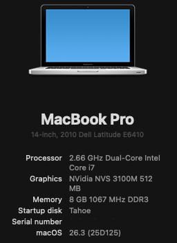

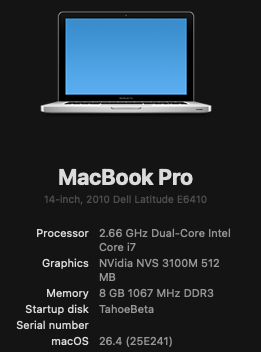

deeveedee Posted March 24 Author Share Posted March 24 Tahoe 26.4 RC... No root patches, just keepin' the dream alive 1 Link to comment https://www.insanelymac.com/forum/topic/354497-guide-dell-latitude-e6410-nvidia-hackintosh-big-sur-monterey-ventura-sonoma-sequoia-tahoe-installations-with-open-core-legacy-patching/page/15/#findComment-2848382 Share on other sites More sharing options...

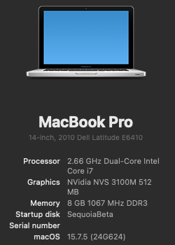

deeveedee Posted March 24 Author Share Posted March 24 (edited) Updated my HackBookPro6,2 (Intel Arrandale CPU, non-metal Nvidia Tesla) to Sequoia 15.7.5 (24G624) and applied post-install patches (Modern Wi-Fi, Nvidia Tesla Graphics) with OCLP 2.5.0n (commit b9df76e). Spoiler All appears to be working except <Shift> <Command> screenshots. These screenshots still work until I apply the post-install patches. I suspect this is because Apple still has not published an updated KDK for Sequoia I'm still amazed that this old laptop can run Sequoia and receive updates from Apple. Posting this with Safari Version 26.4 (20624.1.16.18.1). Continuing to keep this hack alive as a hobby and not much else. Sequoia is surprisingly responsive on this 2010 laptop. Edited April 11 by deeveedee Link to comment https://www.insanelymac.com/forum/topic/354497-guide-dell-latitude-e6410-nvidia-hackintosh-big-sur-monterey-ventura-sonoma-sequoia-tahoe-installations-with-open-core-legacy-patching/page/15/#findComment-2848396 Share on other sites More sharing options...

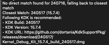

deeveedee Posted April 11 Author Share Posted April 11 (edited) I manually installed KDK 15.7.4 in Sequoia 15.7.4 on my HackBookPro6,2. <Shift> <Command> screen captures are working again. The problem was the missing KDK and not OCLP. For some reason, the Dortania KDK mirror did not pull KDK 15.7.4 from Apple. I rebooted and <Shift><Command> screenshots are not working again. Not sure what happened, but the KDK isn't the whole story. Edited April 11 by deeveedee Link to comment https://www.insanelymac.com/forum/topic/354497-guide-dell-latitude-e6410-nvidia-hackintosh-big-sur-monterey-ventura-sonoma-sequoia-tahoe-installations-with-open-core-legacy-patching/page/15/#findComment-2848989 Share on other sites More sharing options...

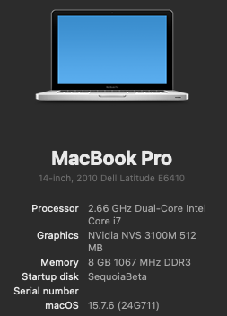

deeveedee Posted April 14 Author Share Posted April 14 (edited) Very smooth upgrade to Sequoia 15.7.6 RC with one small hurdle... After upgrading to Sequoia 15.7.6 RC, OCLP 2.5.0n did not detect the need for Nvidia Tesla root patches (only detected the need for Modern Wireless). After reverting root patches and rebooting, OCLP 2.5.0n detected the need for both Modern Wireless and Nvidia Tesla root patches. The root patches installed with KDK 15.7.4 (which I manually installed). All that I tested appears to be working well with the exception of <Shift><Command> screen shots (as was the case with 15.7.5). KDK 15.7.4 Spoiler Sequoia 15.7.6 RC is very responsive on this old hack. Amazing. I'm still not using this for anything more than a hobby and bragging rights and am very pleased to be running macOS Sequoia on this 2010 laptop. EDIT: KDK 15.7.4 is now included in the Dortania KDK mirror for OCLP. Edited April 23 by deeveedee Link to comment https://www.insanelymac.com/forum/topic/354497-guide-dell-latitude-e6410-nvidia-hackintosh-big-sur-monterey-ventura-sonoma-sequoia-tahoe-installations-with-open-core-legacy-patching/page/15/#findComment-2849134 Share on other sites More sharing options...

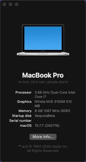

deeveedee Posted April 25 Author Share Posted April 25 Smooth upgrade to Sequoia 15.7.7 Beta (24G716). Posting this with Safari Version 26.5 (20624.2.4.18.2). This old laptop is running Sequoia amazingly well. My OCLP patching specs are as follows: Booting with Open Core 1.0.7 Updated RestrictEvents.kext to javascriptcore branch version 1.1.7 (revpatch=jsc) Applied root patches for Nvidia Tesla graphics and modern Broadcom Wi-Fi with OCLP 2.5.0n. OCLP used KDK 15.7.4 Spoiler The native macOS Sequoia screenshot app is still not working, so I'm using a 3rd-part app from the AppStore. 1 Link to comment https://www.insanelymac.com/forum/topic/354497-guide-dell-latitude-e6410-nvidia-hackintosh-big-sur-monterey-ventura-sonoma-sequoia-tahoe-installations-with-open-core-legacy-patching/page/15/#findComment-2849520 Share on other sites More sharing options...

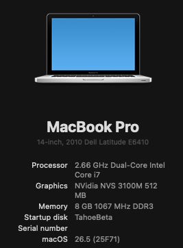

deeveedee Posted May 20 Author Share Posted May 20 (edited) This is kind of amazing (to me)... I am posting this in Firefox 151.0 on my HackBookPro6,2 running macOS Tahoe 26.5. Booting with Open Core 1.0.7. No OCLP root patches, no Wi-Fi, no audio. Surprisingly responsive! I wouldn't use this for anything other than creating this post 😂 EDIT: I am editing this post in Safari 26.5. Spoiler Note that my Open Core EFI has dhinakg's RestrictEvents.kext 1.1.7 (javascript core branch) with revpatch=jsc. Edited May 20 by deeveedee 1 Link to comment https://www.insanelymac.com/forum/topic/354497-guide-dell-latitude-e6410-nvidia-hackintosh-big-sur-monterey-ventura-sonoma-sequoia-tahoe-installations-with-open-core-legacy-patching/page/15/#findComment-2850510 Share on other sites More sharing options...
