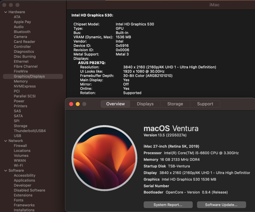

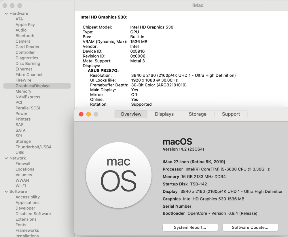

On 7/9/2022 at 9:36 PM, ichelash said:
Alright fellas, after the advise from @aben that i change from DVI to something modern, i can confirm that my Intel HD 530 is now fully function since is started using HDMI, Thanks everyone for the support.
I have two similar desktops as yours and both with DP--> HDMI graphics/audio from 2nd Display (DP) output :
MB: ACER Veriton X6650G|CPU: i5-6600 3.3 GHz|GPU: Intel HD 530|Chipset:SQ 270
It can wake-up from S3 sleep without any issue.
But another one:
MB: LENOVO M900|CPU: i5-6500 3.2 GHz|GPU: Intel HD 530|Chipset:SQ 170
It always got blank screen when wake-up from S3 sleep.
I think yours should work without such an issue.
[Edit]
I found that only OpenCore 0.9.4 can wake-up from S3 sleep without any issue while OC 0.9.7 failed !
Edited by jsl2000
