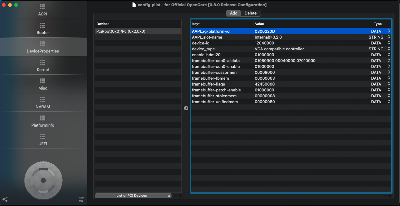

$tealth Posted May 30, 2022 Share Posted May 30, 2022 @ANONIMNIQ I also had issue with jumpy mouse and garbled issues with the cursor I was able to fix the setting with the help of these settings given in the picture. These setting are given by @Silce and @ @herve in this post. My graphics card is Intel HD 4600 Quite closer to your one This has fixed my issue on BigSur and Monterey. This is the link Follow these settings in open core Link to comment https://www.insanelymac.com/forum/topic/351838-monterey-freeze-with-hd4400/page/2/#findComment-2783229 Share on other sites More sharing options...

ANONIMNIQ Posted May 30, 2022 Author Share Posted May 30, 2022 @$tealth thank you, I tried with your settings, but still have freezes. btw I noticed some ugly 3d borders on my os too. I use DP for output from my PC it this matters. Link to comment https://www.insanelymac.com/forum/topic/351838-monterey-freeze-with-hd4400/page/2/#findComment-2783236 Share on other sites More sharing options...
