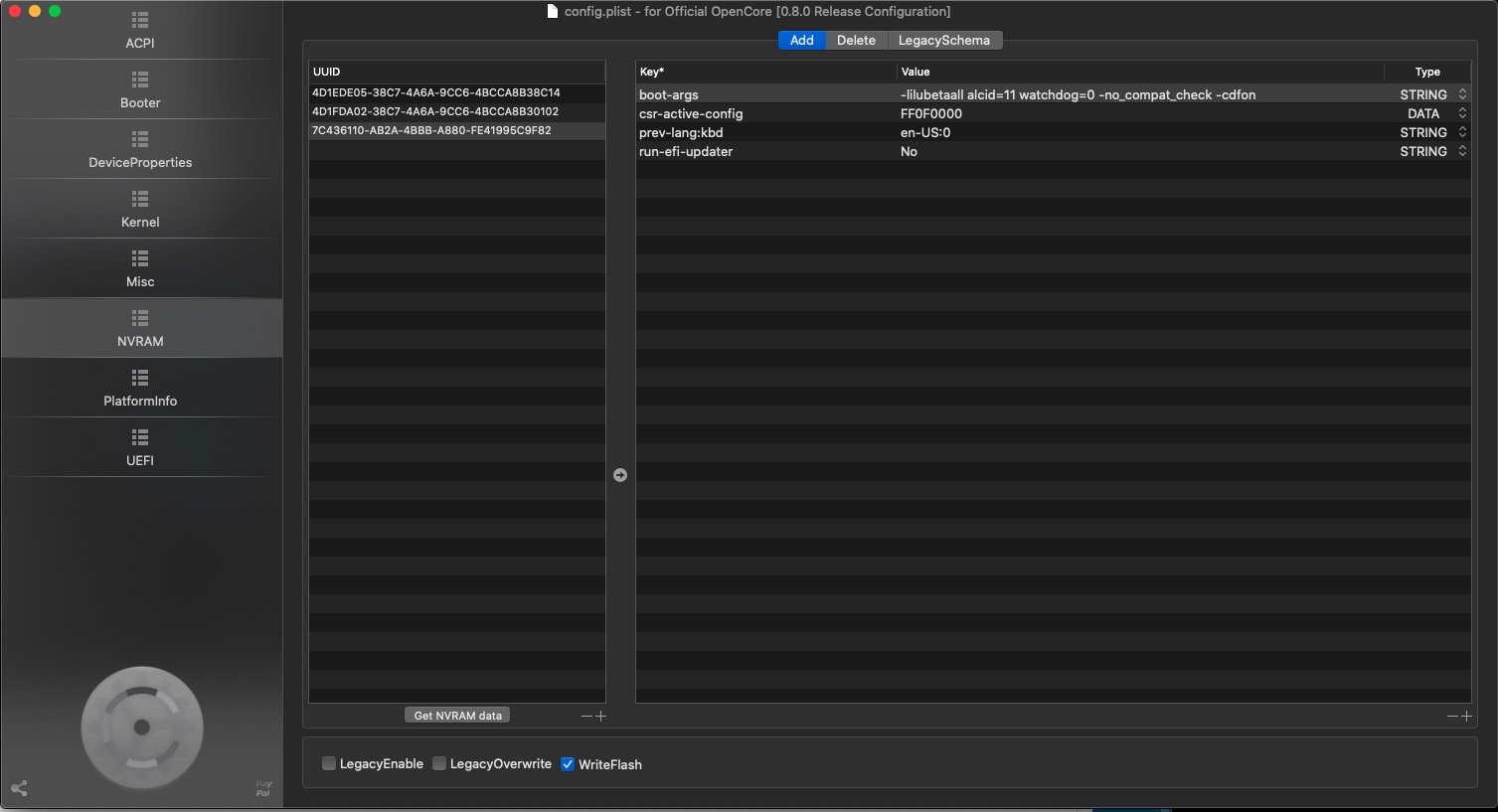

aben Posted June 1, 2022 Share Posted June 1, 2022 (edited) 9 hours ago, ANONIMNIQ said: @aben Now I try BigSur and it works more stable with it. Still some glitches here and there, i.e. missing icons on newly installed apps. Also still don't have 4k resolution for the Display, only 1080p. This is my current EFI with BigSur, no freezes like Monterey: As expected. This goes to prove that current OCLP root-patches deployed to enable compatibility for Haswell-based iGPUs on macOS 12 does not seem to play well with your hardware on current macOS Monterey builds. You'll probably see better stability on initial macOS 12 releases like 12.1; only tests will prove. Again, your current EFI is STILL all-over-the-place with unnecessary OC quirks and kexts being included; why AppleMCEReporterDisabler and RestrictEvents? These kexts are mostly targeted towards AMD users. I assume you have simply copy pasted your AMD rig EFI without much deliberation. Use the below attached EFI; have cleaned out all the useless stuff. As for 4K support, I suggest you try testing with SMBIOS iMac15,1 and/or boot arg -cdfon. More insights here: https://github.com/acidanthera/WhateverGreen/blob/master/Manual/FAQ.IntelHD.en.md EFI.zip Edited June 1, 2022 by aben EFI Link to comment https://www.insanelymac.com/forum/topic/351838-monterey-freeze-with-hd4400/page/3/#findComment-2783363 Share on other sites More sharing options...

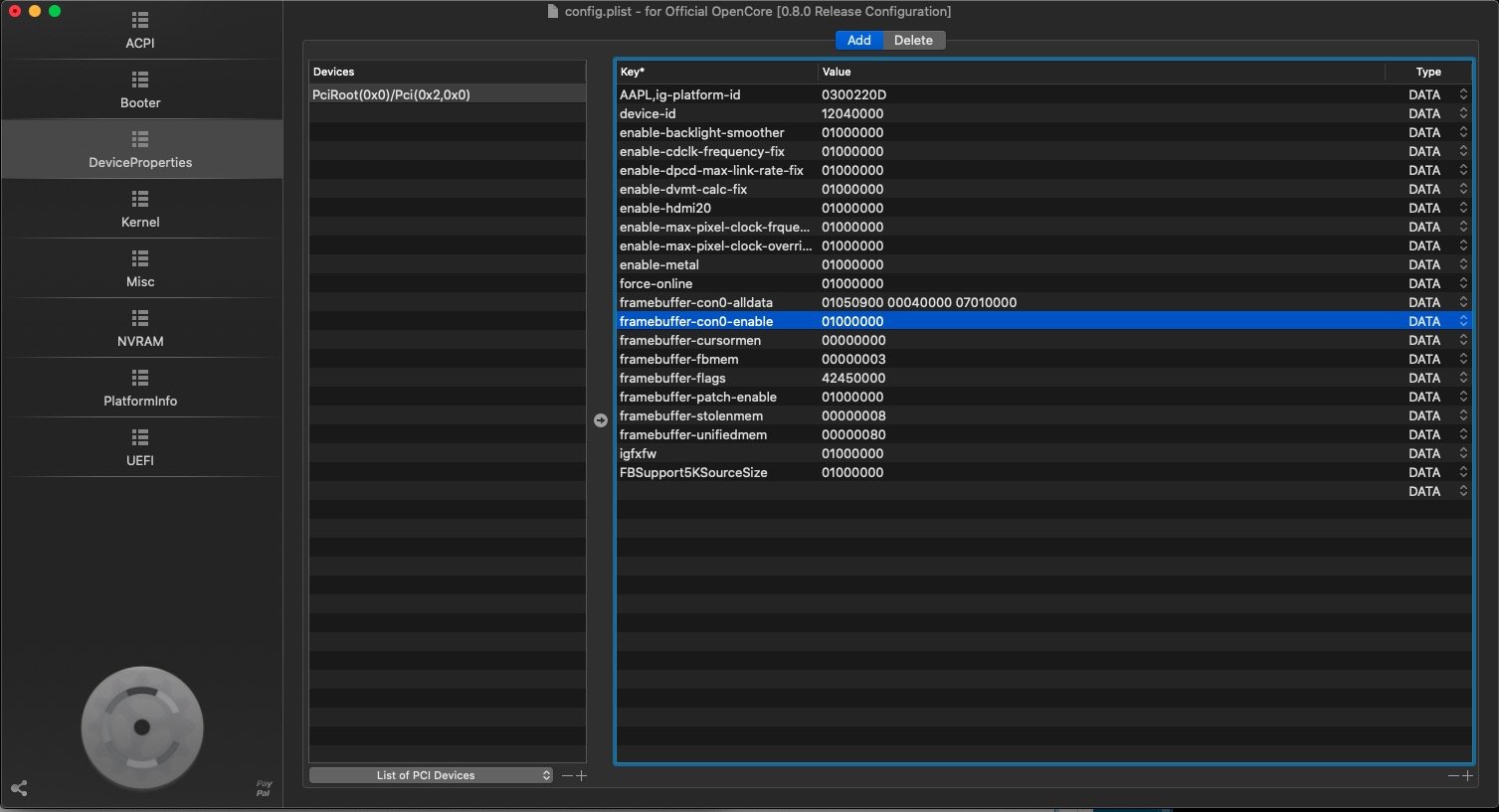

ANONIMNIQ Posted June 1, 2022 Author Share Posted June 1, 2022 @aben thank you! for 4k resolution, nothing happened when I use -cdfon with -igfxmpc works and show 4k resolution, but when I choose it my display loose signal. Maybe it's because I use DP output, I'm not sure how to make it worked. I tried with enable-max-pixel-clock-override but it's the same. Link to comment https://www.insanelymac.com/forum/topic/351838-monterey-freeze-with-hd4400/page/3/#findComment-2783373 Share on other sites More sharing options...
aben Posted June 1, 2022 Share Posted June 1, 2022 29 minutes ago, ANONIMNIQ said: @aben thank you! for 4k resolution, nothing happened when I use -cdfon with -igfxmpc works and show 4k resolution, but when I choose it my display loose signal. Maybe it's because I use DP output, I'm not sure how to make it worked. I tried with enable-max-pixel-clock-override but it's the same. I think your system requires appropriate DVMT memory size allocation for proper 4K output on macOS. You've reported earlier the option to modify this parameter is missing from your BIOS. Methods do exist that helps extract BIOS/UEFI variables which you can then manually modify via GRUB-commands (this approach is considered RISKY and DANGEROUS if you don't know what you're doing albeit could help solve your issue if done correctly). At the moment, I can only help with the below attached EFI-added some basic mem. patches, hopefully it works, if not I suggest you experiment around with the other Azul Framebuffer IDs listed for desktops here or maybe carefully consider the approach of increasing DVMT memory via UEFI shell. EFI.zip 1 Link to comment https://www.insanelymac.com/forum/topic/351838-monterey-freeze-with-hd4400/page/3/#findComment-2783377 Share on other sites More sharing options...

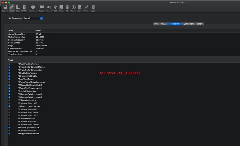

$tealth Posted June 6, 2022 Share Posted June 6, 2022 (edited) @anonimiq Please try these setting on your intel graphics card and bootleg its giving me full 4K support Edited June 6, 2022 by $tealth Link to comment https://www.insanelymac.com/forum/topic/351838-monterey-freeze-with-hd4400/page/3/#findComment-2783692 Share on other sites More sharing options...
ANONIMNIQ Posted June 6, 2022 Author Share Posted June 6, 2022 @$tealth I tried with your settings, bur still can't work. It shows 4K resolution, but when I select it my display loose signal. When I try to add these patches with hackintool even can't boot, shows some errors for display in lilu and whatevergreen. Link to comment https://www.insanelymac.com/forum/topic/351838-monterey-freeze-with-hd4400/page/3/#findComment-2783722 Share on other sites More sharing options...
$tealth Posted June 6, 2022 Share Posted June 6, 2022 I don't know what to do for me it's working for the triple boot computer with macOS Catalina, BigSur and Monterey.... Link to comment https://www.insanelymac.com/forum/topic/351838-monterey-freeze-with-hd4400/page/3/#findComment-2783726 Share on other sites More sharing options...
