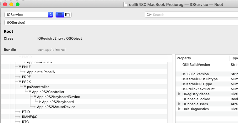

Anyway I think the trackpad is on PS2 bus
The driver is in my signature
