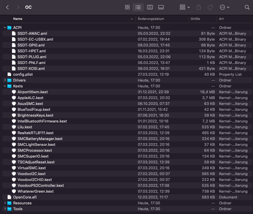

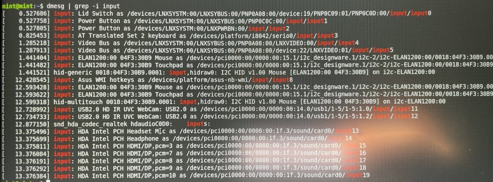

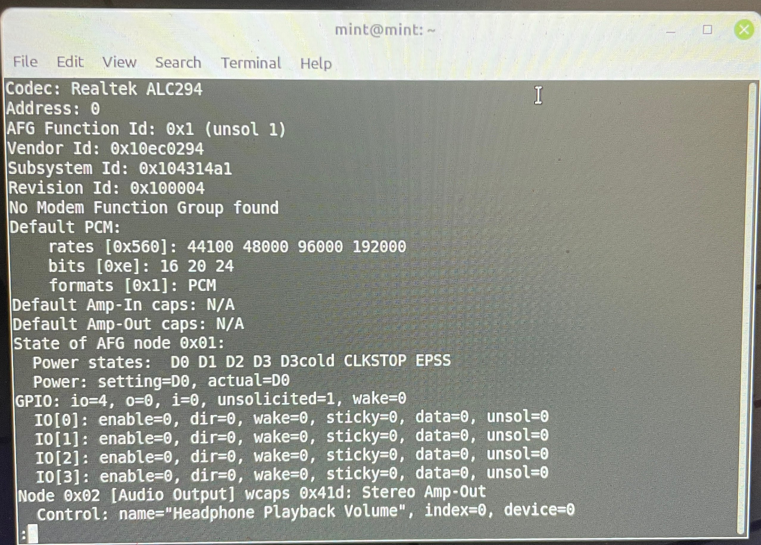

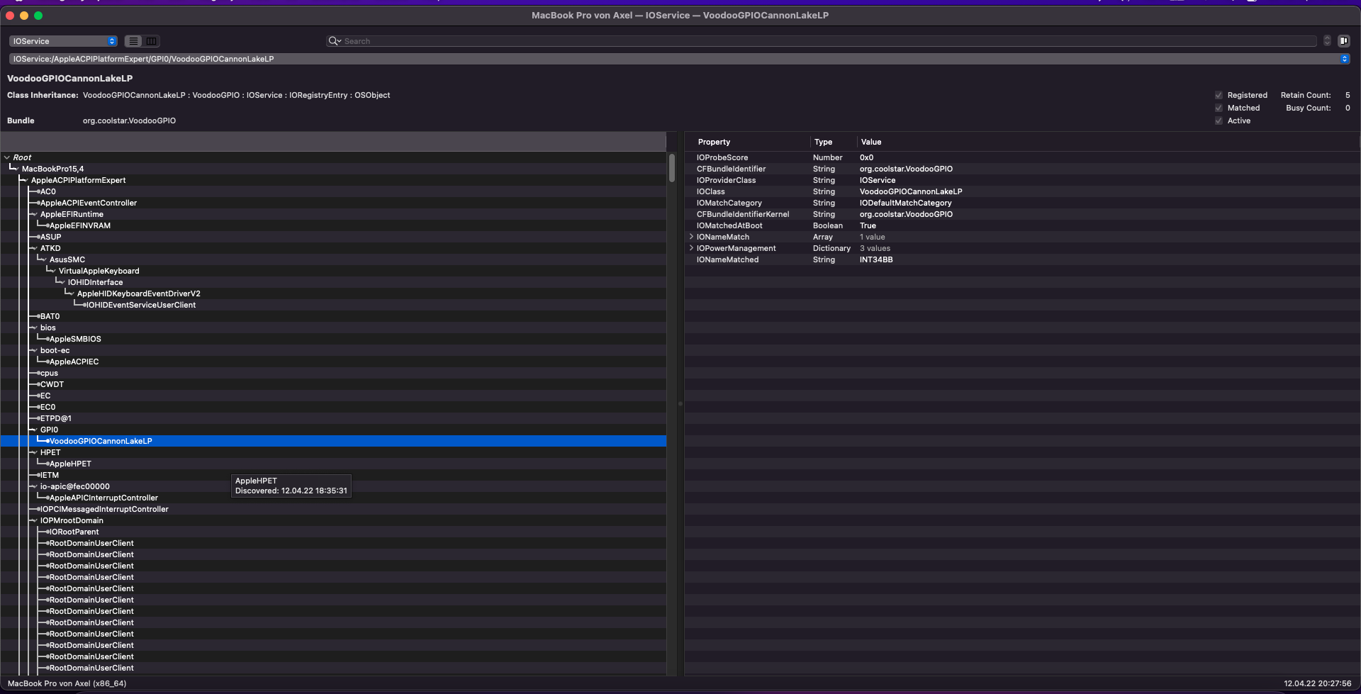

axel2929 Posted April 12, 2022 Share Posted April 12, 2022 (edited) Hey there, I'm new here, so I'm not really sure, where to put this post. If there is a better place, please tell me or move it. To my problem: I'm using Mac OS Monterey with OpenCore 0.7.8. I followed the Dortania Guide, but I can't get my touchpad and sound working. This is what my EFI/OC folder looks like: config.plist can be found in attachments: config.plist Touchpad: In linux live usb I figured out the type of my touchpad: I2C ELAN1200 So I added VoodooI2C, VoodooPS2Controller and VoodooI2CHID kexts, as ELAN1200 needs HID and not ELAN kext. But the touchpad keeps not working. So tried hints at this page: https://dortania.github.io/Getting-Started-With-ACPI/Laptops/trackpad-methods/manual.html#enabling-trackpad VoodooGPIO should be attatched: As written in "_OSI to XOSI" section, I tried to add to precompiled SSDT-XOSI.aml. I'm not sure if I might need to customize the dsl and compile manually, but I just didn't really understand how to edit the SSDT-XOSI.dsl correctly. Also I'm not sure how to follow the instructions in the next section "Create OSYS Variable Under I2C Scope". Audio: Via linux live usb I figured out, which codec i need to look for: ALC 294 I tried all layout-ids that are listed at ALC294: layout 11, 12, 13, 21, 22, 28, 44, 66, 99 But not a single got the audio working. The weird thing is, that sometimes it worked after a reboot from windows (I'm using dualboot with Windows 11), but never after a normal start. In IORegistryExplorer the audio controller is attached My specs: Laptop: ASUS ZenBook UX533FD CPU: Intel i5-8265U 1,6 GHz Whiskey Lake GPU: GTX 1050 (deactivated), Intel UHD Graphics 620 Does anyone know what I could try? I'd be very thankful for tips! Edited April 12, 2022 by axel2929 Quote Link to comment https://www.insanelymac.com/forum/topic/351430-opencore-touchpad-and-audio-not-working-asus-zenbook-macos-monterey/ Share on other sites More sharing options...

axel2929 Posted April 15, 2022 Author Share Posted April 15, 2022 First of all, thank you for your response! On 4/13/2022 at 12:20 AM, 5T33Z0 said: are you sure VoodooInput has to be disabled? I supposed that not 2 VoodooInput kexts could be enabled, as ProperTree only enables one automatically and both VoodooI2C and VoodooPS2Controller got a VoodooInput plugin. Nonetheless I tried to set both VoodooInput kexts enabled, but as expected OpenCore didn't start. After that I tried to disable the one of VoodooPS2Controller and activate the one of VoodooI2C. But It didn't work. On 4/13/2022 at 12:20 AM, 5T33Z0 said: Maybe this helps: https://github.com/5T33Z0/OC-Little-Translated/tree/main/05_Laptop-specific_Patches/Trackpad_Patches I will try this and report my results, thank you for the advice. Quote Link to comment https://www.insanelymac.com/forum/topic/351430-opencore-touchpad-and-audio-not-working-asus-zenbook-macos-monterey/#findComment-2780277 Share on other sites More sharing options...
