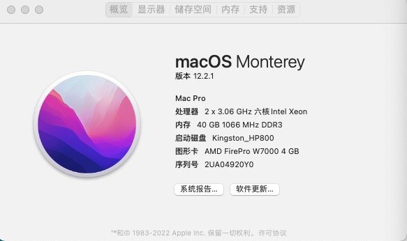

Feng QUan Posted March 11, 2022 Share Posted March 11, 2022 (edited) Hello my friend. My machine is HP Z800, configured as X5675*2 /Firepro W7000. I refer to the information of some experts in this forum, especially @mfifer's excellent work, and successfully made my own EFI file. However, the problem is that the machine cannot be shut down properly and I have to manually shut down. I tried to MAPPING USB, or directly modify DSDT, but it didn't work either. What I want to ask is, has anyone been able to solve this problem? I am attaching my own EFI file. This EFI can successfully boot Monterey. During the installation, I finished installing Monterey in my other HP Z840 and then transferred the SSD to the HP Z800 machine. Then, boot and work perfectly with this EFI. Another known issue is that when the machine is powered on, I plug in my USB keyboard and it doesn't work. The machine doesn't even recognize this keyboard. I hope you guys can solve this problem. I test for several times, the shutdown problem seems to be solved. However, the "restart" problem appears. When I restart my HP Z800, the whole computer seems lost response with a black screen . EFI.zip Edited March 11, 2022 by Feng QUan 1 Quote Link to comment Share on other sites More sharing options...

mfifer Posted April 7, 2022 Share Posted April 7, 2022 (edited) I mentioned in a related thread, that I had time to review the OC docs and I fixed my reboot-not-working issue by making this change to my config.plist in the Quirks section (change false to true): <key>FadtEnableReset</key> <true/> See if that change helps your restart challenges... -=- mf On 3/10/2022 at 8:33 PM, Feng QUan said: Hello my friend. My machine is HP Z800, configured as X5675*2 /Firepro W7000. I refer to the information of some experts in this forum, especially @mfifer's excellent work, and successfully made my own EFI file. However, the problem is that the machine cannot be shut down properly and I have to manually shut down. I tried to MAPPING USB, or directly modify DSDT, but it didn't work either. What I want to ask is, has anyone been able to solve this problem? I am attaching my own EFI file. This EFI can successfully boot Monterey. During the installation, I finished installing Monterey in my other HP Z840 and then transferred the SSD to the HP Z800 machine. Then, boot and work perfectly with this EFI. Another known issue is that when the machine is powered on, I plug in my USB keyboard and it doesn't work. The machine doesn't even recognize this keyboard. I hope you guys can solve this problem. I test for several times, the shutdown problem seems to be solved. However, the "restart" problem appears. When I restart my HP Z800, the whole computer seems lost response with a black screen . Edited April 7, 2022 by mfifer 1 Quote Link to comment Share on other sites More sharing options...

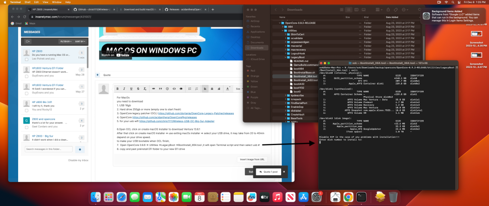

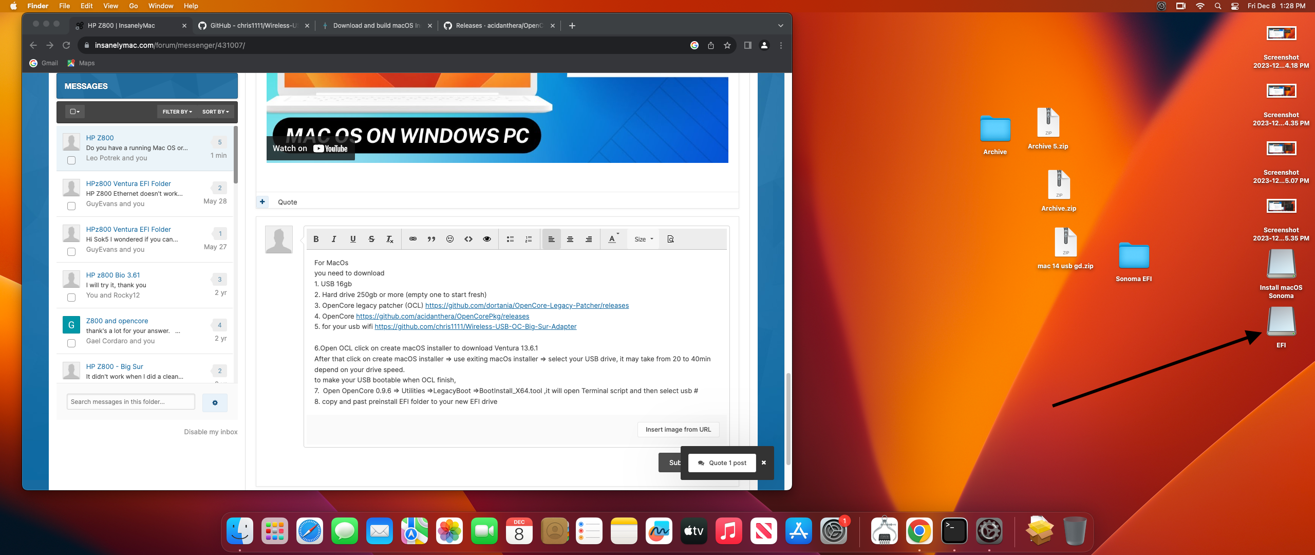

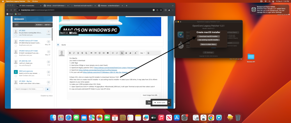

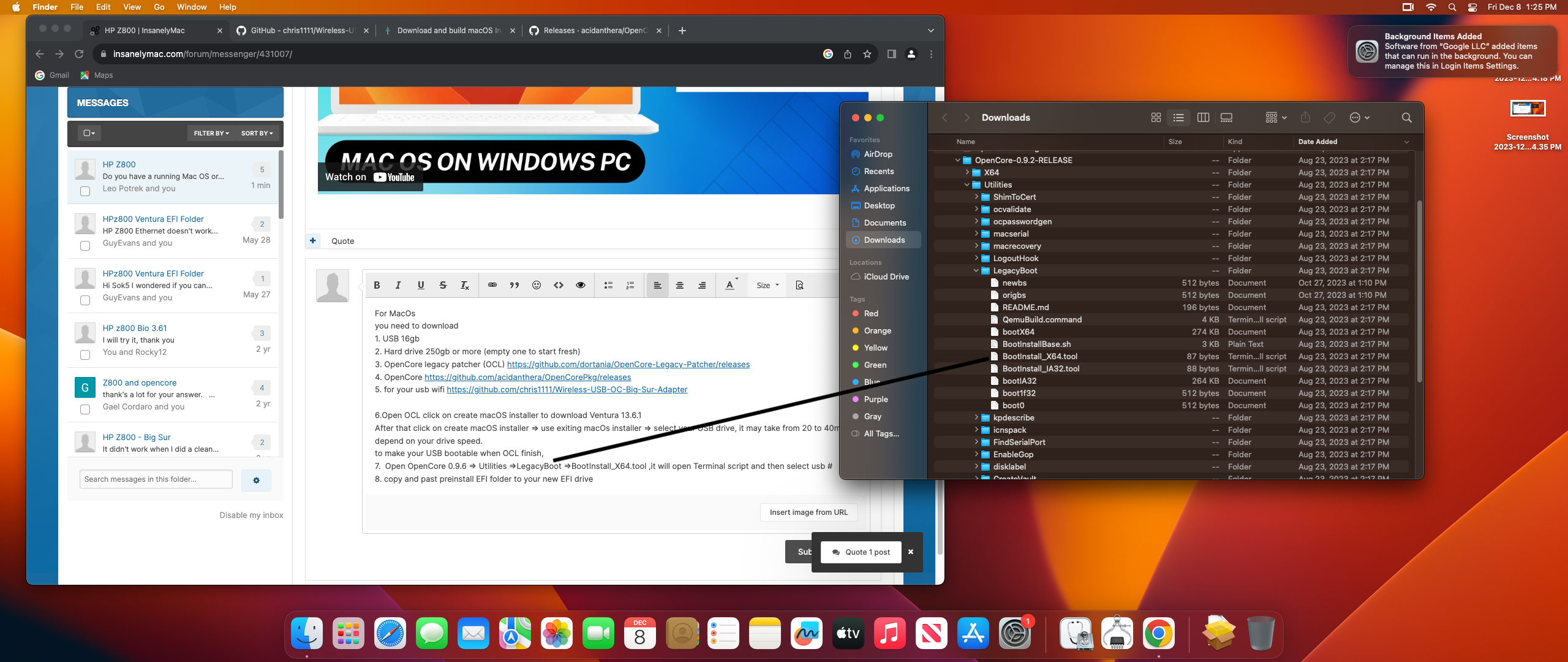

sok5 Posted December 8, 2023 Share Posted December 8, 2023 For MacOs you need to download 1. USB 16gb 2. Hard drive 250gb or more (empty one to start fresh) 3. OpenCore legacy patcher (OCL) https://github.com/dortania/OpenCore-Legacy-Patcher/releases 4. OpenCore https://github.com/acidanthera/OpenCorePkg/releases 5. for your usb wifi https://github.com/chris1111/Wireless-USB-OC-Big-Sur-Adapter 6.Open OCL click on create macOS installer to download Ventura 13.6.1 it's easy then Sonoma After that click on create macOS installer => use exiting macOs installer => select your USB drive, it may take from 20 to 40min depend on your drive speed. to make your USB bootable when OCL finish, 7. Open OpenCore 0.9.6 => Utilities =>LegacyBoot =>BootInstall_X64.tool ,it will open Terminal script and then select usb # 8. copy and past preinstall EFI folder to your new EFI drive 9. remove all the hard drive except one you want to install. 10. Bio setup to boot from UBS 11. boot your usb installer => when it boot up => Disk utility => format APFS (GUID partition) exit and instill OS after installation finish, it'll reboot several time to complete the final operating system. 12. used step # 7 to make your hard drive bootable without USB drive. 10. copy and past post installation EFI Quote Link to comment Share on other sites More sharing options...
sok5 Posted December 8, 2023 Share Posted December 8, 2023 pre install EFI.zippost install EFI.zip 1 Quote Link to comment Share on other sites More sharing options...
