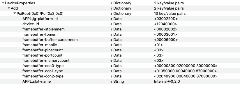

makk Posted October 4, 2021 Share Posted October 4, 2021 4 hours ago, Ipotex said: kernellog.txt https://drive.google.com/file/d/1FvFaP_AAoWYPtmLpz9hYLeazgoTpBT9P/view?usp=sharing acpilog.txt https://drive.google.com/file/d/1Hxy_MbESwSNH0wJAui8PjvoeO3AGQDOJ/view?usp=sharing Intel HD Graphics 4600: Chipset Model: Intel HD Graphics 4600 Type: GPU Bus: Built-In VRAM (Dynamic, Max): 1536 MB Vendor: Intel Device ID: 0x0412 Revision ID: 0x0006 Metal: Supported, feature set macOS GPUFamily1 v4 Displays: D2342P: Resolution: 1920 x 1080 (1080p FHD - Full High Definition) UI Looks like: 1920 x 1080 @ 60 Hz Framebuffer Depth: 24-Bit Color (ARGB8888) Display Serial Number: SerialNumber Main Display: Yes Mirror: Off Online: Yes Automatically Adjust Brightness: No Connection Type: Internal Thanks for the update. So you have a external plugged into the DVI port or HDMI port? Under your DeviceProperties in OC Find this one: PciRoot(0x0)/Pci(0x2,0x0) < Graphics chip video Looks like for Desktop: ig-platform-id, Desktop: 0x0D220003 (default) 03 22 0D 00 < in reverse 0300220D device_id, 220D0000 take a look at the Sample.plist for this above WEG/FAQ.Intel.en.md <> page https://github.com/acidanthera/WhateverGreen/blob/master/Manual/FAQ.IntelHD.en.md Sample.plist Link to comment Share on other sites More sharing options...
makk Posted October 4, 2021 Share Posted October 4, 2021 Framebuffer, Device ID info from Whatevergreen page: ID: 0D220003, STOLEN: 32 MB, FBMEM: 19 MB, VRAM: 1536 MB, Flags: 0x00000402 TOTAL STOLEN: 52 MB, TOTAL CURSOR: 1 MB (1572864 bytes), MAX STOLEN: 116 MB, MAX OVERALL: 117 MB (123219968 bytes) Camellia: CamelliaDisabled (0), Freq: 5273 Hz, FreqMax: 5273 Hz Mobile: 0, PipeCount: 3, PortCount: 3, FBMemoryCount: 3 [1] busId: 0x05, pipe: 9, type: 0x00000400, flags: 0x00000087 - ConnectorDP [2] busId: 0x04, pipe: 10, type: 0x00000400, flags: 0x00000087 - ConnectorDP [3] busId: 0x06, pipe: 8, type: 0x00000400, flags: 0x00000011 - ConnectorDP 01050900 00040000 87000000 02040A00 00040000 87000000 03060800 00040000 11000000 Link to comment Share on other sites More sharing options...
makk Posted October 4, 2021 Share Posted October 4, 2021 (edited) Example: framebuffer-stolenmem | data | 00002002 framefuffer-fbmem | data | 00005001 framebuffer-buffer-cursormem | data | 00006000 IF YOU GET GLITCHES and Strangeness Setting ( A bit more umph ) 000002002 -> 34MB stolen mem (framebuffer-stolenmem) // Rehabman's DVMT-prealloc requirement 00005001 -> 21MB FB mem (framebuffer-fbmem) // Rehabman's framebuffer size 00006000 -> 6MB Cursor mem (framebuffer-cursormem) RECOMMENDED SETTING: 00000002 -> 32MB stolen mem (framebuffer-stolenmem) // Rehabman's DVMT-prealloc requirement 00003001 -> 19MB FB mem (framebuffer-fbmem) // Rehabman's framebuffer size 00006000 -> 6MB Cursor mem (framebuffer-cursormem) // Rehabman's cursor bytes SET the Dedicated Memory DVMT Pre-allocated memory to 64 in BIOS after entering data into config.plist>DeviceProperties>xxx (0x2)(0x0) registers for graphics Edited October 4, 2021 by makk Link to comment Share on other sites More sharing options...
makk Posted October 4, 2021 Share Posted October 4, 2021 0300220D -> layout id (AAPL,ig-platform-id) 01 -> mobile type (framebuffer-mobile) 03 -> 3 x pipes (framebuffer-pipecount) 03 -> 3 x ports (framebuffer-portcount) 03 -> 3 x memories (framebuffer-memorycount) 00000002 -> 32MB stolen mem (framebuffer-stolenmem) // Rehabman's DVMT-prealloc requiremen 00003001 -> 19MB FB mem (framebuffer-fbmem) // Rehabman's framebuffer size 00006000 -> 6MB Cursor mem (framebuffer-cursormem) // Rehabman's cursor bytes 00000060 -> 1536MB VRAM (framebuffer-unifiedmem) D90A0000 -> Backlight freq 2777MHz D90A0000 -> Max. backlight freq 2777MHz 00000000 00000000 00000800 02000000 30000000 -> port #1/FB@0: index 00, busid 00, pipe 0800, type 02000000=LVDS/eDP (framebuffer-con0-type), flags 30020000 01050900 00040000 87000000 -> port #2/FB@1: index 01, busid 05, pipe 0900, type 00040000=DP (framebuffer-con1-type), flags 87000000 02040900 00040000 87000000 -> port #3/FB@2: index 02, busid 04, pipe 0900, type 00040000=DP (framebuffer-con2-type), flags 87000000 To get a bit more fancy and detailed for your graphics set these using the WEG FAQ Intel Index page. https://github.com/acidanthera/WhateverGreen/blob/master/Manual/FAQ.IntelHD.en.md Link to comment Share on other sites More sharing options...
Ipotex Posted October 4, 2021 Author Share Posted October 4, 2021 10 hours ago, makk said: So you have a external plugged into the DVI port or HDMI port? HDMI device_id, 220D0000. : I guess my device_id is 12040000, 0x0412 . I tried with both, same issue. I attached my current configuration. Same issue. Link to comment Share on other sites More sharing options...
