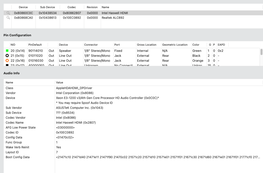

Hi folks,
Any idea about how to know what is doing 74% work on first core?  another one is working ok.    It's a core i3-4360 iGPU 4600
kernel_task is 74% of work all the time.
I tried -x

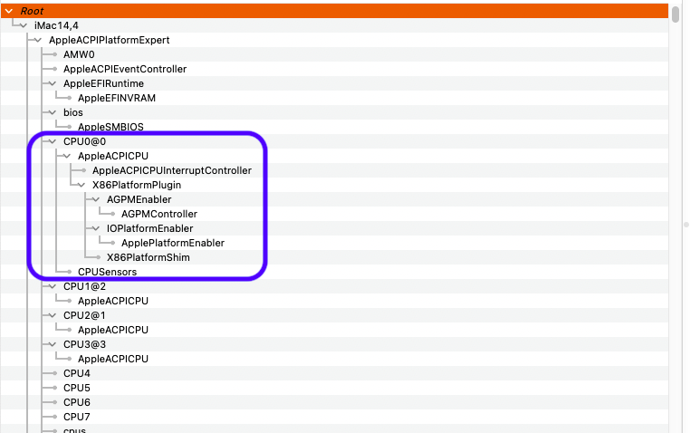

I looking for iMac14,4. inside ACPI_SMC_PlatformPlugin but its not there.
any clue? Thanks

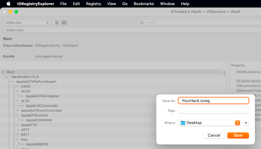

Thank you for your reply.
Big Sur 11.5.2 / Asus Z97-E USB 3.1 / 8Gb DDR3 / Core i3-4360 3.7Ghz / IGPU 4600 / iMac14,4
OpenCore 7.3.  -  Same issue with 7.2.
Last .kexts.  LiLu,Green, and more
I attached config.plist, I removed MLB,ROM,SystemSerialNumber and SystemUUID before upload.
Thank you!

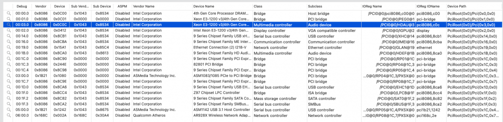

Do you have any devices causing a lot of interrupts possibly? Should be able to see interrupts and other details if you do `sudo powermetrics --show-process-energy` in terminal.
Thank you for your reply.   This is the result of power metrics
unable to get battery node
unable to get backlight node
unable to get smc values

****  Interrupt distribution ****
CPU 0:
	Vector 0x49(iMac14,4): 25378.74 interrupts/sec
	Vector 0x53(RP04/PXSX/RP08/PXSX/SAT0): 18.72 interrupts/sec
	Vector 0x57(EHC1): 0.99 interrupts/sec
	Vector 0x70(IGPU): 6.31 interrupts/sec
	Vector 0x72(XHC): 49.85 interrupts/sec
	Vector 0x75(HDEF): 0.99 interrupts/sec
	Vector 0x77(PXSX): 0.59 interrupts/sec
	Vector 0xdd(TMR): 21.67 interrupts/sec
	Vector 0xde(IPI): 639.59 interrupts/sec

15 minutes ago, Allan said:
Now the power management is correct! Look
so, power management is not the problem. Another clue? Thank you.

Hi, thank you for your reply.  I uploaded IOREG and EFI folder.
I have been removed some kexts from EFI kext directory because size of .zip more than 10 mb. But all kexts enable on config.plist are on kexts folder in original EFI.
EFI.zip
iMac.ioreg.zip

Is this ok for a Core i3 4360 3.7GHz?
+-o CPU0@0  <class IOACPIPlatformDevice, id 0x10000011a, registered, matched, a$
  |   "processor-lapic" = 0x0
  |   "clock-frequency" = <008589dc>
  |   "processor-number" = 0x0
  |   "timebase-frequency" = <00ca9a3b>
  |   "processor-id" = 0x1
  |   "bus-frequency" = <0084d717>
  |   "plugin-type" = 0x1
  |   "cpu-type" = <0509>
  |   "device_type" = <70726f636573736f7200>
  |   "name" = <4350553000>
  |   "processor-index" = 0x0
  +-o AppleACPICPU  <class AppleACPICPU, id 0x100000123, registered, matched, a$
  | +-o AppleACPICPUInterruptController  <class AppleACPICPUInterruptController$
  | +-o X86PlatformPlugin  <class X86PlatformPlugin, id 0x1000003fa, registered$
  |   +-o IOPlatformEnabler  <class IOPlatformPluginDevice, id 0x10000046d, reg$
  |   | +-o ApplePlatformEnabler  <class ApplePlatformEnabler, id 0x100000472, $
  |   +-o AGPMEnabler  <class IOPlatformPluginDevice, id 0x10000046e, registere$
  |   | +-o AGPMController  <class AGPMController, id 0x100000473, !registered,$
  |   +-o X86PlatformShim  <class X86PlatformShim, id 0x100000470, !registered,$
  +-o SMCProcessor  <class SMCProcessor, id 0x100000124, !registered, !matched,$
@Ipotex You're using CPUFriend.kext without a corresponding data kext.  I don't use CPUFriend, but is that correct?  Try disabling CPUFriend in your config.plist, as my experience is that you don't need it if your SMBIOS is correct.
