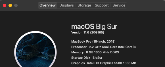

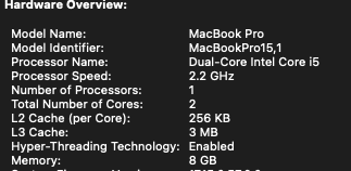

makk Posted September 29, 2021 Share Posted September 29, 2021 (edited) 19 hours ago, Ipotex said: iMac13,3 doesnt support BigSur I guess. I tried with 14,4 , 15,1 and 16,1 I'll go back to Catalina using same EFI and test if it's a problem only with BigSur I just tested MacBookPro15,1 works great, try that one Use CLover Configurator just to get the model then save to desktop as config.plist with nothing but SMBIOS need also to make up a ROM. 00:24:d2:b3:86:84 < random MAC address minus these > : < colon Don't use configurator for noraml OC config.plist it leaves out things and wipes certain things out. Use Xcode or Proper Tree or similar Edited September 29, 2021 by makk Link to comment https://www.insanelymac.com/forum/topic/348831-high-cpu-74-kernel_task-is-crazy/page/2/#findComment-2767885 Share on other sites More sharing options...

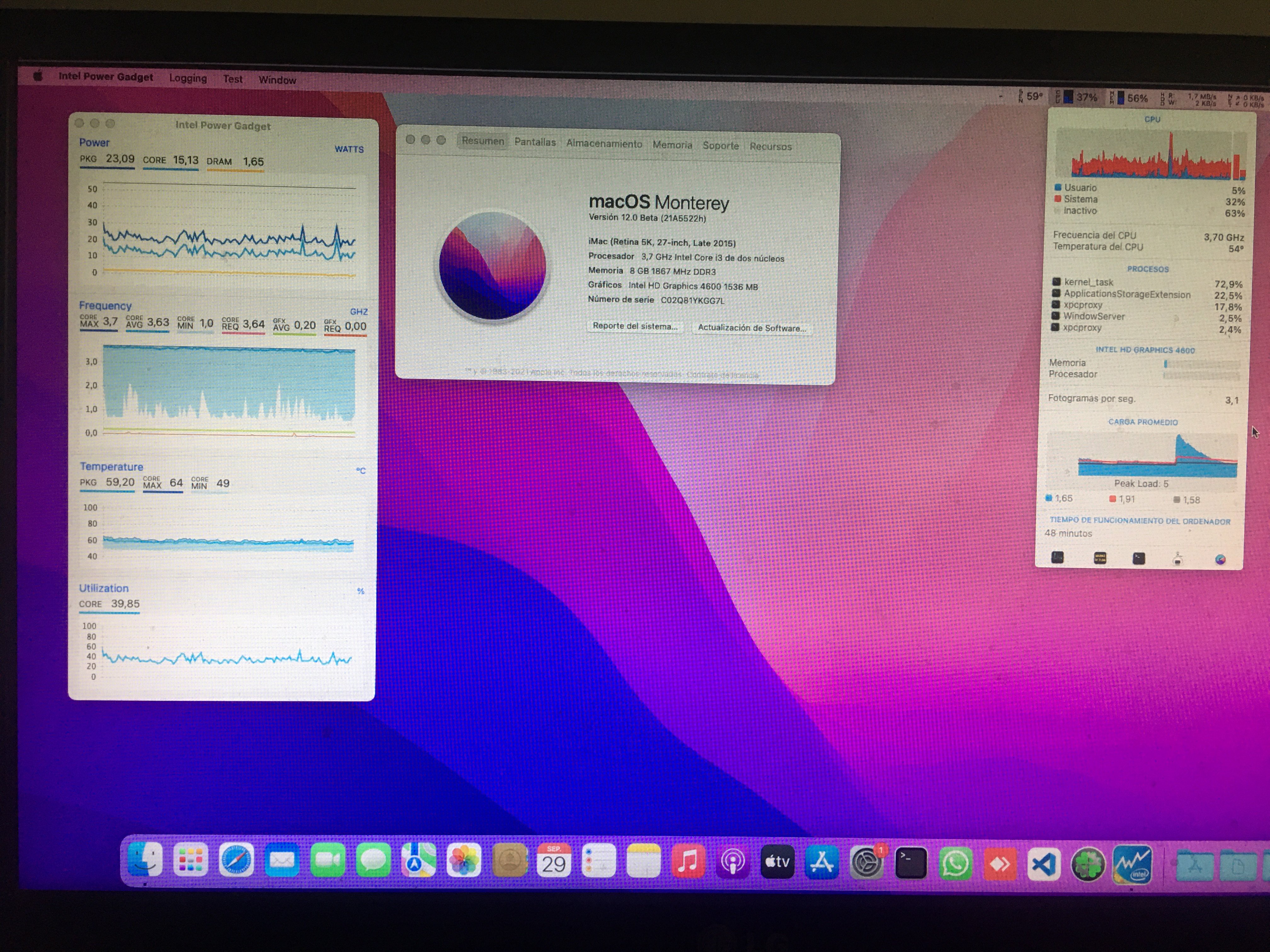

Ipotex Posted September 29, 2021 Author Share Posted September 29, 2021 Hi guys, I tried a lot of smbios configurations all do same issue. I have been updated to Monterey… same issue 😱 Only diff intel power app works. On Bigsur it doesnt. In picture you can see kernel_task high usage. Link to comment https://www.insanelymac.com/forum/topic/348831-high-cpu-74-kernel_task-is-crazy/page/2/#findComment-2767911 Share on other sites More sharing options...

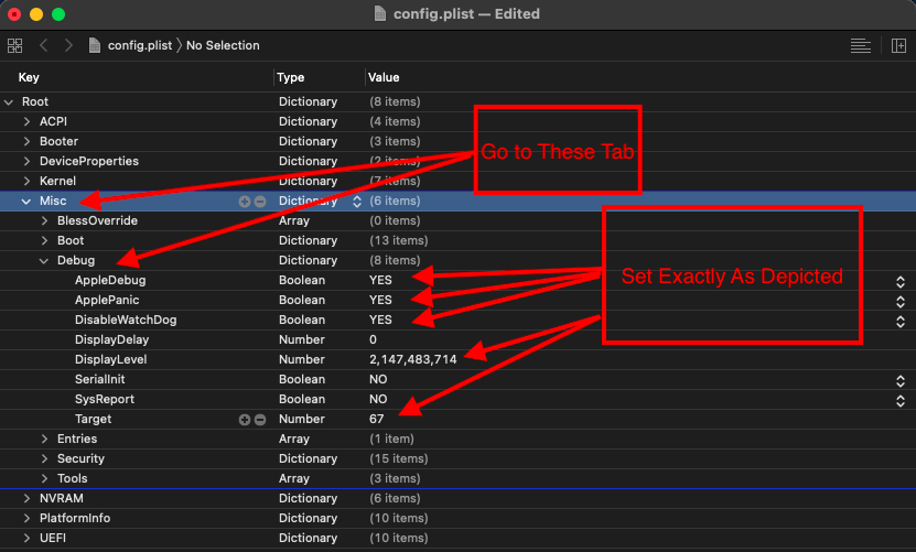

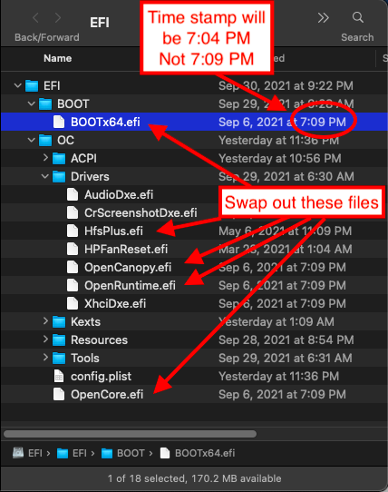

makk Posted October 3, 2021 Share Posted October 3, 2021 Having Opencore in Debug mode Download OC 73 Debug, not the Release Copy the files there to EFI Take a look at the screen shots and match them one for one exactly Or you can go here: Opencore Debug: https://dortania.github.io/OpenCore-Install-Guide/troubleshooting/debug.html#file-swaps Set debug to 83 Misc -> Debug -> Target -> 83 Link to comment https://www.insanelymac.com/forum/topic/348831-high-cpu-74-kernel_task-is-crazy/page/2/#findComment-2768238 Share on other sites More sharing options...
