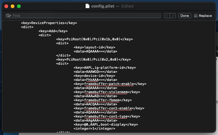

Francesco Guagnano Posted August 25, 2021 Author Share Posted August 25, 2021 I tried to inject <key>@0,AAPL,boot-display</key> <integer>1</integer> in my config.plist under DeviceProperties -> Add -> PciRoot(0x0)/Pci(0x2,0x0) but it cannot override. In fact checking in IOReg the situation is the same. Quote Link to comment https://www.insanelymac.com/forum/topic/348676-laptop-built-in-display-black-screen-when-hdmi-plugged-in/#findComment-2765269 Share on other sites More sharing options...

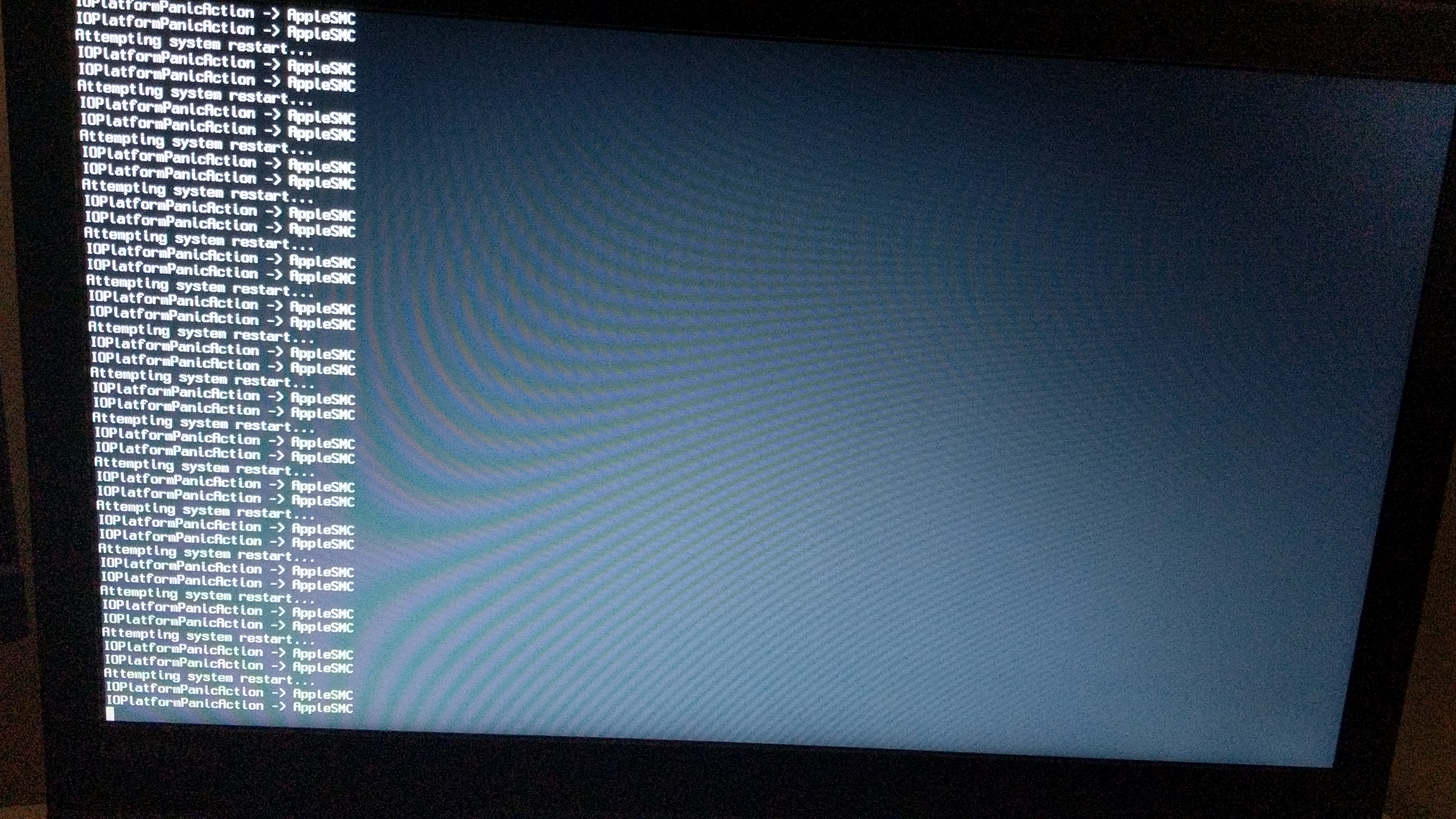

Francesco Guagnano Posted August 26, 2021 Author Share Posted August 26, 2021 (edited) After NVRAM reset the system does not start! I also revert my config.plist at original one. Help help help!!! Edited August 26, 2021 by Francesco Guagnano Quote Link to comment https://www.insanelymac.com/forum/topic/348676-laptop-built-in-display-black-screen-when-hdmi-plugged-in/#findComment-2765280 Share on other sites More sharing options...

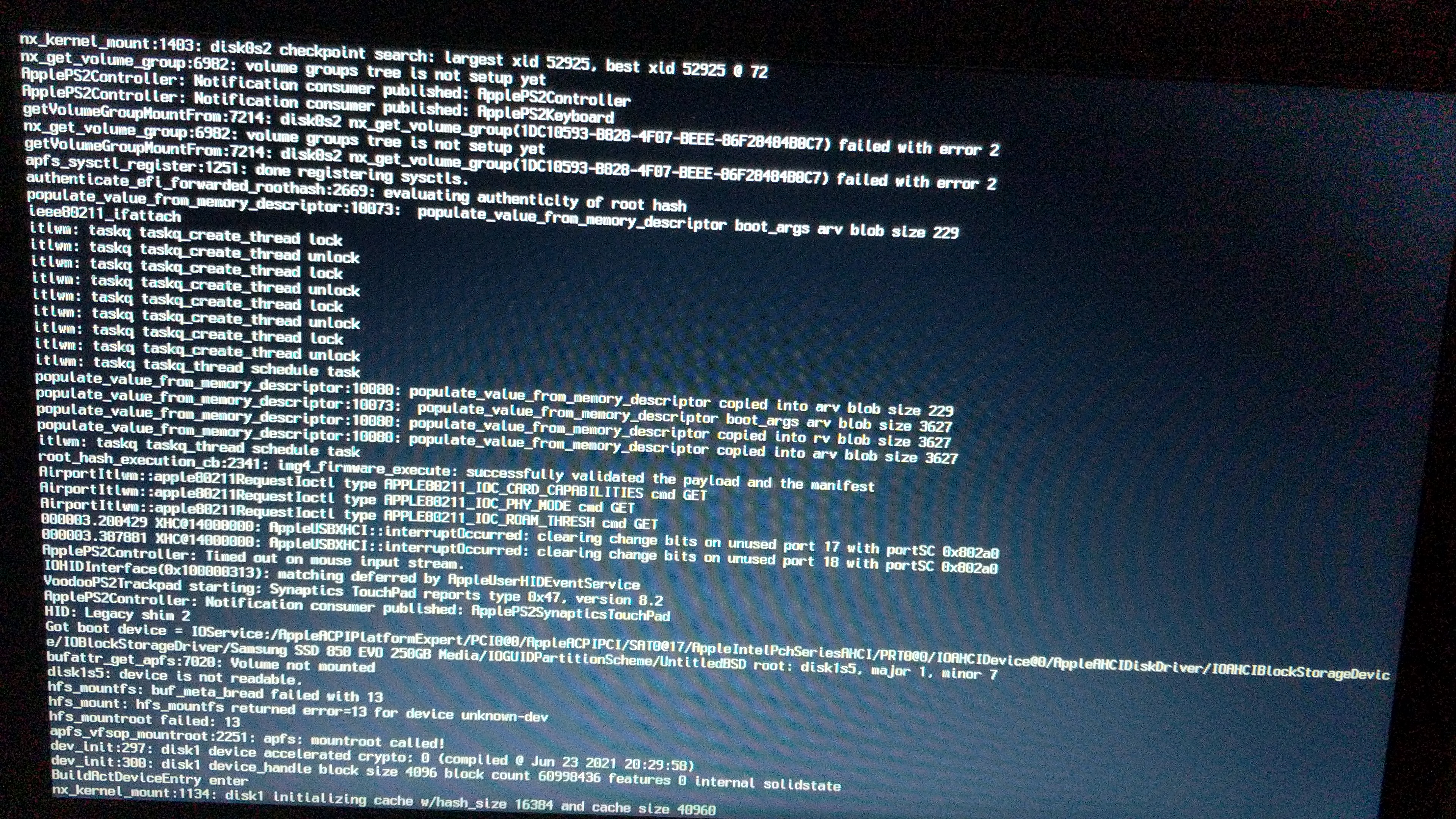

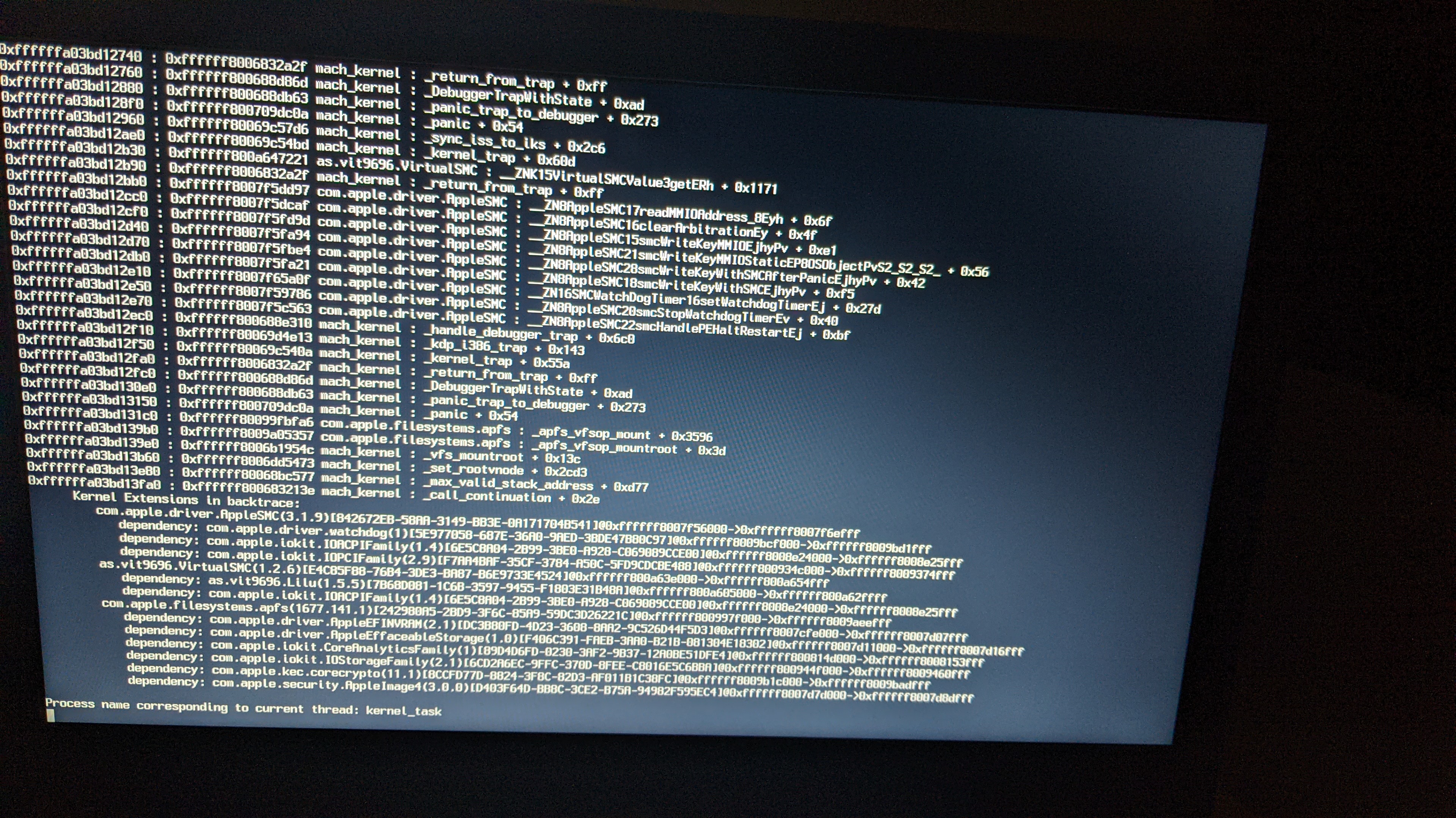

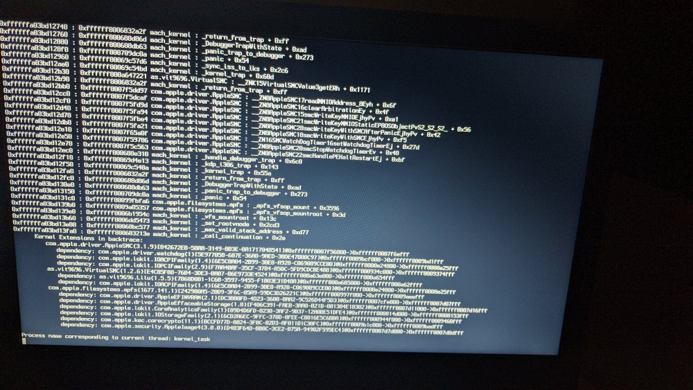

Francesco Guagnano Posted August 26, 2021 Author Share Posted August 26, 2021 After reset NVRAM multiple times I also have this Quote Link to comment https://www.insanelymac.com/forum/topic/348676-laptop-built-in-display-black-screen-when-hdmi-plugged-in/#findComment-2765289 Share on other sites More sharing options...
Francesco Guagnano Posted August 26, 2021 Author Share Posted August 26, 2021 Disabling the ISP with command csrutil disable from terminal in Recovery the system starts! Quote Link to comment https://www.insanelymac.com/forum/topic/348676-laptop-built-in-display-black-screen-when-hdmi-plugged-in/#findComment-2765295 Share on other sites More sharing options...

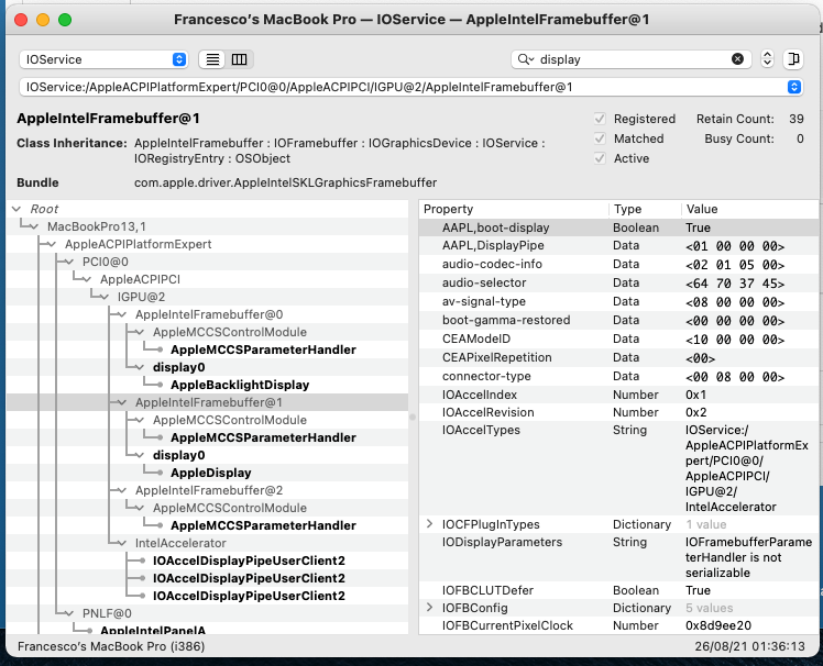

Francesco Guagnano Posted August 26, 2021 Author Share Posted August 26, 2021 I have alrady enabled the SIP and all work as before. I also drag the white Finder’s bar to the built-in screen and so in IOReg the built-in becomes the boot display but after system rebooting the situation not change because the built-in screen is black and if I go in IOReg I see that the boot display is the external monitor. So at reboot the system overrides the boot display with the external one. Quote Link to comment https://www.insanelymac.com/forum/topic/348676-laptop-built-in-display-black-screen-when-hdmi-plugged-in/#findComment-2765296 Share on other sites More sharing options...
